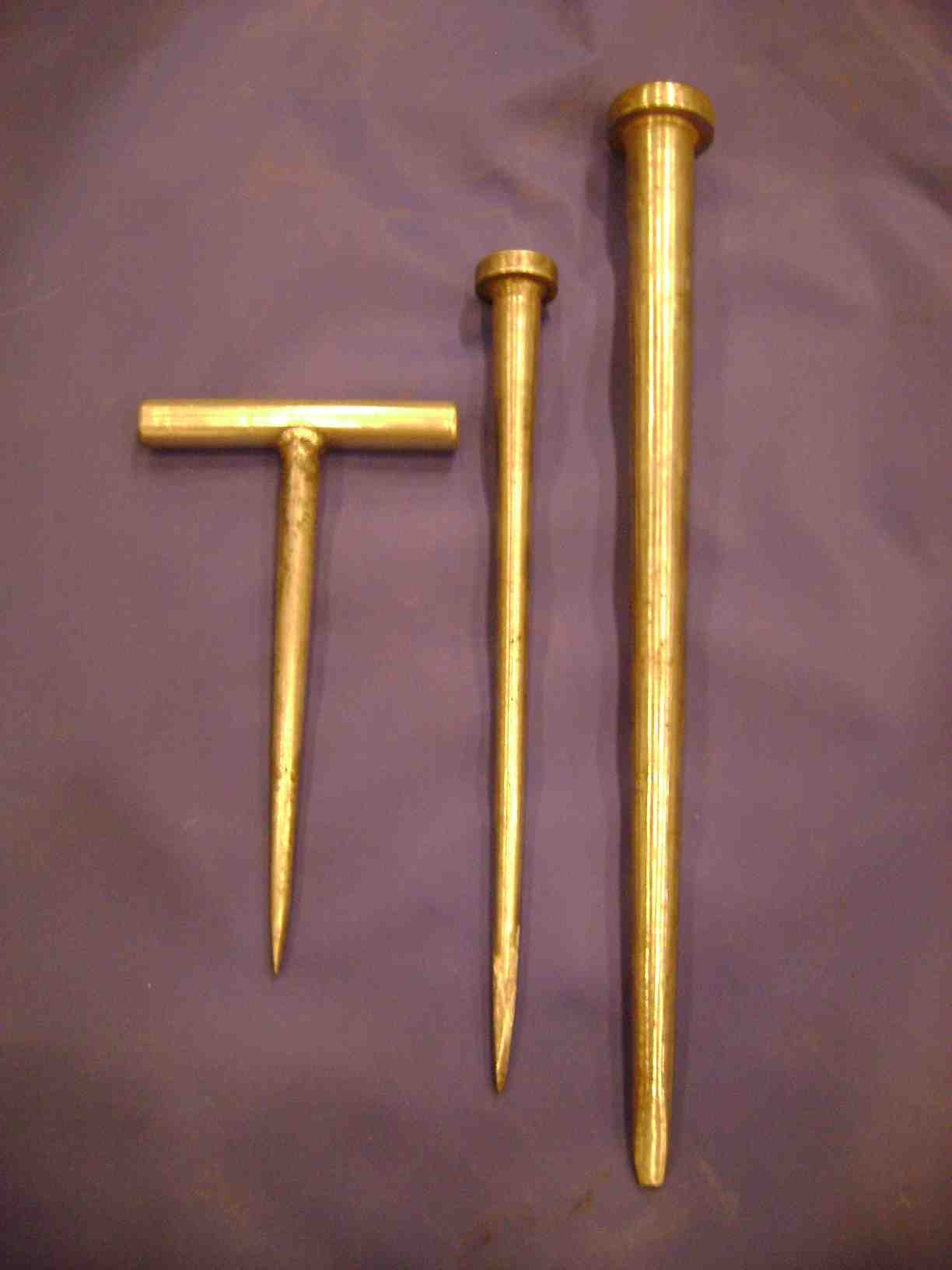

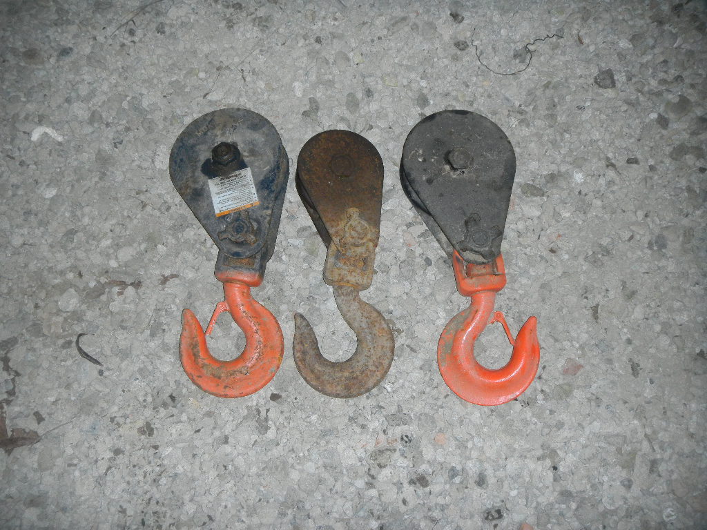

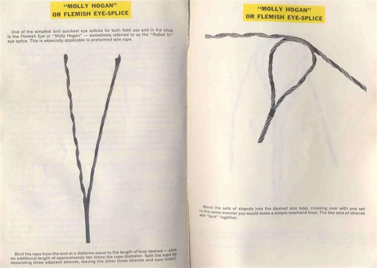

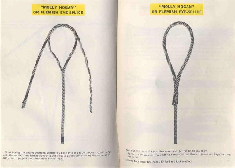

Sounds like you need to buy some 3/8" or 1/2" wire rope. Roll some eyes in each end, and buy a few snatch blocks. Then use some creative rigging!:laughing: It's been years since I put in a logger's splice. The company I use to work for put a stop to us making our own rigging out on the derricks. Anchor wires were OK, but not for overhead lifting.

Thanks SA... most of the stuff is not very big (you know the stuff I am sure). I have some short wire rope but will add to my collection. Maybe I will make my own ends this time!

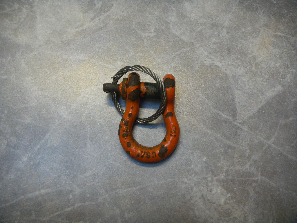

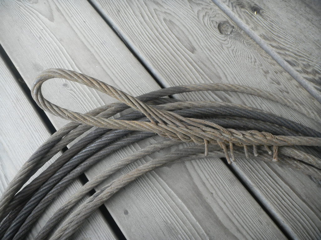

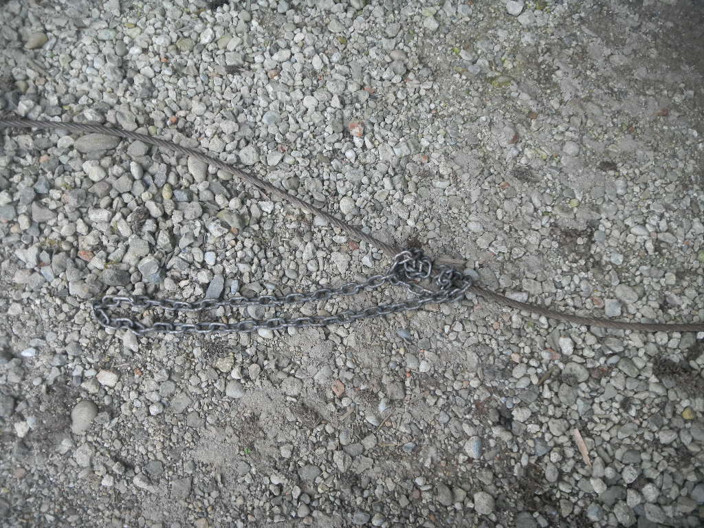

If you roll the eyes, make an extra long tail past the eye, and use electrical tape instead of wire rope clamps. When we stacked the anchors for the replacement LVM floating bridge in Lake Washington. The first section set on the lake bottom we rolled eyes in wire rope with electrical tape. Instead of using a shackle we cut one strand out of the wire rope, and rolled a molly. We used these wire ropes for the next section of anchor to follow down on top the the previous section. When all five sections were set, we used endless chains wrapped around the wire rope, and backed the barge up to break the molly. That never happened! We always broke the wire rope!

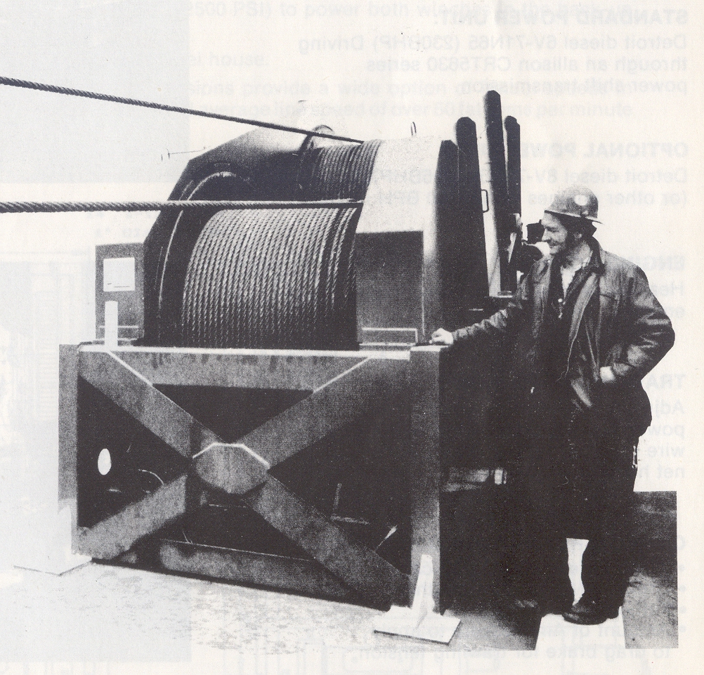

If dragoneggs Harbor Freight winch won't pull his tractor out of a mud hole. That's OK, I know of 2 or 3 places in Seattle who will gladly rent him one like this. Minimum of 17-tons of single line pull. :D

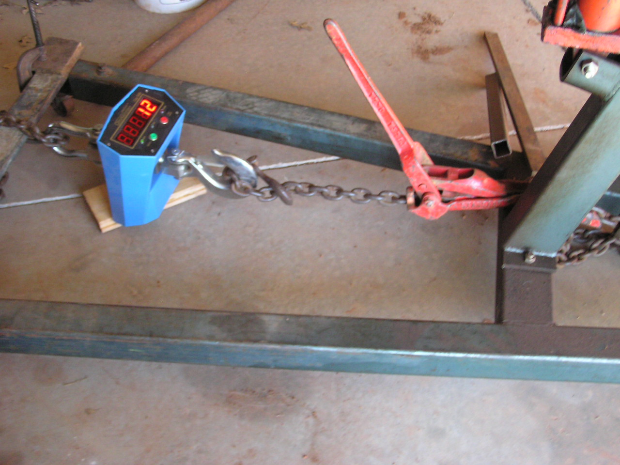

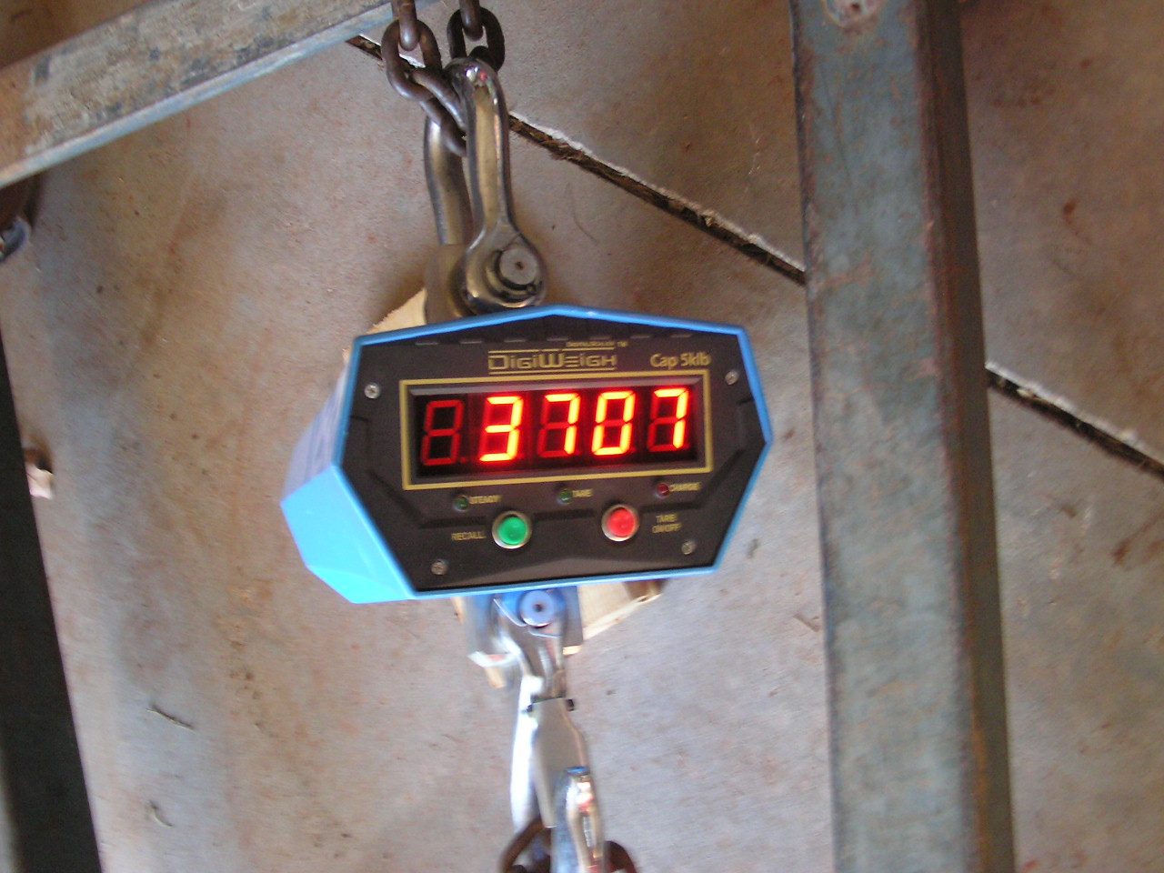

Well I took the time to test the Standard Chain Come-Along and easily exceeded the working load limit of 2750 pounds! JE Shaffer Co.
