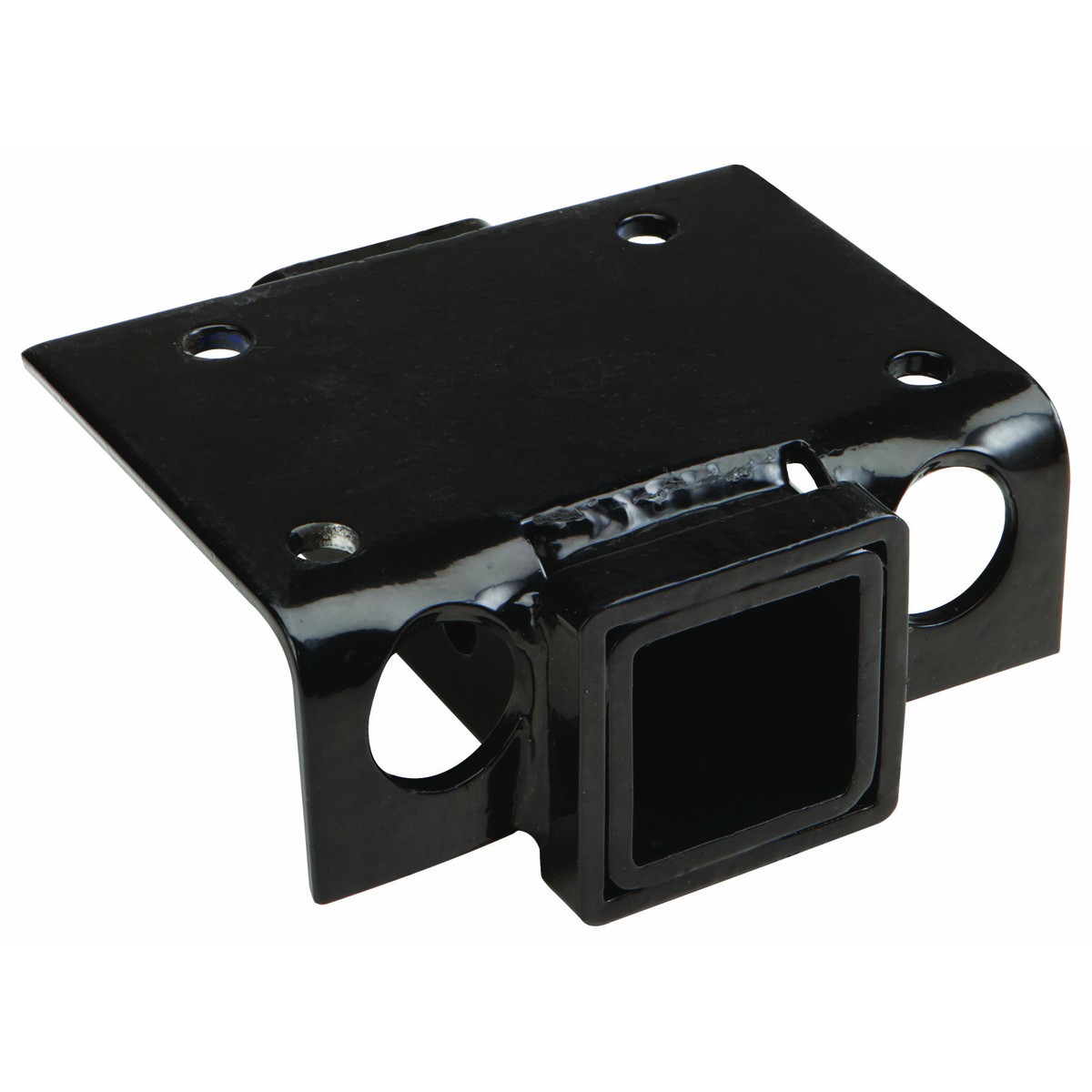

I'd swing by Harbor Freight, and pick up a couple of these. Never seeing your tractor before, I would think it wouldn't take a lot to make these fit front, and back.
5000 lb. Step Bumper Receiver

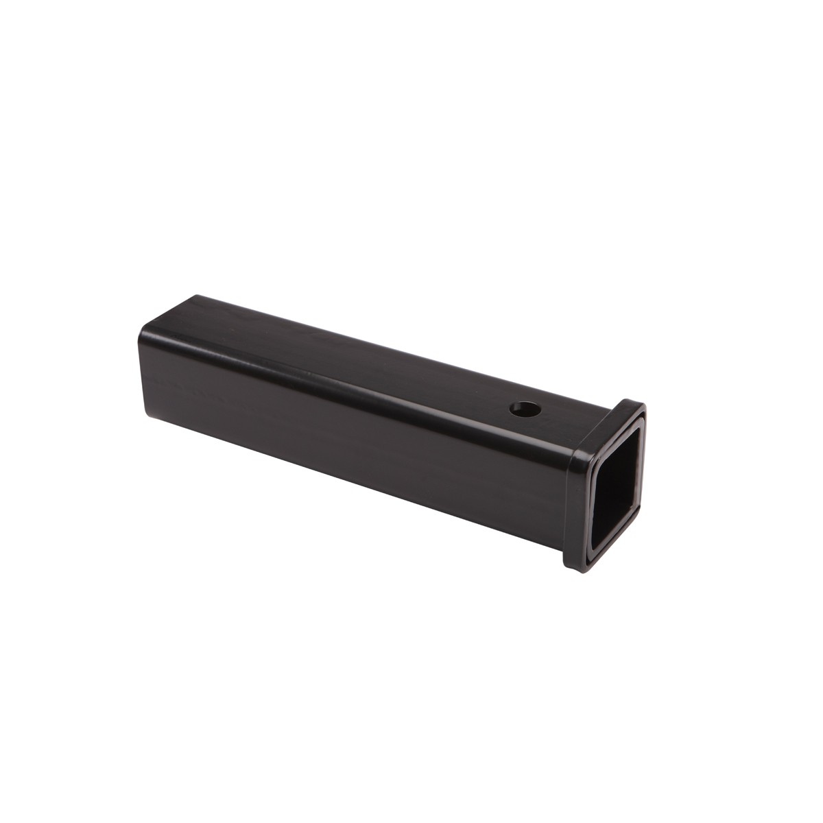

Shield I don't know that a BX has enough extra space for the 5,000 lb step receiver. The 3,500lb unit may be more feasible. I'd use item 69879 as 'raw materials' then add bracing etc as needed to adapt to the tractor. Plus it's long enough to cut it into 2 (or 3) receivers. A winch receiver for a 2600 lb tractor would not need a lot of engagement.
Heres the 12" receiver for raw materials (sometimes easier/cheaper than locating the sq tube). You get (the first) 5/8" hole pre-drilled.
Heres the 3500 lb step receiver.
