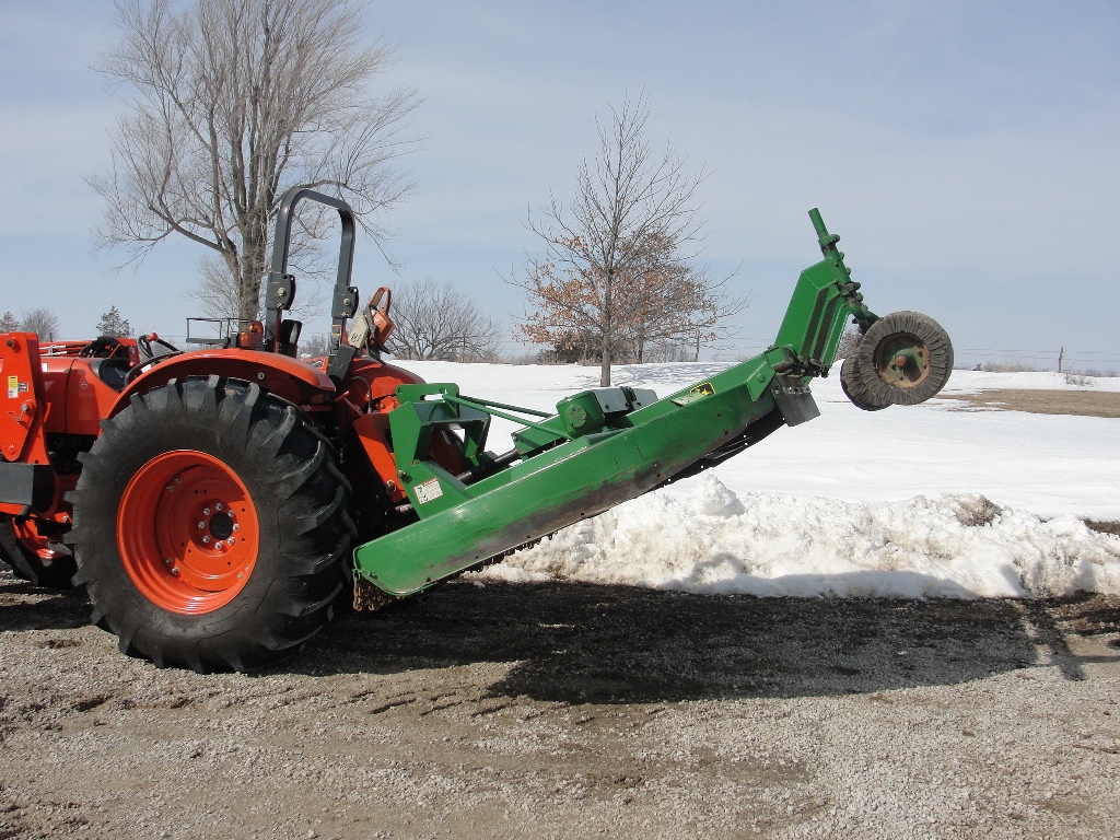

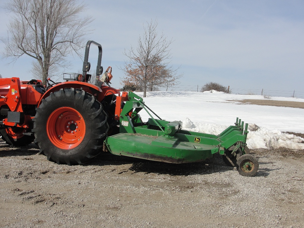

You might want to consider a tilt cylinder as well. This would require a second rear remote. But it allows you to change the 3pt side to side as well.
Top link allows you to do this.

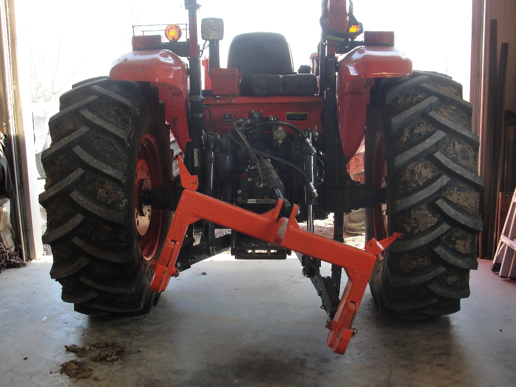

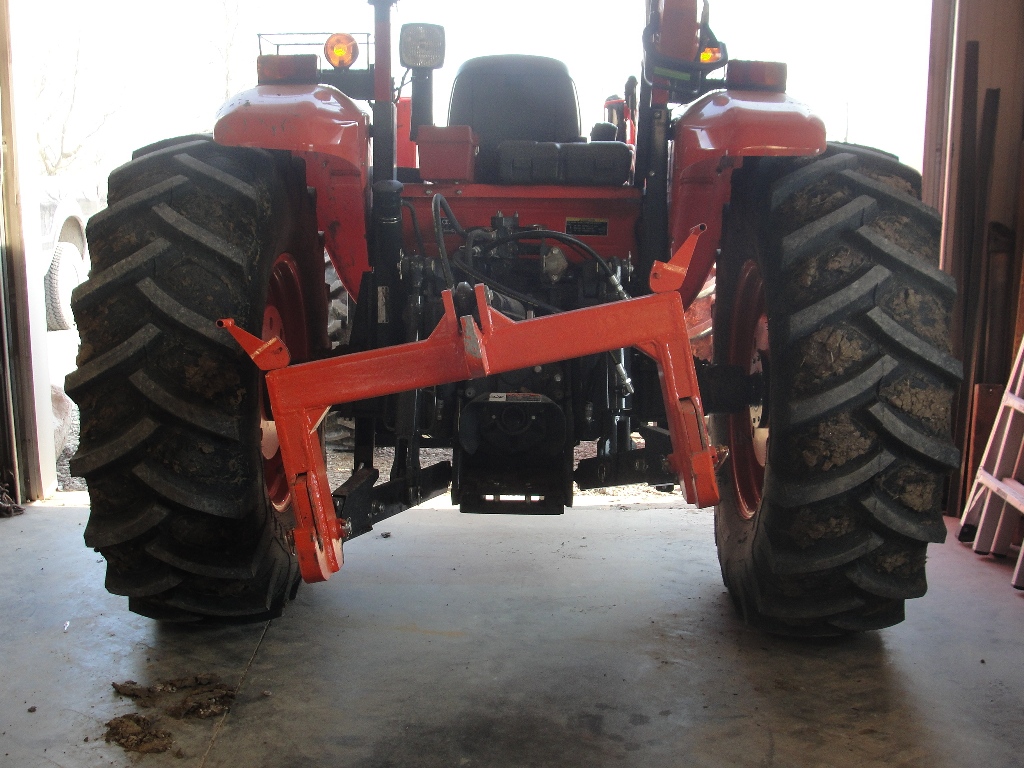

Side link allows you to do this.
