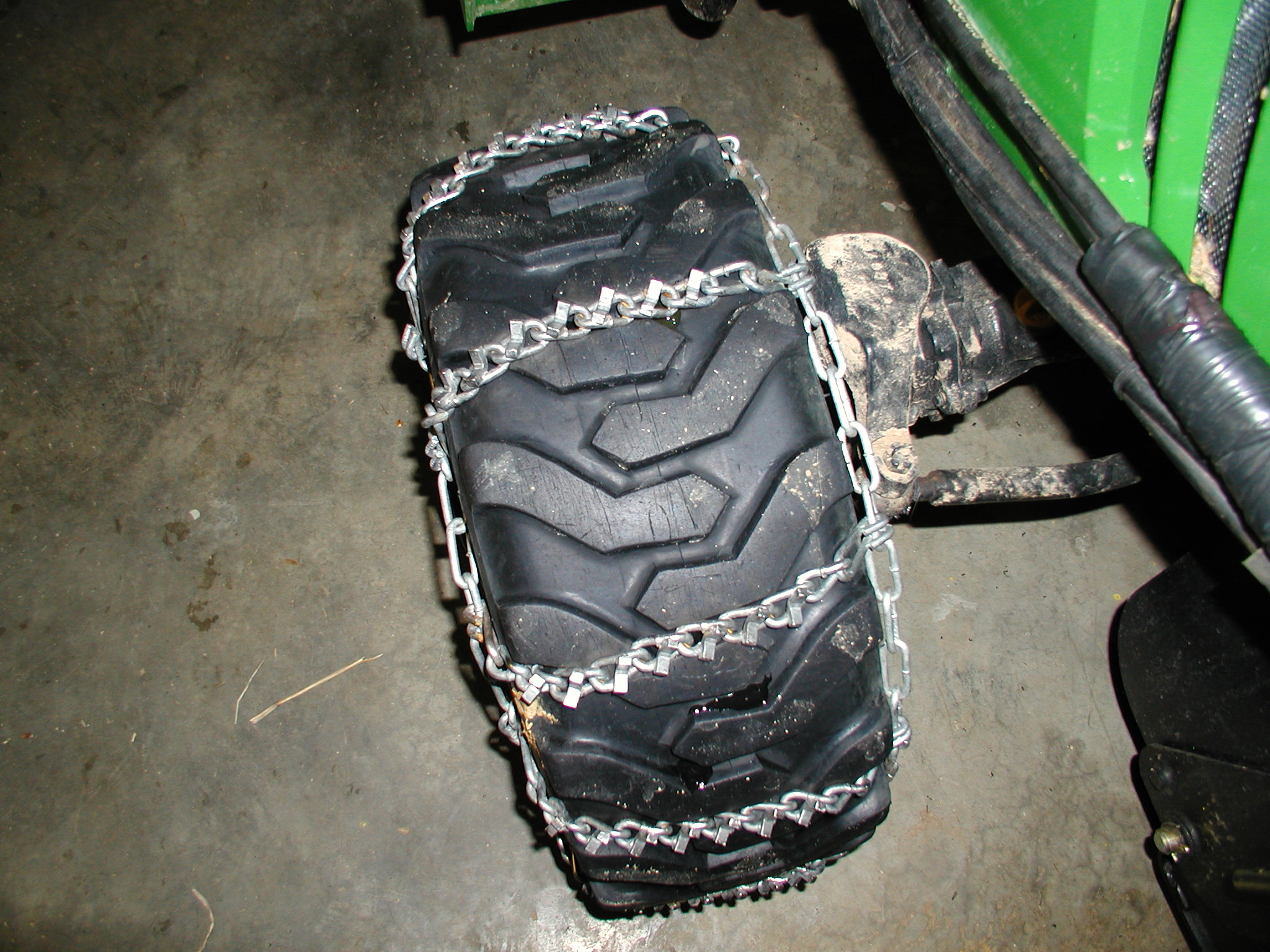

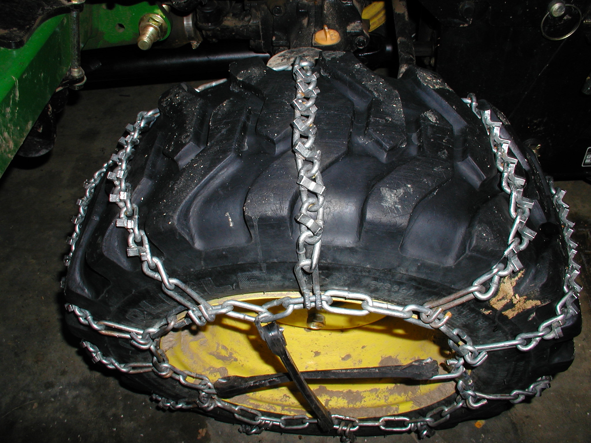

I had chains on all fours on my 2520 when I used it for driveway clearing, and for firewood dragging in the winter. Worked GREAT !!! The thing felt like it would climb a tree. Obviously it puts more strain on the front end, since it is actually helping pull the tractor along with chains on. Didn't hurt mine any though. Sold the tractor, still have the chains, could sell them I guess... pics attached. They are very special. If laid on the floor, they form an arc like a banana shape. That makes them fit the very close 2520 front wheel without hitting the steering arm. The inner chain circle is large, and the outer is small. Maybe the pics will help.

How many links are there in the inner chain versus how many in the outer chain? Sounds like a good idea if they don't want to walk off the tire.
I also run a set like that on my front tires but the inner and outer side chains are the same length (set of car tire chains). No problems and they don't come close to hitting the steering arm (or the front blade hyd. hoses). But they are on my JD 4300.
