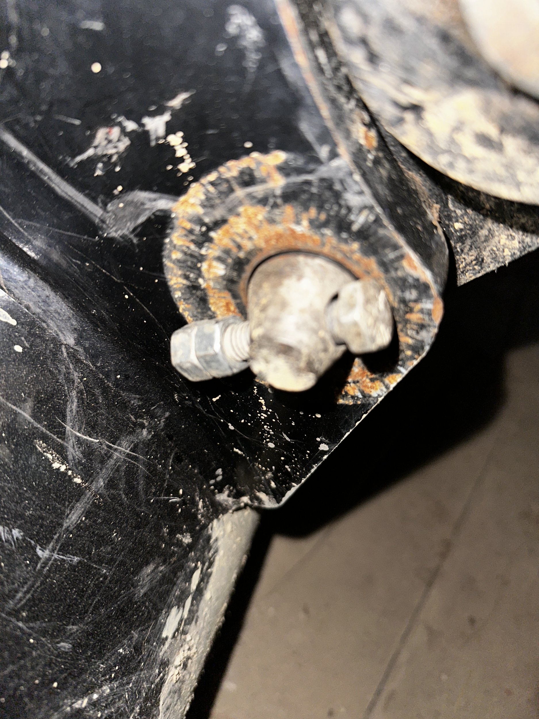

While at Tractor Supply, check out the black lynch pins. Those are super strong pins. I've not had one ever come loose but the zinc plated yellow ones have come off a couple of times.
Just don't get your finger caught in one while testing it.
Another trick is to put a large, properly fitting, washer between the pin and the ball.
View attachment 430888 View attachment 430889
My tractor came with galvanized linch pins from the dealer and those are excellent linch pins. The black ones are good too. The gold-colored ones stink, they bend easily and the springs are weak.
