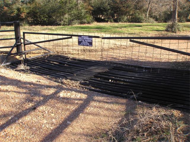

Harvey, I'm not hijacking your thread, I'm the "other".:D

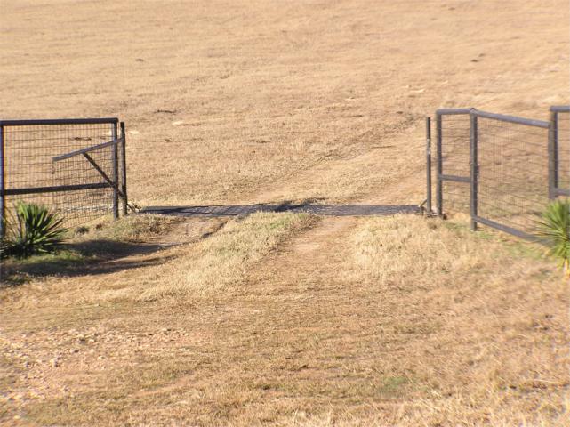

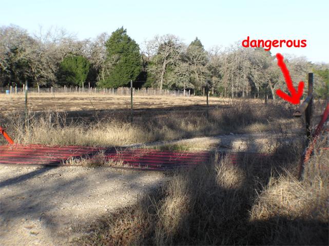

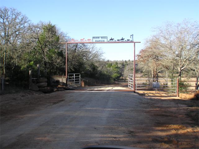

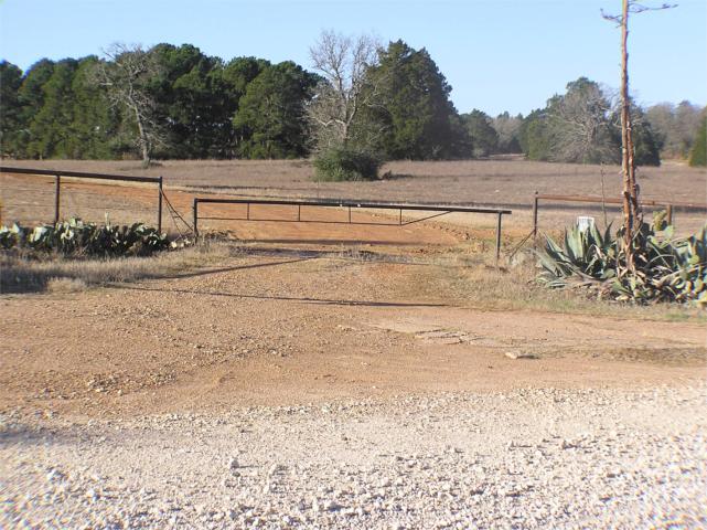

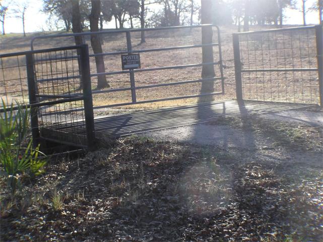

Pat and Mike, to stimulate my mind more I took a drive in Mike's county and looked at the entrances with cattle guards and gates.
Eddie, I'll see if I can move back a bit more. Thanks!!!!
notes:
#3 is the kind of gate that a man in La Grange was impaled with through his windshield and died.
#8 has no cattle guard but it had big cedar
#11 and 12 are the same - he did the bottom with concrete
#15 cattle guard collapsed under a heavy load??????????

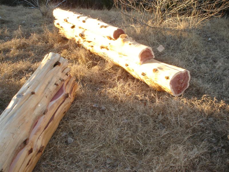

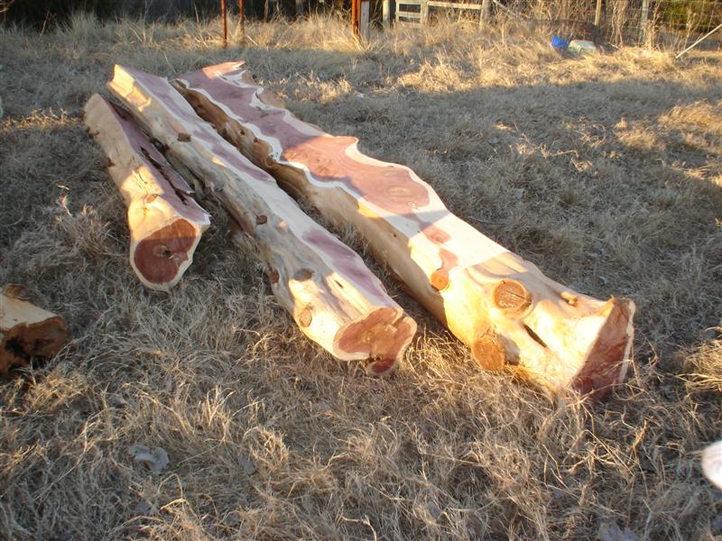

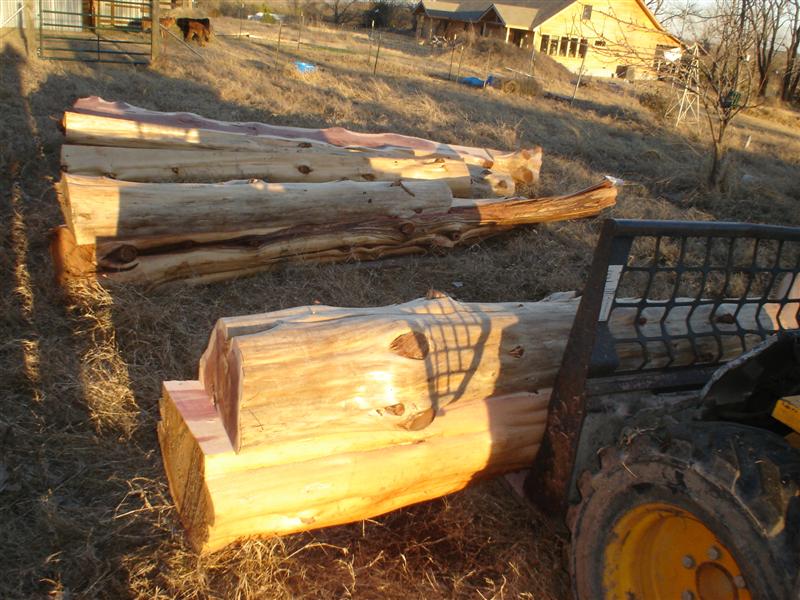

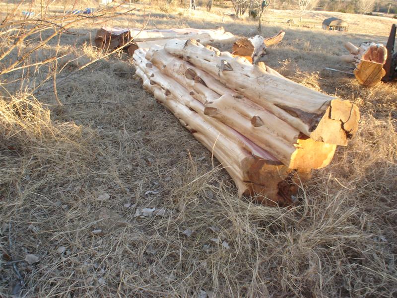

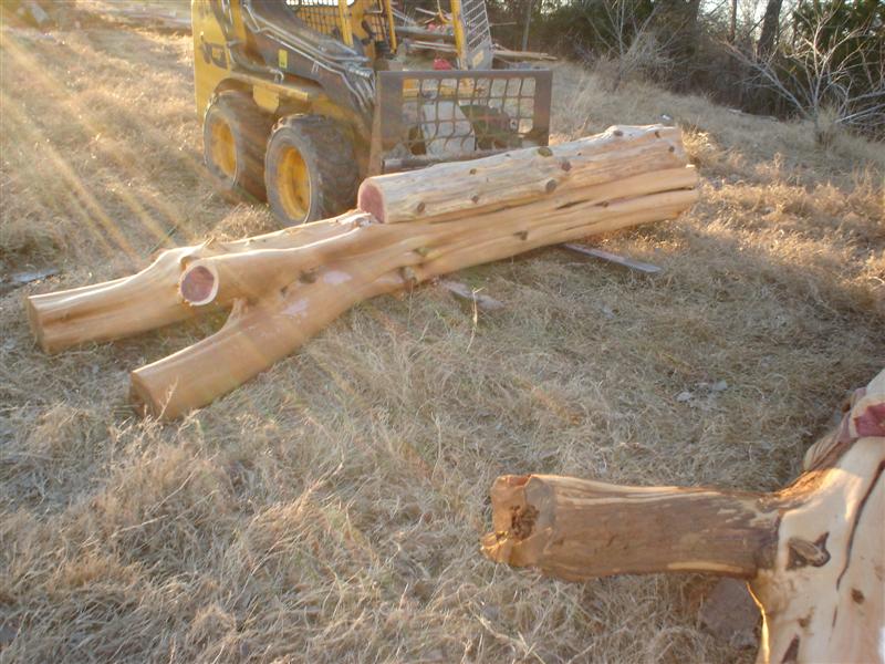

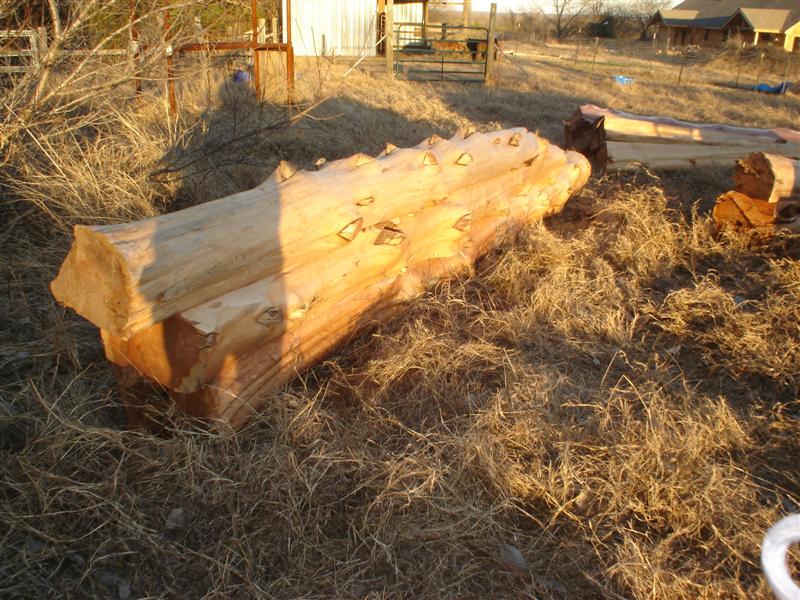

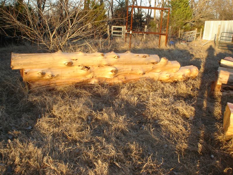

Today we rough cut the logs for the entryways.
One of the entryways will have three posts on either side. The other one will have two but it will have branches cradling the overhead.
These are rough cut and you will have to use your imagination a little.
First thing to keep in mind is none of the cedar logs will be touching dirt. The three log variation will have it's uprights on mounded concrete. We'll have a rock dressing around the base to disquise it. The branch logs are shorter and we're going to have their bottoms four feet off the ground.
It might help if you're having difficulty getting the inclination of my angle of the dangle to take 4618 and 4621 and look at them sideways. Keep in mind these are rough cut.
Tomorrow we load them up and take them to their new homes. There the fun will start.
One of the funner things I do in life is play it as it's dealt. If I was a pilot I'd wear a patch that says, "we don't need no stinking gauges!" I fly by the seat of my pants. Posting pictures as we go on a project like this where we're going where few have gone before the way were doing it I hope shares some of the funner fun I enjoy so much.
I know it's English,:confused: however I think it will make perfect sense by the end of the week.

Hmmmmmm, Don yesterday I prepared the metal posts for the gates. I needed sixteen feet long six inch pipe posts. They come in twenty four lengths and custom lengths cost extra. So I ordered four twelves and four fours. The welds will be in the eight feet of concrete footer.
I hope this helps.

"...the inclination of my angle of the dangle to take 4618 and 4621 and look at them sideways..." "I hope this Helps."
OHHHH! thats what the numbers mean! Very clever.:D

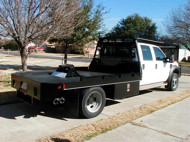

Yep, Harvey, I remember when you moved that bed onto Lucy and had to do a bit of modification. My brother came up from near Waco today. He got his completed truck yesterday, and it's an 11' bed (had to cut the corners off to provide sufficient clearance when turning with the fifth-wheel. I think the new F550s require a little longer bed back beyond the rear axle because the fuel tank is now behind the rear axle. Overall, the truck is about 25' long, and I'll say the 2008 Ford diesel has to be the quietest diesel I've heard. And my brother says this 2008 F550 with the 6.4L diesel and 4.88 differential is definitely more powerful than his 2000 F350 with the 7.3L diesel. But I'm sure glad I don't have to work on those machines. They've pretty well filled up the space under the hood the last few years and I do believe this 2008 model is the fullest I've seen.
