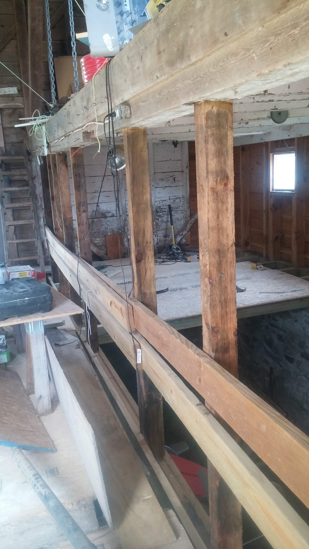

After getting the floor beam shored up I could work on supporting the hay loft on that side. Originally there had been eight posts between the floor beam and the beam that supports the hay loft. They held up that beam, and also served as dividers between the nine dairy stalls in that end of the barn. Those posts had been gone for decades when I came on the scene. They had been replaced by a motley collection of uprights that were landscape timbers from a big box store, not even proper posts. When I hoisted the loft at the beginning of the project they fell away with disturbing ease.
The beams had matching mortises to show where the tenoned posts had been. I was able to buy rough-sawn timbers from a local sawmill. (On the southeast corner of my property is an old family cemetery with a handful of graves, they have the same family name as the mill that I bought the wood from). I cut new posts and cut tenons into both ends. At the bottom I cut the tenons as deep as the mortise, but at the top I only cut them about 3/8" deep. At each post I put the new post in at the bottom, then used a post jack to spread the beams enough to slip the top in. At times hammering and cursing ensued. Where I had replaced a section of the bottom beam I didn't cut new mortises, I just toe-nailed the beam. For those posts I could put a deeper tenon in the top and then swing the bottom into place.
While the mortise and tenon joints aren't visible once the post is in place I believe it makes the beam stronger to have the mortises filled.
Here's a picture of the completed posts, which I learned were called "stanchions."
The center stanchion is missing. At some point a notch was cut into the beam there, I don't know why. I'm still trying to decide whether and how to deal with that.
Once the posts were in place I relaxed the chains a little, letting the weight of the loft settle onto the floor beam. When I had first repaired the beam it seemed almost a little flimsy, shaking under my feet. With some weight on it feels very, very solid.

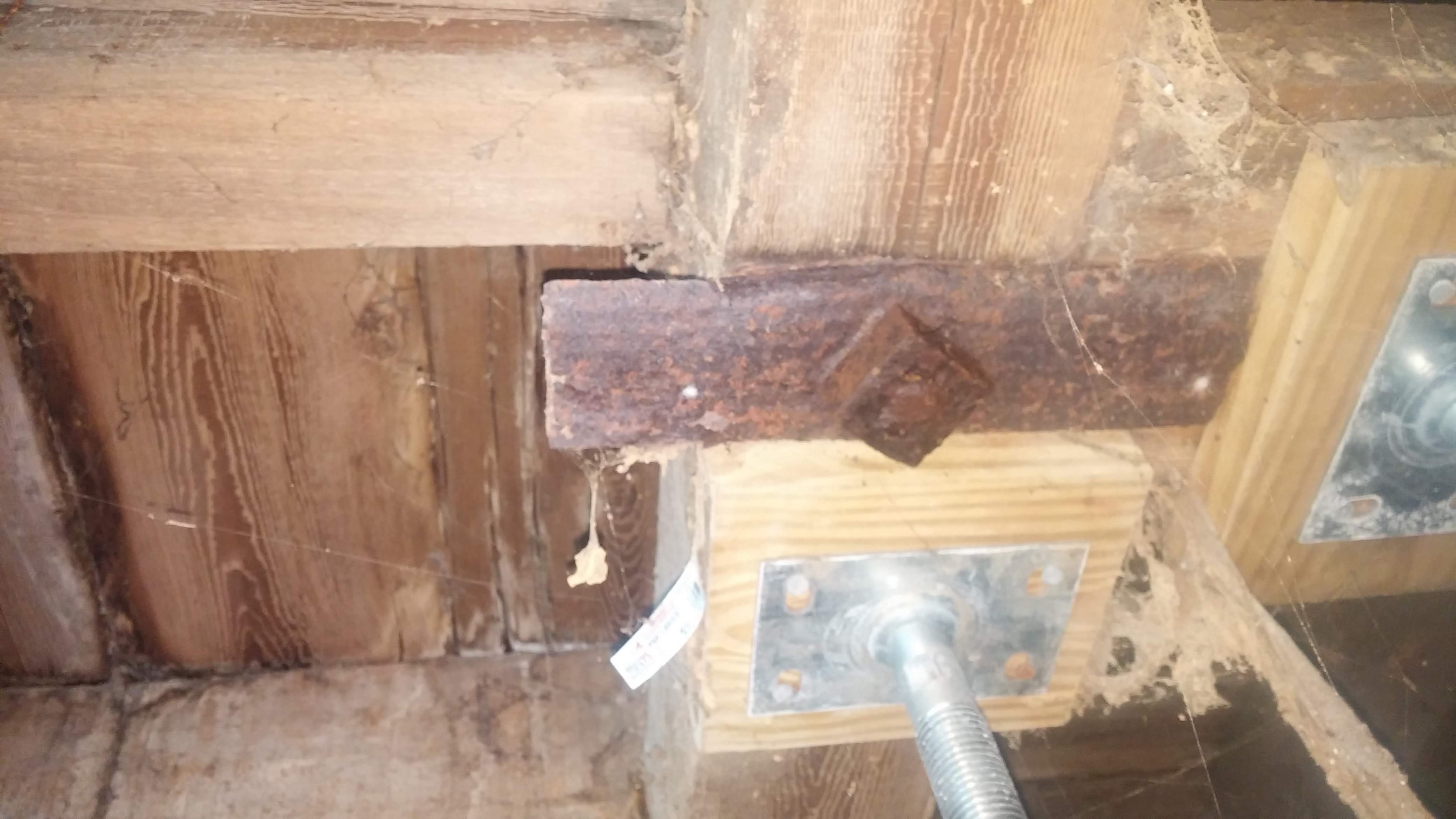

There are two main beams that hold up the floor. I've already told you about the work on the eastern one, now I'll talk about the western one. The beams run north to south and divide the floor into thirds. There are also two smaller beams that run east-west between the main beams and divide the middle third of the floor into thirds (or ninths of the whole floor). In the middle third the floor joists run north-south, and in the outer thirds they run east-west.
The west beam had the only intact suspension rod. Here's a picture of it, from below:
The main beam is running top to bottom in the picture. The suspension rod is the rusted square nut with backing plate in the middle of the picture. Coming in from the right is one of the smaller beams that connects to the other main beam. You can see two of the post jacks I used, each with a piece of treated 2x8 to cushion the beam.
The other suspension rod on this beam had failed, although the beam itself was intact. At some point someone had planted a piece of 4" cast iron pipe vertically in the basement of the barn below the suspension point, and that was holding up that end of the beam. While this suspension point was intact, the beam had sagged 6-8 inches at both points. There's a good chance this happened when the shift was made to baled hay. The loft was built for loose hay, baled hay is 2-3 times denser and the load in the loft would have increased considerably the first time it was filled with baled hay.
I used four post jacks to raise this beam. I put one near each suspension point. I also put one under each cross beam. The cross beams have tenons that go into mortises in the main beams, I was worried that by lifting the main beam alone I would stress and possibly damage the joint. I put the post jacks in place, cinched each one snug, then got a big wrench and started turning. I got the end that was on the pipe to lift off of the pipe. And then nothing happened. I was tugging pretty hard on that wrench, and the jack wouldn't turn. The screw in the jack has seven threads to the inch, and the wrench was about a foot long. The end of the wrench travels 6.28 feet for each revolution of the screw; to raise the jack one inch the wrench travels 44 feet or 527 inches, so my mechanical advantage was over 500 to one. I'm not the strongest guy, but I figured I'm capable of putting 50 to 100 pounds of force onto the wrench, so at that mechanical advantage I was putting thousands of pounds of force into the beam, and it wasn't budging.
So I decided to leave it for a couple days. When I came back, I tried again and the wrench turned easily -- for about 3/4 turn -- then nothing doing. So I came back a few days later, and I repeated the process. Over about a year and a half I turned it a little bit every few days, over and over until I had lifted the beam 6 or 8 inches and it looked level and straight. I'm still not sure if it's exactly straight or level, all I have is a 4' level and the wood is rough enough that it's hard to tell. But when I stand back and eyeball it against the top of the foundation it looks pretty good.
Right now I still have it up on the post jacks and I'm deciding what to do. The one intact suspension rod is sticking up about six inches up in the top of the hayloft. I'm going to have to put a post there, probably a 6x6. What I'm thinking I'll do is cut a section of 6x6 maybe a foot long and run it horizontally along the bottom of the beam, with a notch cut in it to allow for the bottom of the suspension rod. The post would then tie into that piece of 6x6. At the other end I have to decide whether to remove the cast iron pipe, or leave it and use it. If I use it I have to figure out how to tie it to the beam, before there were just a few pieces of scrap lumber which tended to shift. Removing it is going to be a chore as it's set in concrete.
I'm also thinking of putting some sort of modern steel beam hanger on the beams to reinforce the mortise and tenon joints.

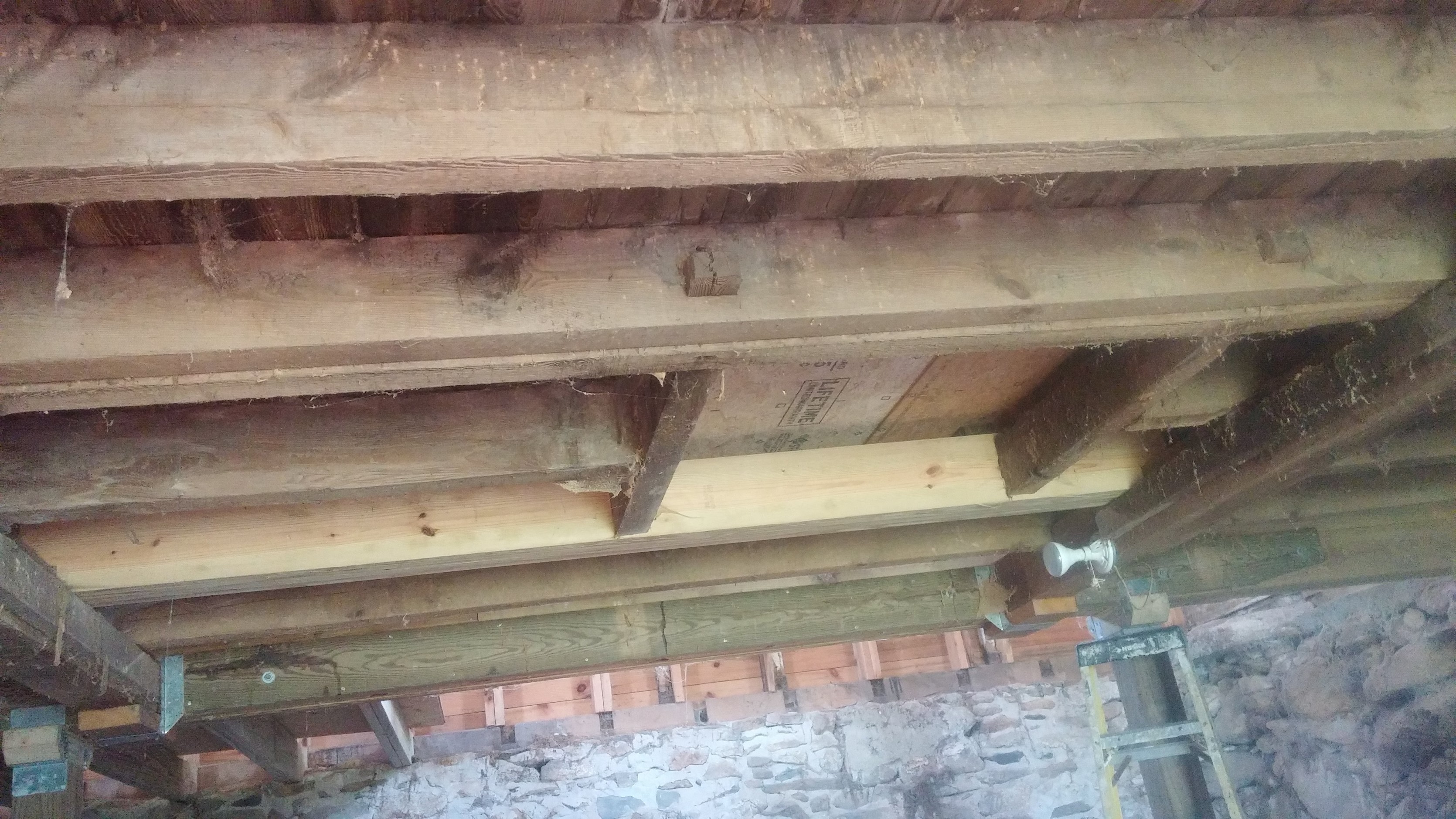

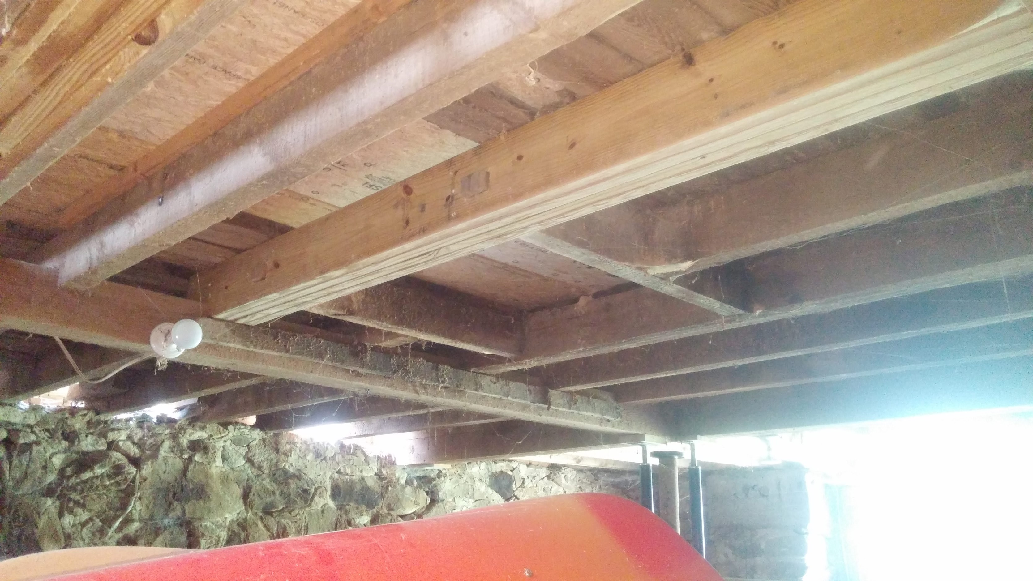

With the beams all squared away it was time to start working on the joists. Near the center of the barn there is a trap door that was used to shovel manure into a wagon in the basement. It's roughly 4 feet square and has a doubled joist on each side and a header joist on each end. The header joists are tenoned at each end and go into mortises in the double joists. A previous owner had driven a tractor over it and broken the double joists on one side.
The joists are 3" by 7" and roughly 28 feet long. The are supported by two beams spaced a third of the width of the floor. Where they cross the beams each joist is notched. The joists are about 21" on center. (Nothing in the barn is on 16" centers or even multiples of two, most dimensions seem to be prime numbers. I can only conclude it was built by numerologists.) I had to replace two joists. Since I can't get 28' pieces of lumber any more, I cut the joists to be replaced where they crossed the beams, and only replaced the section between the beams. A modern 2x8 is 1.5 by 7.25, so a doubled 2x8 just about exactly matches the 3x7 joists. So a quadrupled 2x8 was needed to replace the doubled old joists.
I used post jacks to support the header joists, then cut out and removed the broken joists. I didn't take pictures but they had snapped all the way through, they came out in pieces. I then cut notches on the ends of the replacement joists so they would sit on the beams, and cut mortises into all four joists to match the tenons on the header joists. The way I cut the mortises was to hold the first joist against the tenons and trace the outline, and then trim until it just slid onto the tenon. Once I had one good I copied the pattern to the other three joists. As I put the new joists in I nailed them to each other with 16d nails. Once the replacement joists were in I removed the post jacks.
Here are a couple of pictures of the finished product:
The underside of the floor doesn't look too bad in the pictures, but it's actually in rough shape, missing a number of boards and layers of patches of varying quality. When the joists are all fixed my plan is to take up the floorboards and put down a new floor.
I'm not sure what to do with the trap door, right now I just have a piece of Advantech over it.

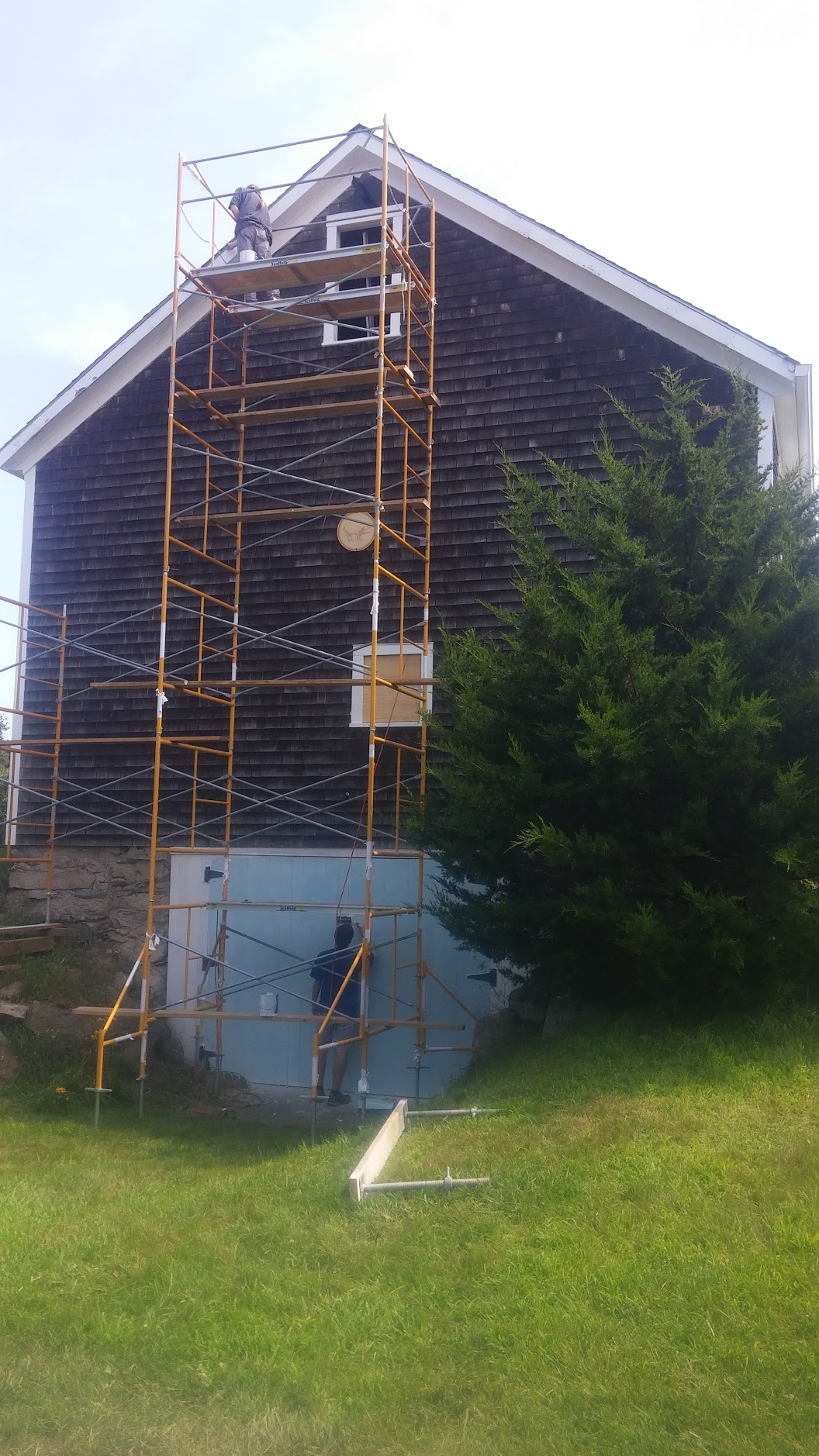

I'm almost getting caught up to the present day. Over the summer I got my sons to paint the outside of the barn:
It's pretty tall and the ground is very uneven around the outside, so I thought the only safe way was to use scaffolding. We've painted various pieces of the barn over the past ten years, but this is the first time in a long time -- perhaps 30 years, perhaps even more -- that the entire outside has been painted all at once. It looks a lot better.
We also painted all of the windows, which was a pain, there are a total of 15 wooden sashes, five single and five double. Each had to be scraped, puttied, primed and painted. Two of the sashes were rotted out -- the lower one in the upper window in this picture, and the lower window in this picture. I replaced them with PVC sashes that I had custom made, I'm looking forward to never painting them. I also replaced the lower windowframe in this picture.
The last time we needed to get up on this side I borrowed a 36' ladder from a friend but it was too short so I parked the tractor by the door and put the feet of the ladder in the bucket, about eight feet off the ground. I decided I didn't want the kids doing that.

Do you own all this scaffolding or did you rent it? I rent it for jobs, but keep thinking that I need to buy 3 sections just to have on hand so I can use them when I need them and not deal with the back and forth time needed to rent. But most of the time, if I need to work up high, I rent a tow-able hydraulic lift. The safety and speed factor make it the best choice by far when working on anything 2 stories up or taller.
I bought the scaffolding (or pipe staging as we call it in New England) from ScaffoldMart.com. I bought 12 frames, I figure I can always sell it and get back most of what I paid. On the short side of the barn I can reach the roof with two frames and if I set it up six frames wide and two high I can reach the whole side if I hang off the end a bit. On the tall ends I thought I would have to go six frames high but it turns out five plus the railing I can reach the peak if I stand on tiptoes and crank the feet up all the way. So I have two extra frames, which you can see in the picture allows me to work a bit on the side when I have it at full height. It is a bit of a pain working on the ends because I have to keep moving sections around to reach everything.
I have rented in the past and it's a pain, especially since I don't have a vehicle that will transport it so I have to rent a trailer too when I rent it. Owning it makes it a lot easier to work at my own pace. It is a chore to set up and move, but I treat my kids labor as free, I figure I'd be paying for them one way or another whether they were working or not. I can move it pretty easily using the forks on the tractor.
Two things I like about the scaffolding: first, I can set it up by myself if I have to, all of the pieces are light enough to move by myself. I've used pump jacks and you really need a second person, even a ladder that tall I'd need someone to help me. Second, all three of us can work at the same time and not get in each other's way. In fact, one day Mrs. Quicksand came out and there were four of us on the scaffold painting.
A towable lift is about $350/day here, the scaffolding pays for itself quickly at that rate.
