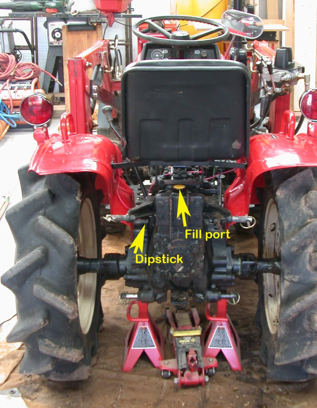

a photo of what that cap is supposed to look like
This is the only one I could find
   / This can’t be right can it? #12
Ok.. Doing a little search, I found this Parts Manual, but its in Japanese?
https://cdn.shopify.com/s/files/1/1486/5356/files/YM1510D_Parts_Manual_DONE.pdf (free d/l so save a copy)
Looking for the part, on pages 79 and 80 (as counted by the pdf reader) I see a Filler Cap #15 which is listed as p/n 194990-75170
Searching for that, I found this page saying it was replaced by p/n 194065-18410 listed here
A search for the 18410 cap showed several dealers but they all seem to be actually from Parts ASAP at $12-$15 w/ $15 shipping.
Hope that helps! 😁

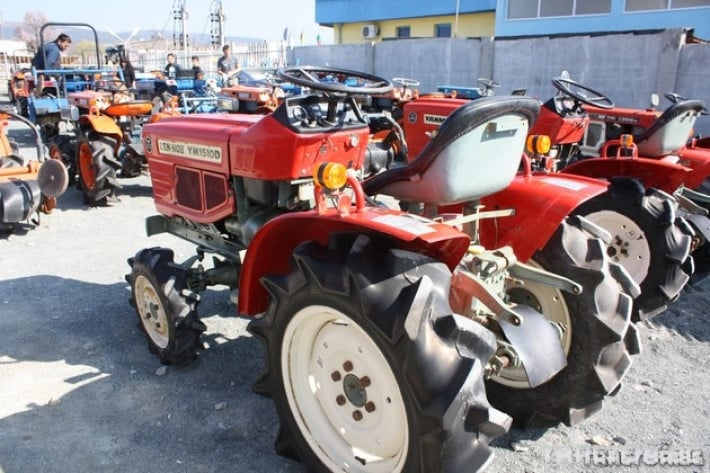

Still no part # only if it is vented! Just seen a 1510 model. Seems to be in really nice condition!
