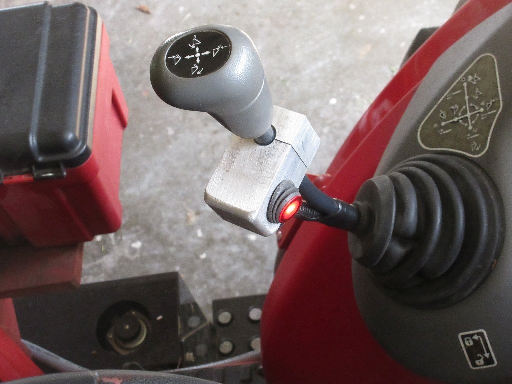

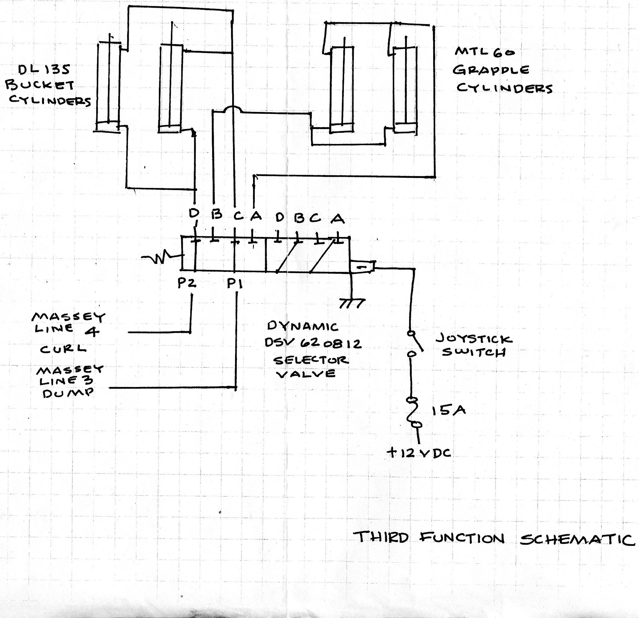

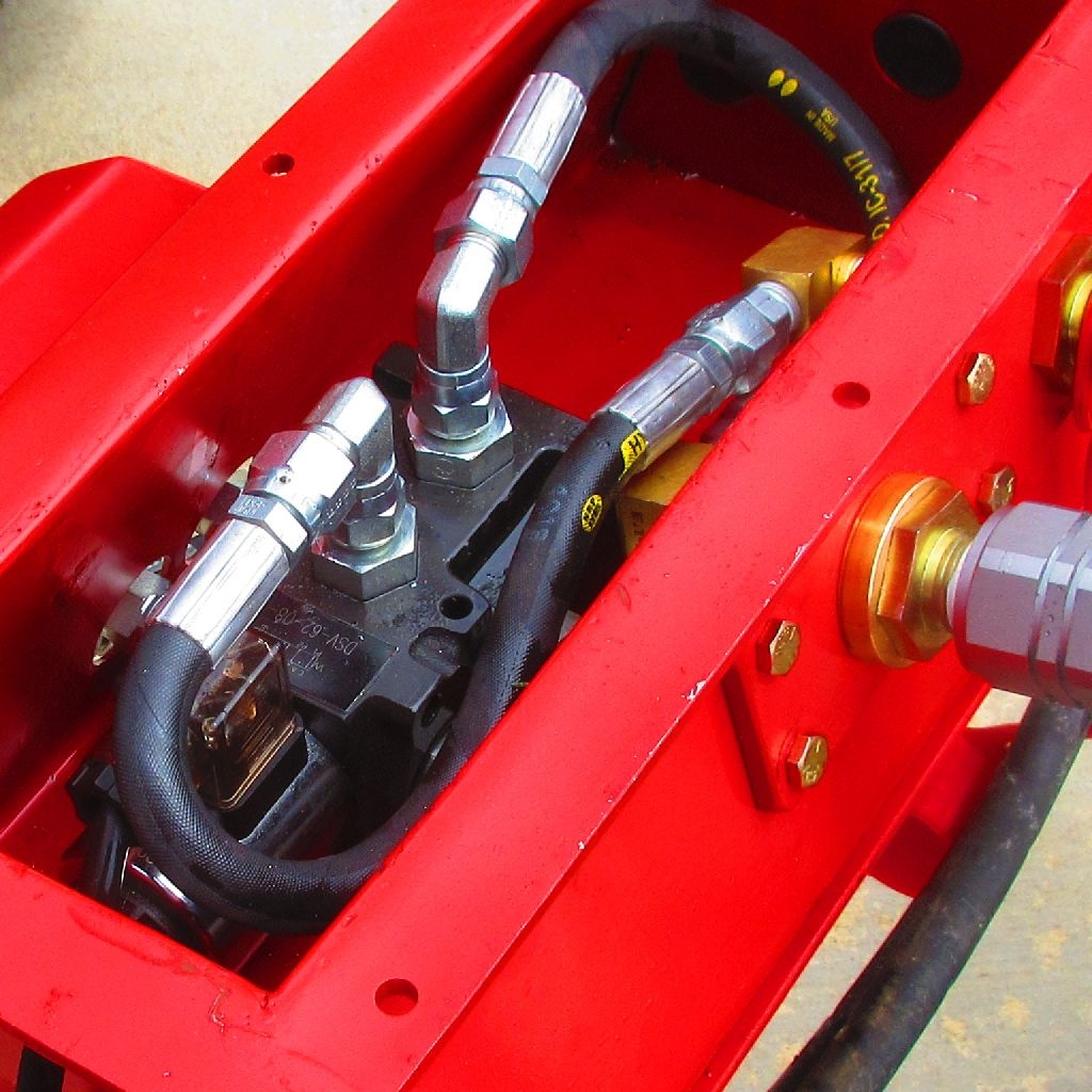

Sure, a number of ways to add 3RD function. This is how I added the feature to my Massey-Ferguson 1754 to operate the grapple. The Massey kit for this is probably similar, but I liked the idea of protecting the valve in an enclosure. I also made the rocker switch housing mounted on the joystick. This system (as does the Massey kit) utilizes the existing long lines and requires only a few very short hoses to complete the job. The main cost was the valve which is variously priced. Easy to operate.
