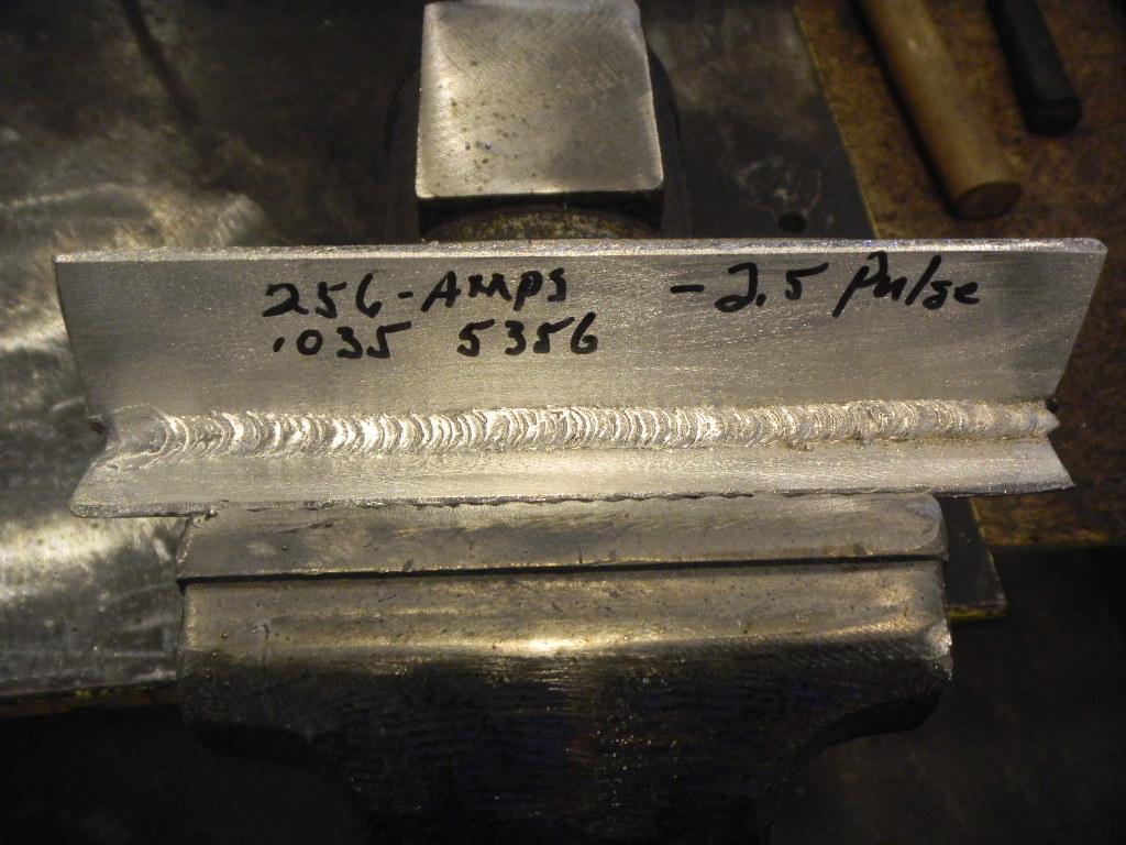

TIG doesn't need a lot of amps on alum... ANY WELDING needs a lot of amps on alum. Alum is one of the best conductors of heat, so you need to pump lots of heat into it to get a puddle going, and maintain it.
/ Thinking about Stick welding #6
That's very true! Look at this Mig weld on 10-GA aluminum.

Welding properly is about melting the base metal and the filler. If you can't get and maintain a puddle, you are not getting a good weld. That takes heat, and alum conducts it so well that you need to pump a lot of heat in quickly to get the puddle going and stable before the base metal sucks it all away.

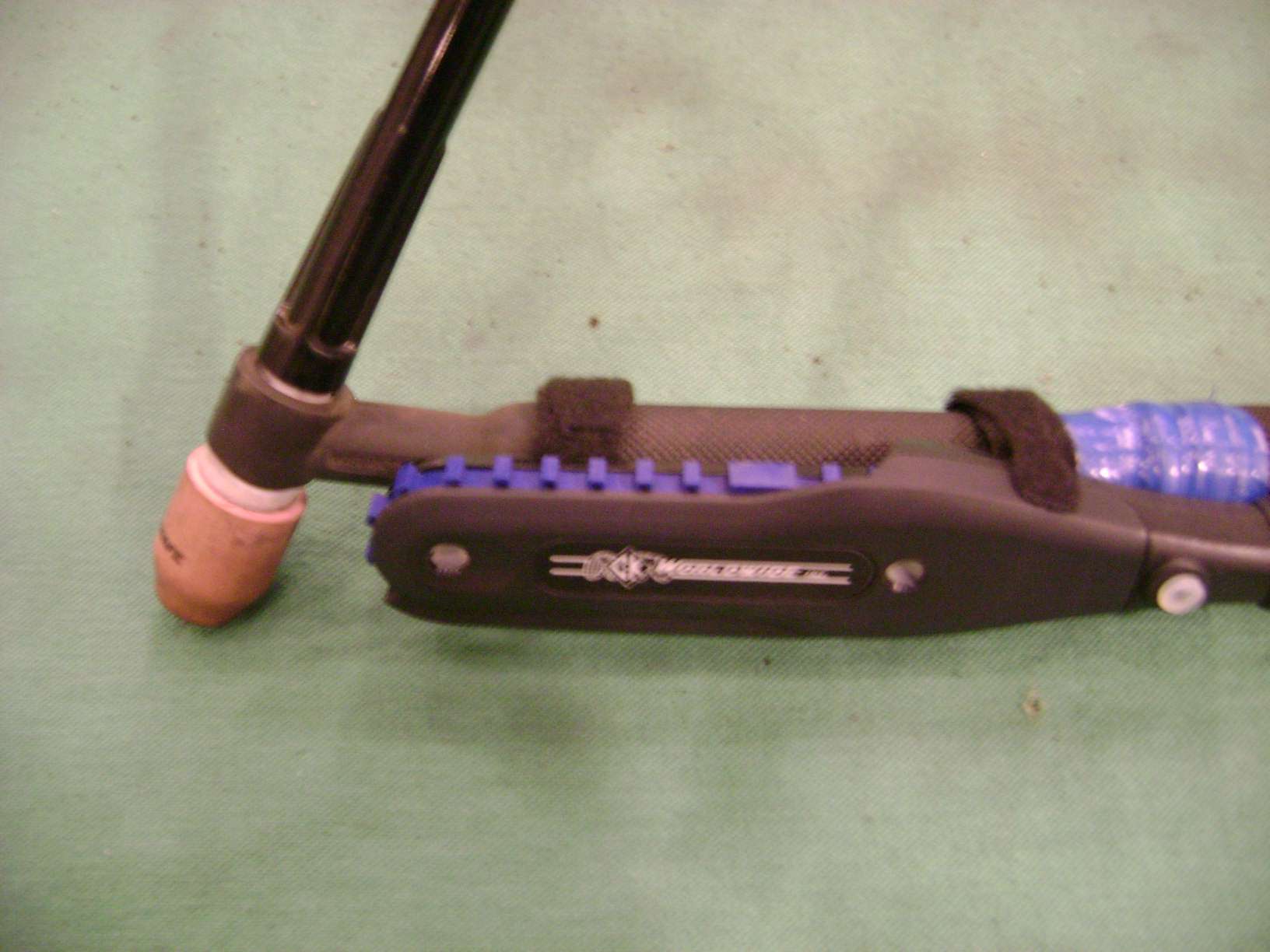

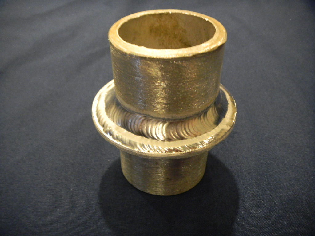

In my limited knowledge of aluminum welding, or even welding in general, there is nothing like a foot pedal, or hand control for aluminum welding.
Here is an aluminum weld I made with my Dynasty 300, with foot pedal. And a picture of a hand control if someone doesn't know what they are.

No intent to criticize your welding SA, just to draw attention to the heat sink in the thin aluminum plate and how far you had to weld prior to getting the unit hot enough for good tie-ins with the MIG which is a major issue with MIG if you dont have equipment to preheat or dont heat it. I hate welding aluminum due to the fine line of too much preheat and it will fall apart like pot metal and not enough then you get cold lap especially with MIG. At least with TIG you can preheat with the TIG torch and go as slow as you need to to make it smooth whereas MIG is a go or stop so start temps have to be right so you really need a Laser temp gun to weld it right. I didnt have those years ago when I welded so it was either use a tempil stick which contaminated the weld area or just guess at it.
One thing I am envious of is your equipment but I dont envy the money you had to spent to get it. Hopefully one day you can get a business going to recoup some of your investment if that is in your plans.
I think if I had a shop like yours, I would look at doing small ASME certified pressure vessels that the large vessel shops dont mess with. If you could get an ISO certified qualitycontrol program established and get a "U" stamp you would be in business if you had some contacts in the industry that could throw a little work your way to get started. Another thing would be to fab small structural steel items like Instrument stands for construction jobs and 2" and below piping that the large shops wont touch unless forced to in order to get the large bore contract.
