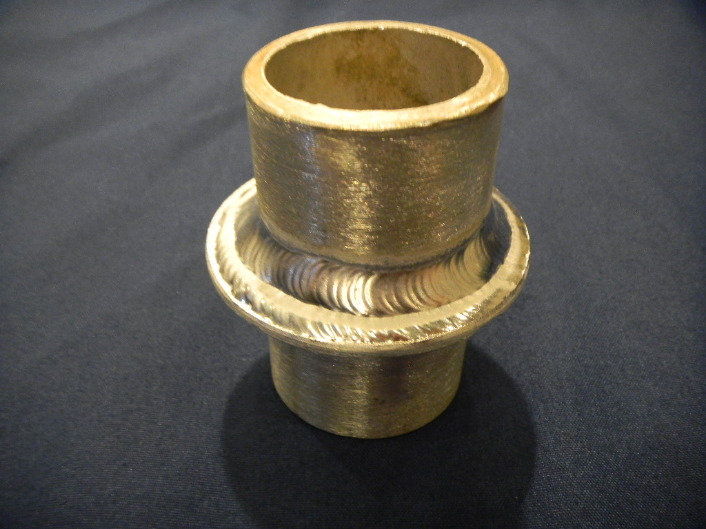

No intent to criticize your welding SA
Oh no Gary, I did not take it that way at all! You were only speaking the truth, as usual. ;)
That picture of the MIg weld was just me playing around with the new V350-PRO, and spool gun. Trying to figure everything out, especially the pulse.
I have no intentions of making money in my shop. I never have drank or smoked. All this is just entertainment. Beats watching the boob tube:laughing:!
But come to think of it, it might be cheaper to take up drinking.:eek:
