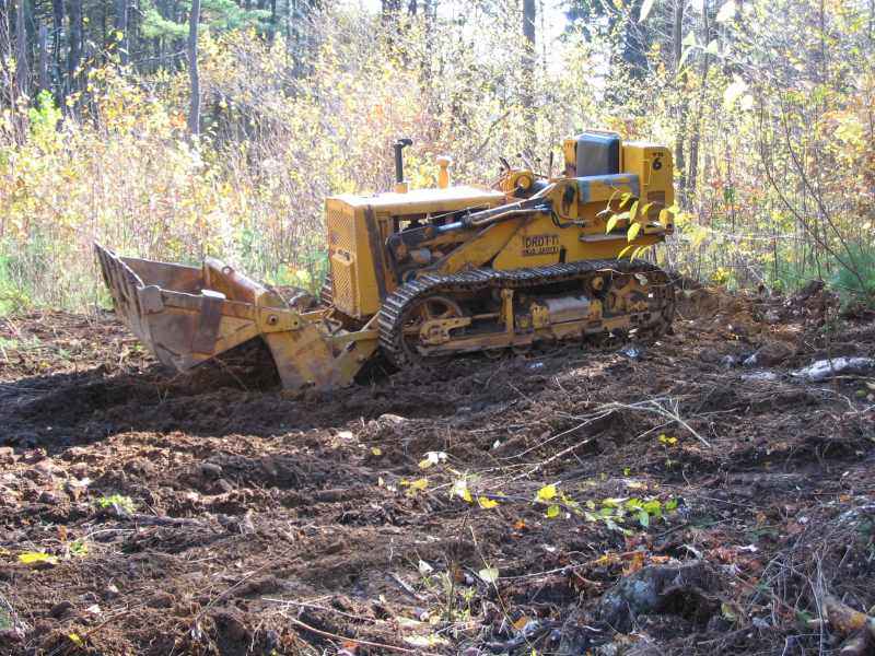

I agree with Dargo. Get a high lift crawler loader. Better yet, get one with a 4 in 1 bucket then you have the best of both worlds.
I picked this one up to clear land and move dirt. Works quite well and can be had for around $5000 when you can find them.
Buy one, do the work yourself, then sell it for what you paid for it.

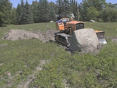

Your going to have a blast nothing like a dozer to change the face of your property.
Might consider cutting the topsoil first & pushing off to side then moving the subsoil where it needs to go.
Don't limit your ideas -- how about road improvements breaking trails, parking areas, etc?? Fill the weekend!
My dozer has a 1 yard 6 way blade but if a pile has sat awhile & is firm it will push 3-4 yards before losing traction.
Pix of a little yard ornament dug up by tlb.

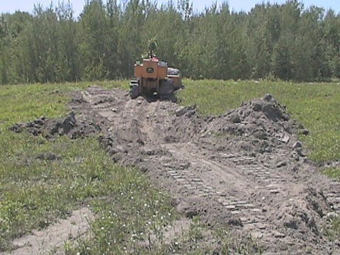

Front view est weight around 5-7000 lbs.

/forums/images/graemlins/cool.gif Thanks for the pics Barry. Wish I owned one. Renting for the weekend will be fun.
