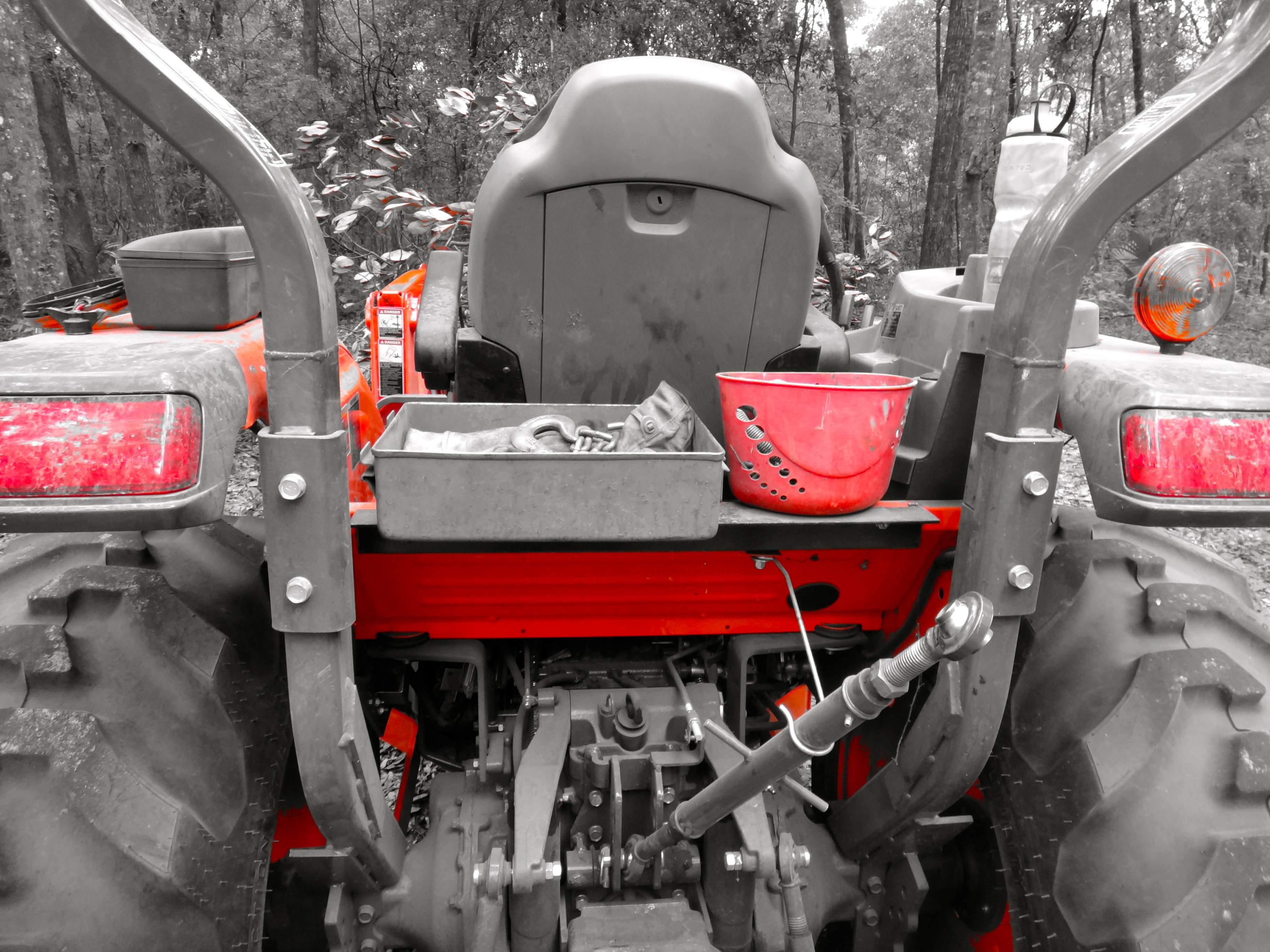

There are a lot of good solutions to this one, if you peruse the site. I haven't done it yet, but plan to build a box to slide into the tube on the bottom of the loader frame. I already carry a chain there.
I strongly advise not carrying things in the bucket, as it's too easy to forget it's there. It's a sickening feeling when you see your "newly modified" chainsaw appear between the front tires... and don't ask me how I know that.
Lol, er, I mean, my sympathies.
Yeah, I've been reading the various carryall and other topics. I haven't seen any ROPs mounted solutions I like though, and I'm not entirely sure I'd want to take off my favored rear implement just to carry some things anyway.

That is why I replaced Kubota 5/8" bolt with 9/16" diameter clevis pin. 9/16" diameter clevis pin is probably not available in your local hardware store.
I do not discern any safety issues. The Kubota ROPS bolt is a pivot, not a support. Kubota loves to sell replacement proprietary ROPS bolts at absurd $60 per pair.
