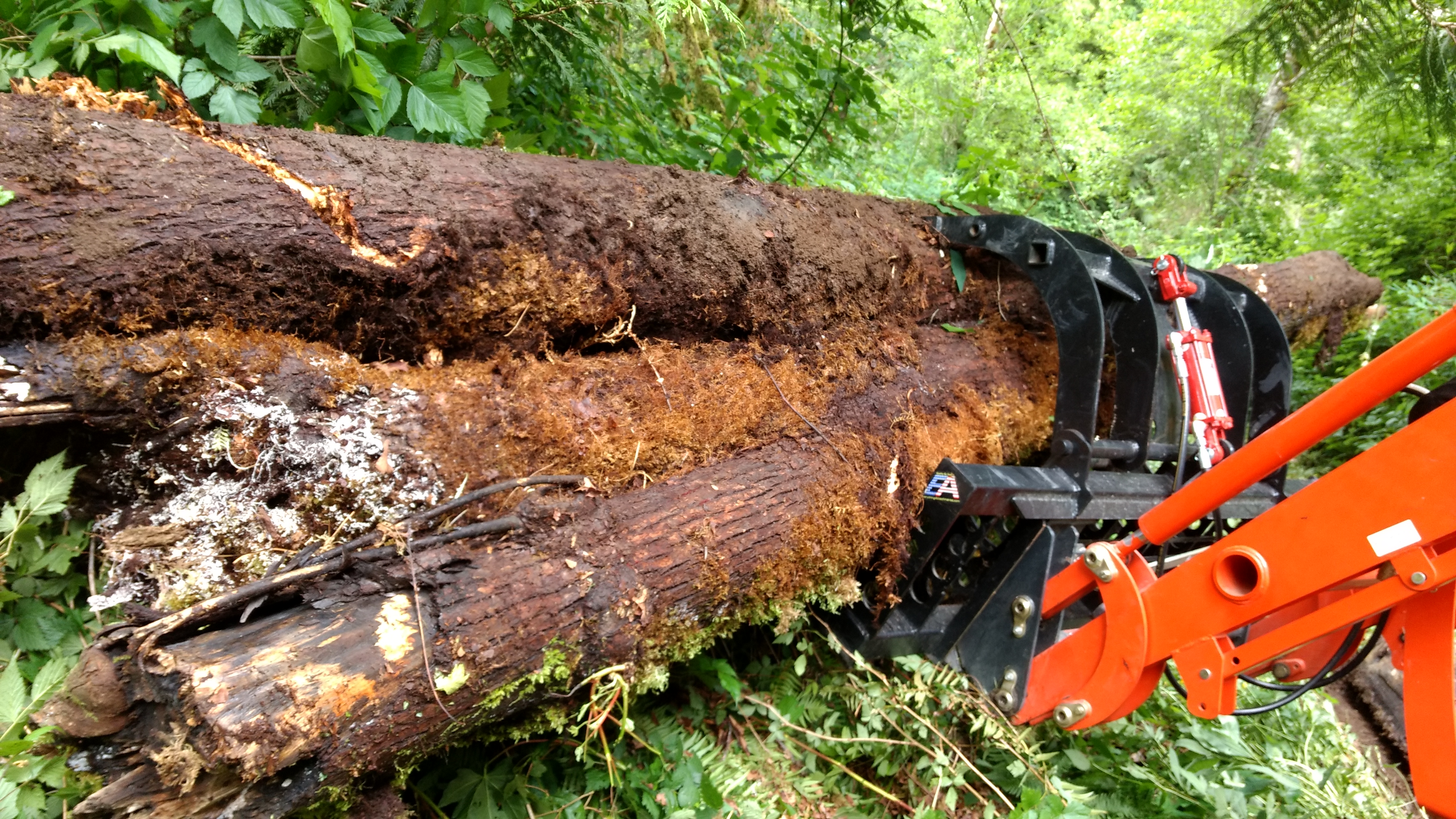

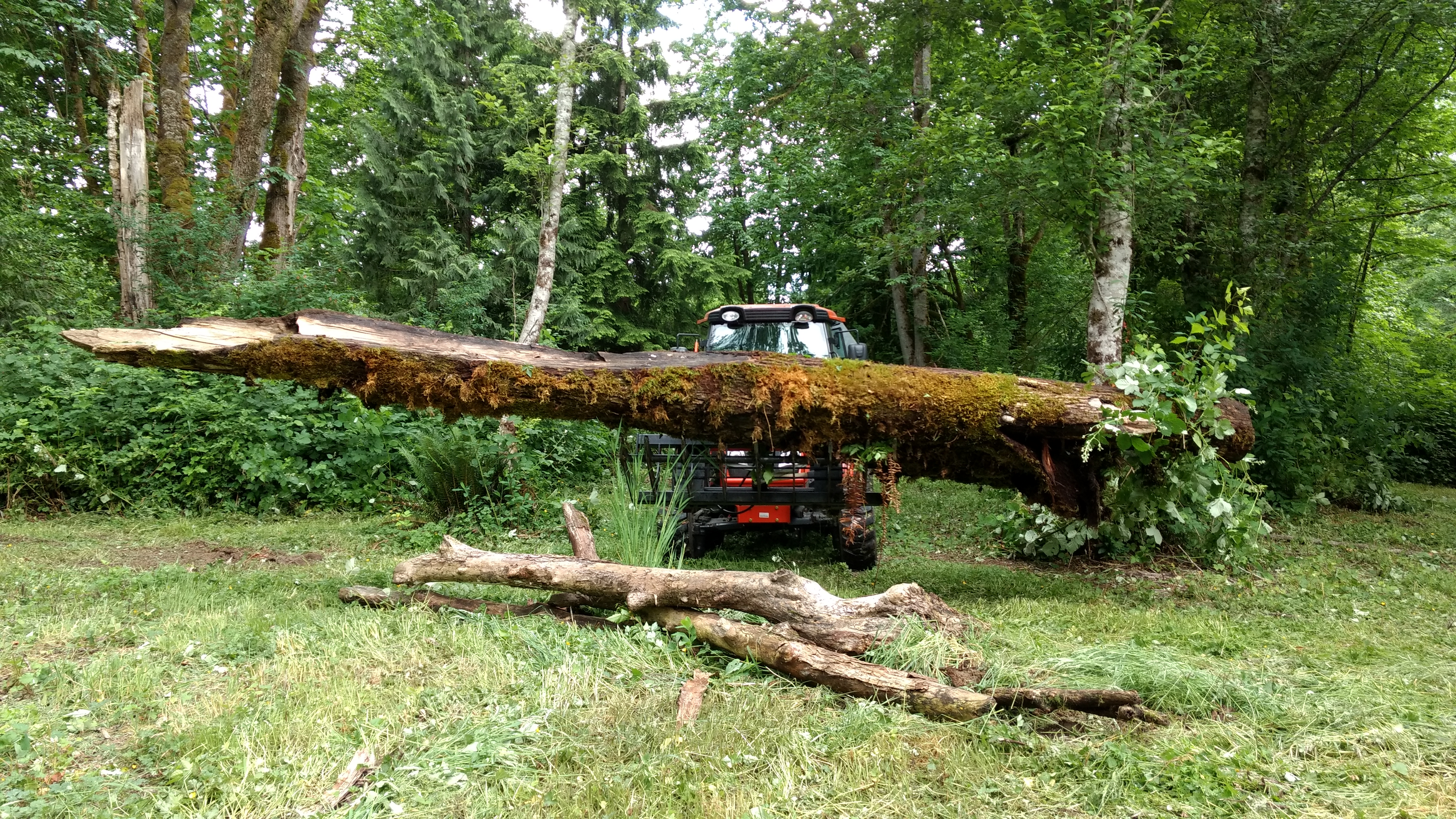

Worried about getting off the tractor with a full mouth? Not sure if a dual lid grapple would have been able to bite on this (tapered to the left there on the trunk).
I've picked up bigger and heavier ones, but this is close to what I figure is a safe limit (this is wider shot of the above trunk).

Big stuff is, mostly, just moved a short distance: get it out of the brush and to a spot where it's easier to cut for firewood.
It is hoped that my pictures help to dispel any worries that these grapples aren't robust. My biggest concern, early on, was whether the the clamping force was adequate: it is- I've got a picture around here somewhere that was taken with my grapple clamping down on two conjoined stumps, dangling down from the grapple (clearly the full weight was being held by the clamping force).
If it had a wider opening, a dual lid would pick it up. :laughing:

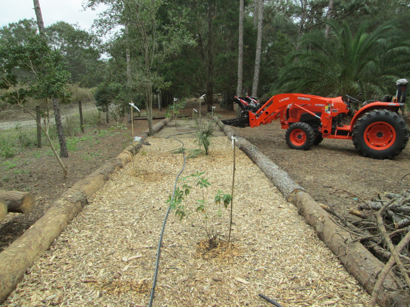

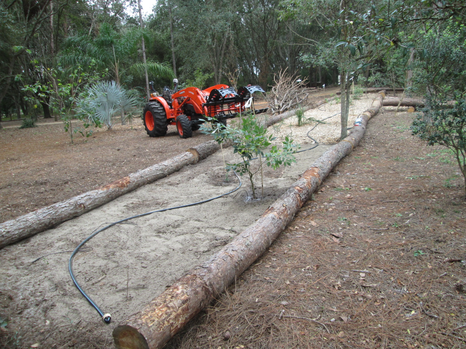

PROGRESS REPORT... North Line Bed... 66" EA Grapple-Bucket...
These are not really 'action shots' because I am uncomfortable getting on/off the tractor to 'stage' pics ESPECIALLY with some of these VERY LONG/HEAVY logs but I think YOU get the gist... Also, productivity is a consideration since the law of diminishing returns is kicking-in... As promised I have made some progress/pics on this hurricane IRMA damaged area of LARGE pines now called the 'North Line Bed'... The combo-tractor/grapple-activity/experience allows me to make this report (MUCH more to come)... There have been several LARGE/LONG logs moved/placed with the EA wicked grapple in order to provide some retaining for all the wood/brush-chips (they rot VERY fast in this semi-tropical environ of Central Florida)... BE VERY CAREFUL PICKING/MOVING LARGE/LONG LOGS!!! THEY CAN/WILL RACK YOUR LOADER/TOPPLE YOUR TRACTOR AND THE GRAPPLE BUCKET MAKES IT EXPONENTIALLY EASIER FOR THIS TO OCCUR... AGAIN, WATCH OUT...!!! I realize the chips are 'attractive' to certain 'critters' but at least it is in a concentrated area and I can also effectively 'treat' them in a concentrated way... I run the 'clean' brush through the chipper, burn the 'dirty' and mix the two for a soil amendment-balance... Anyway, I also want to report/update for those who have been curious-asking/following/providing help-input, that my KUBOTA L4701 DT seems to perform well with the EA 66" Wicked Grapple... It was a tough decision, what size (60/66/72) and configuration (single/dual-lids)... I chose the 66" not just as a 'middle-of-the-road' compromise but for the added strength on the sides (due to the 3.5" vs 7.5" tine spacing) while trying to keep the width close to my wheel-base... As far as the weight is concerned, the EA 66" dual-lid grapple-bucket is the max I would put/recommend on this tractor/loader and still have plenty of 'lee-way'... That said, YOU would also do just fine with the 60" Wicked Grapple, but again, I am happy with this one for the added leverage/strength... As for the dual vs single-lid, I am VERY happy/satisfied with the dual-lid because, I do a LOT of far-reaching/corner-grabbing/strategic-edge-picking/maneuvering View attachment 533690 and very often handle unbalanced/uneven loads, thus I feel the dual-lid lends me an advantage... View attachment 533689... So far, so good... Stay tuned...
