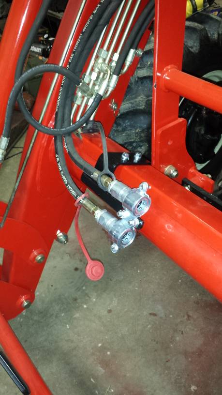

Double breakaway coupling clamp -- anyone using them?
Where and how do you mount it?
The EA grapple comes with one male and one female. I guess I need to change out one of them.
Just to clear, a double breakaway coupling clamp holds the quick connects in place. My W.R.Long 3rd function kit had a mounting solution for the quick connects to hold them in place. If you looking for a holder for the quick connects any farm supply has them. Ted's video form EA shows laying the hoses across the front loader brace with no coupling clamp.
EA sends one male and one female so you can easily hook the quick connects up properly so the control works the same each time like Rick stated. I wouldn't want both quick connects the same.
Also when you order a grapple from EA Travis will ask what 3rd function kit/quick connects you have and supply the correct matching couplers already set up on the grapple.
   / The WICKED Root & Debris GRAPPLE!!!!!!! #2,752
Did mine with the brackets, red and black plugs, painted the grapple end connector red so It's easy to match. 20151115_211526.jpg

Right. I'm just talking a bout a clamp like the one shown here.
It seems to take three hands to connect couplers swinging around loose.
This seems like it will make it much easier to connect them.
And I was going to use a zip tie, tape or paint to identify which two mate.
That is a clean installation Helitech.
