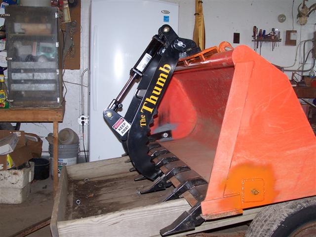

442128d1443459981-thumb-bucket-forks-buthumb-jpg
I think my needs are similar to yours. I don't usually need to CRUSH stuff, just need to hold onto it just enough to drive to the burnpile. The everything attachments stuff looks awesome but I'd want it to be quickly removable leaving the bucket normal (and restore normal lift capacity (which isn't much). I'd make it to work in the bucket, or extended to work with brush forks, but thats all custom work.
The thumb looks like a good unit. Appx $350 for thumb & $150 for the mounting hinge, plus whatever hydraulic control valves you need to add.
Here's the thumb website. Shop Online

I bought the 32" thumb with 2 base plates. Mounted one base on the bucket and one on the forks.
I use the forks more than the bucket but its nice to have the option to switch.

After using my forks last week to move a big poplar that had fallen across the fence I realized how useful a grapple would be to help move everything that was either broke or sawed. The forks were good but a thumb/grapple would have made it a lot faster.
I already have the Piranha Tooth Bar on my bucket so that will help if I decide to go with my bucket.

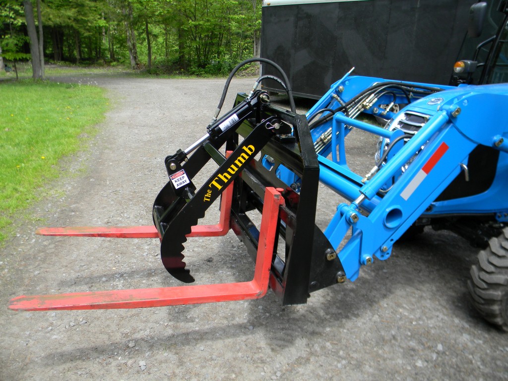

George- Funny that you posted here because these pics just came up on a search just now. That's a good looking install you have there and hopefully will give me some ideas on my pallet forks.

Anyone else have pics of "The Thumb" mounted on their pallet forks? There's gotta be more of them out there.
/ "The Thumb" on bucket or forks? #12
With pallet forks on loader and with smaller pallet forks on Ventrac front hitch.

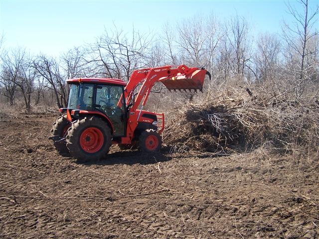

/ "The Thumb" on bucket or forks? #15
My set-up.

My modified Titan forks with a greens machine thumb, inspired by another member on this site
/ "The Thumb" on bucket or forks? #18
Thanks for the posting. Nice work on your fabrication.
