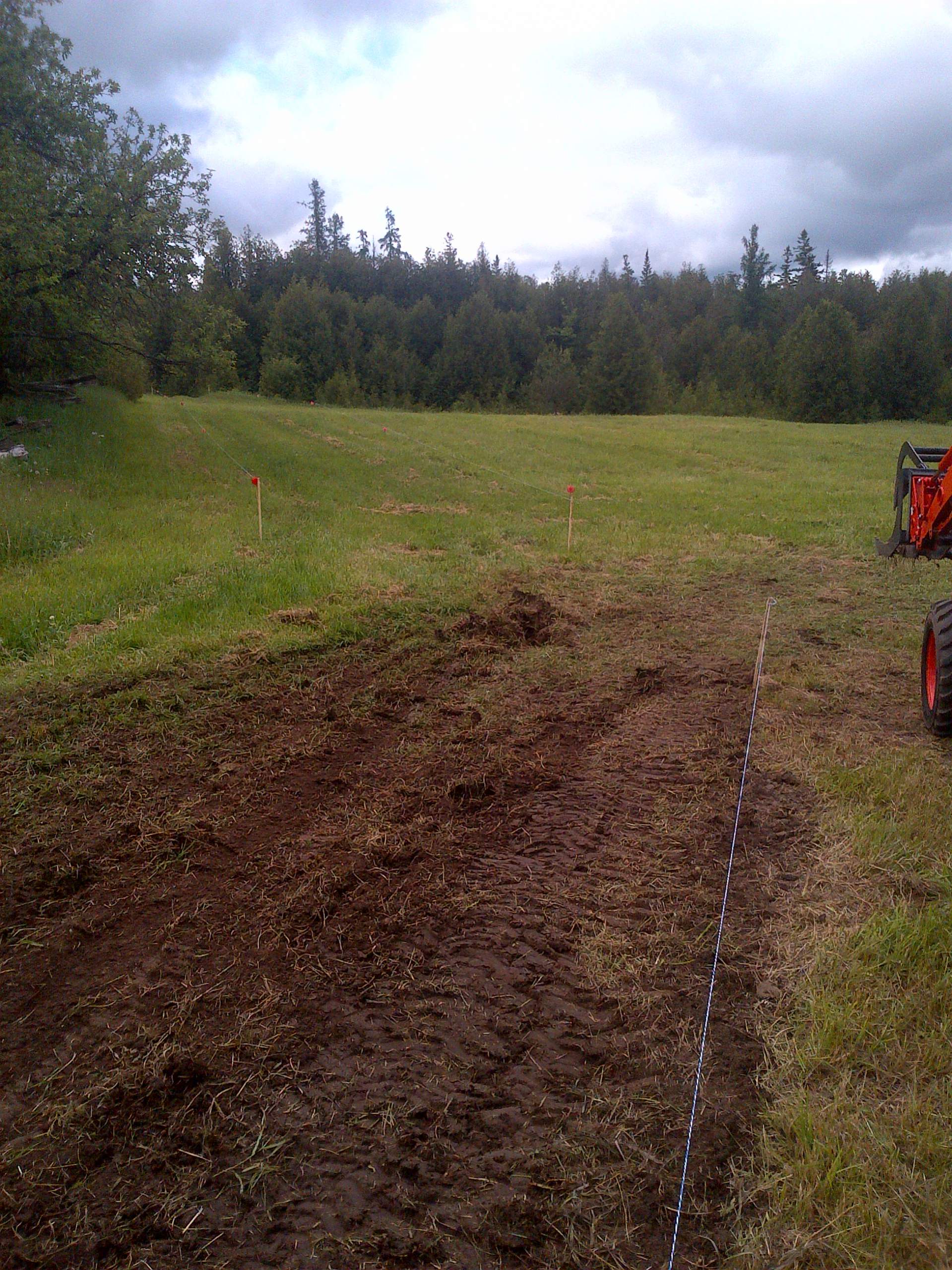

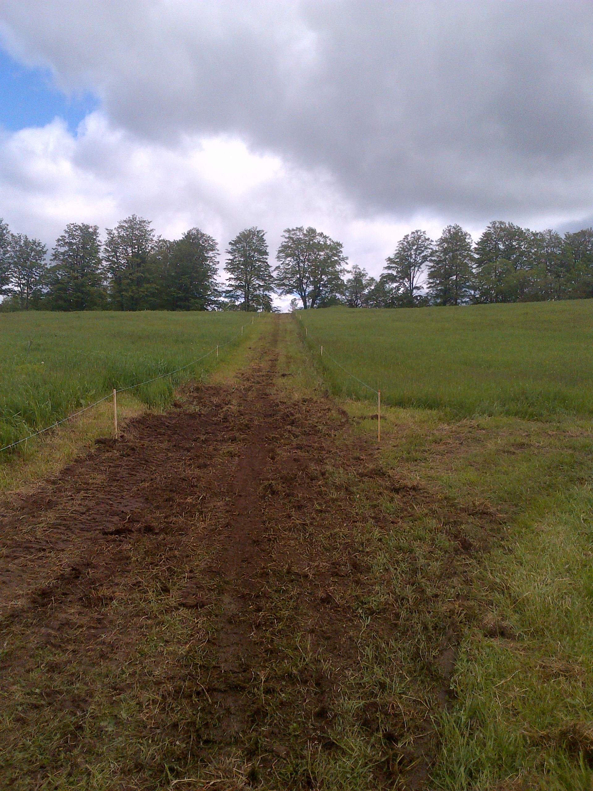

I started the summer weekend job on my property and the first project on this year is to put a 700ft driveway from the entrance gate to the site of the future house and barn. The driveway will have a portion of 250ft on a small hill with approx 8-10deg slope. I used so far my tractor with the box blade to dig out around 2" of soil; it is a hard soil and very compact, so I'm planning to remove just 4" of it. I"l use the 200lb geotextile material and then compact 6 of gravel. Do you see any potential issue here? I checked in one spot how deep the soil goes and just after 18" I found some layers of gravel/sand. Here are some pictures.

I was thinking to dig more but my concern is to not transform the driveway in a long French drain (French drain - Wikipedia, the free encyclopedia) and also keep the cost and time down. I almost spent more then 30 hours just to dig and haul 4" of soil.

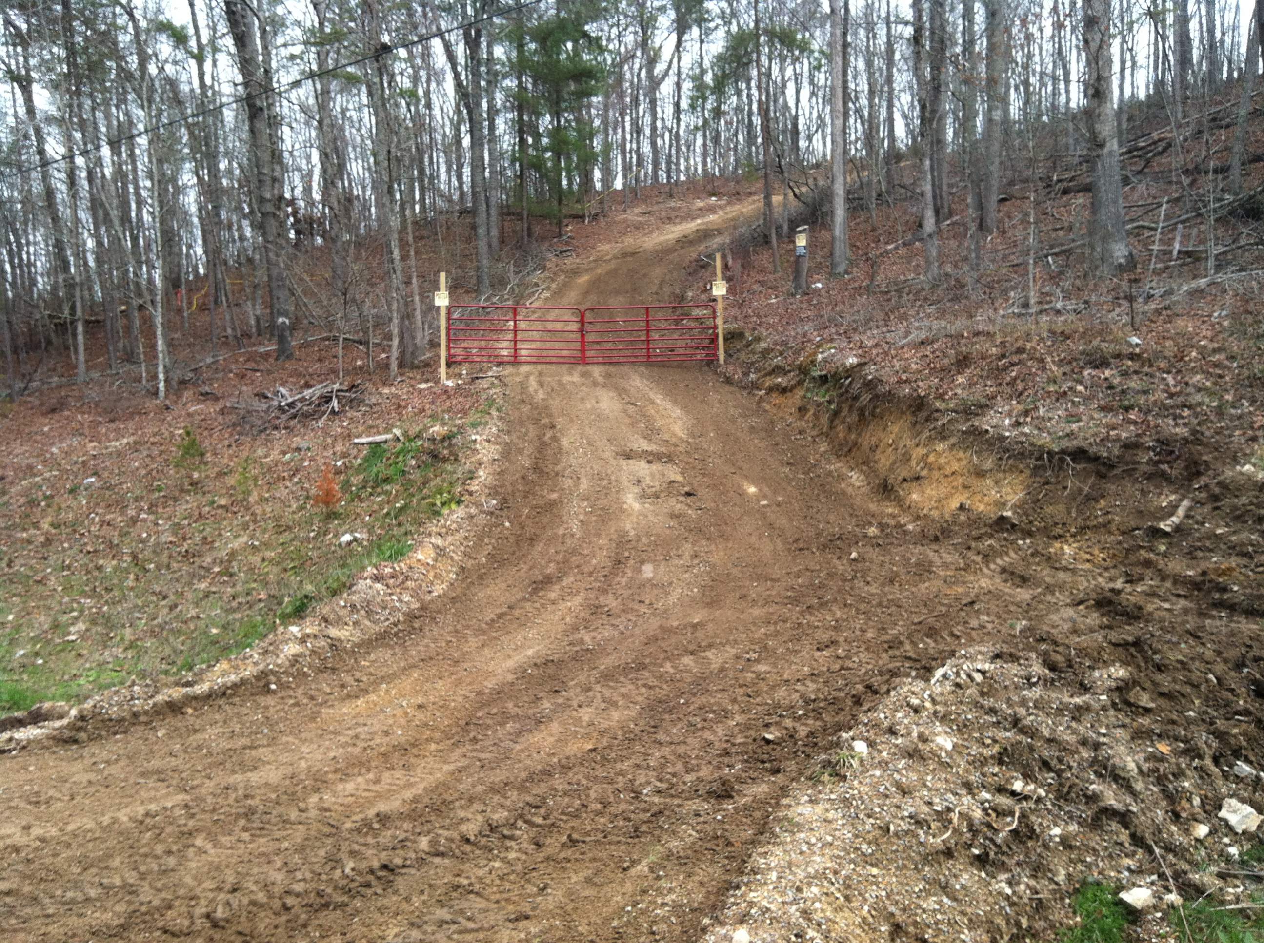

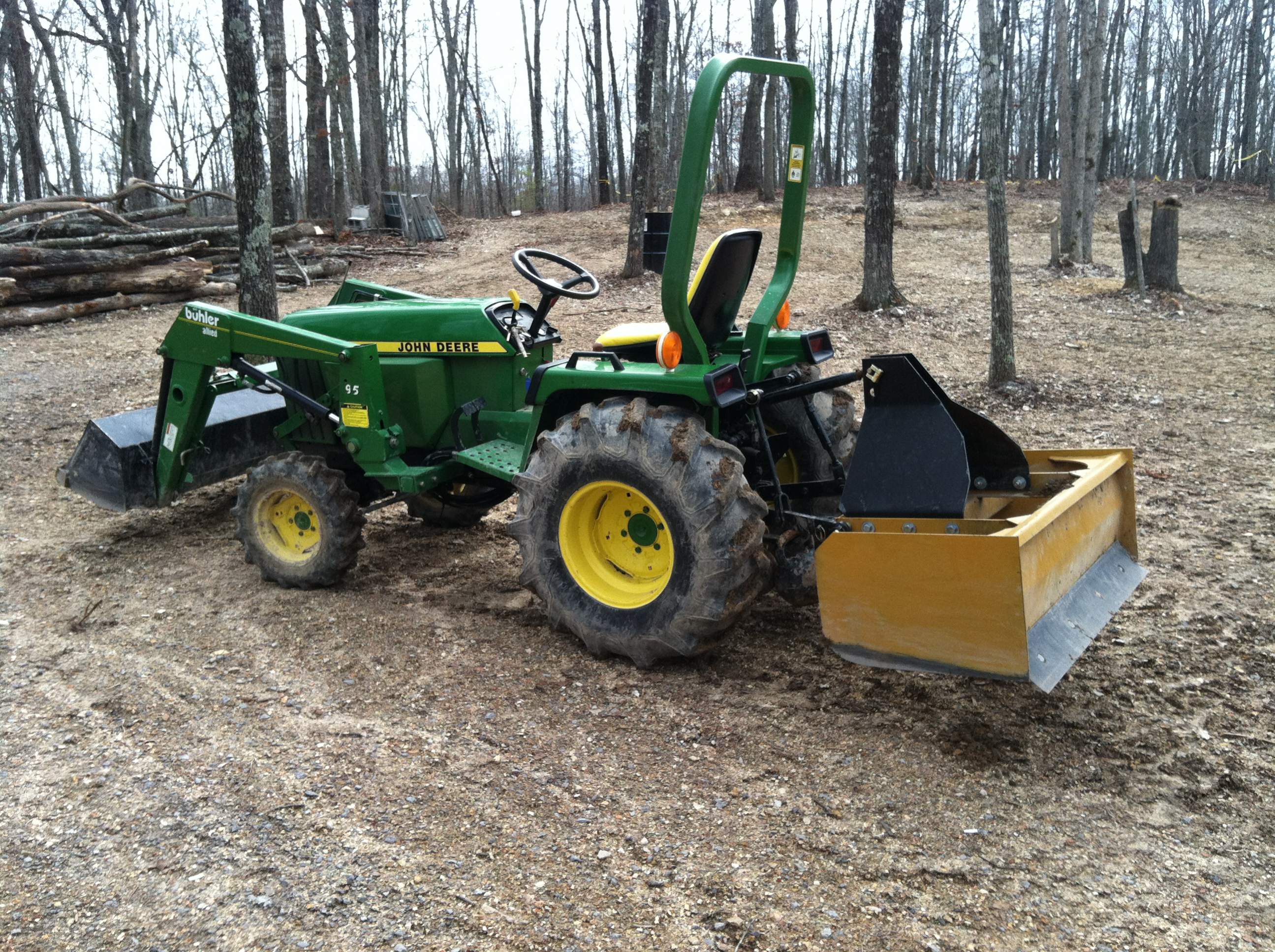

Dig the ditches before you lay gravel and lay a layerof gravel in the ditch to slow runoff/erosion ,Everything attachments has a video on how to adjust your box blade to trench the sides of your drive , I wish I had a flat field to build my driveway I had to go up alot more than 8-10 degrees and built it with a little John Deere 855 and cleared the trees and roots first 011.jpg008.jpg

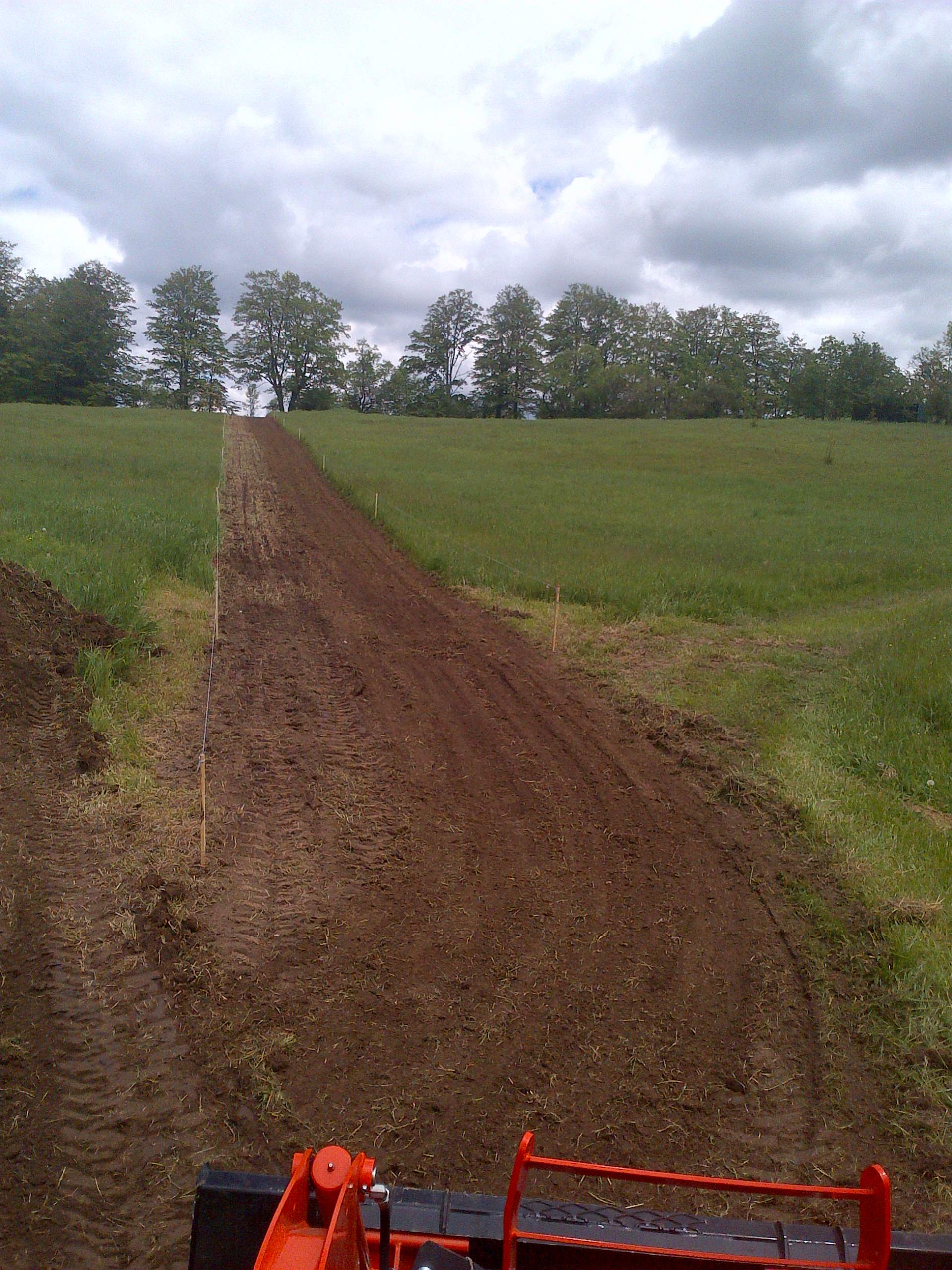

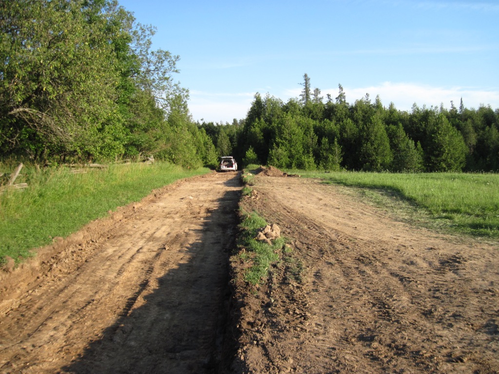

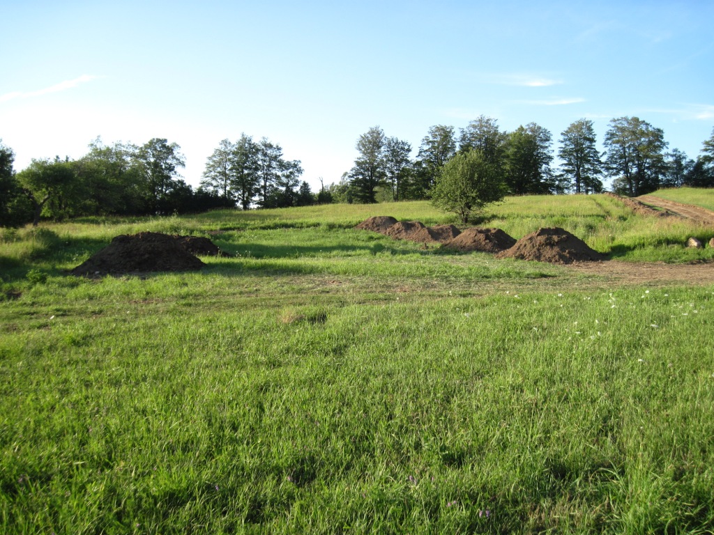

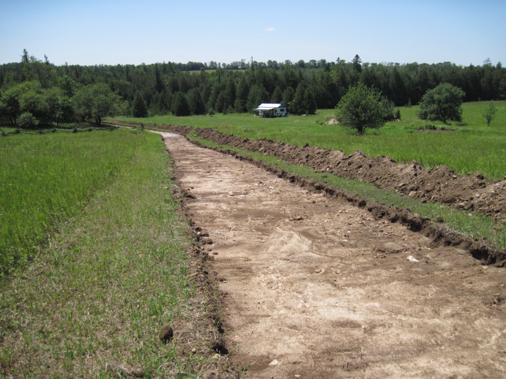

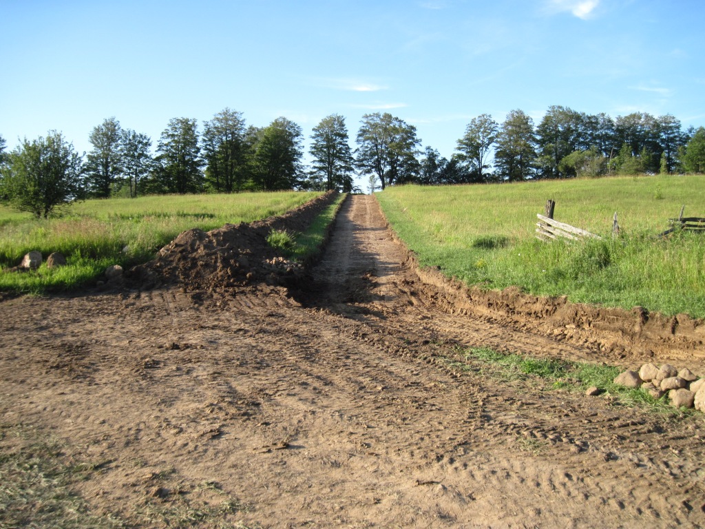

Just a quick update of the project. Taking the good advice from you guys I asked my neighbour to came with his toy and dig out the entire top soil. He worked for all day digging out 12" or more in some spots, so now the driveway is ready for the geotextile and gravel. Also, I got a quote for gravel (up to 6") at 5.5$/tone delivered.
My son is very happy as he already started to laydown the trailer bike with soil removed. I attached some pictures for reference.

You sure have some beautiful land. And so much dirt!! My drive is a mile long and may have as much dirt as in one of the piles -thumbnail, far right. I have rock & gravel resting on basaltic lava. Makes for interesting drive construction and maintenance.
/ The new 700ft driveway #14
Looks good. Got any side ditches in mind? Or will you keep a trench for water.:)

Yes beautiful looking land and by the way... where are the rocks???
