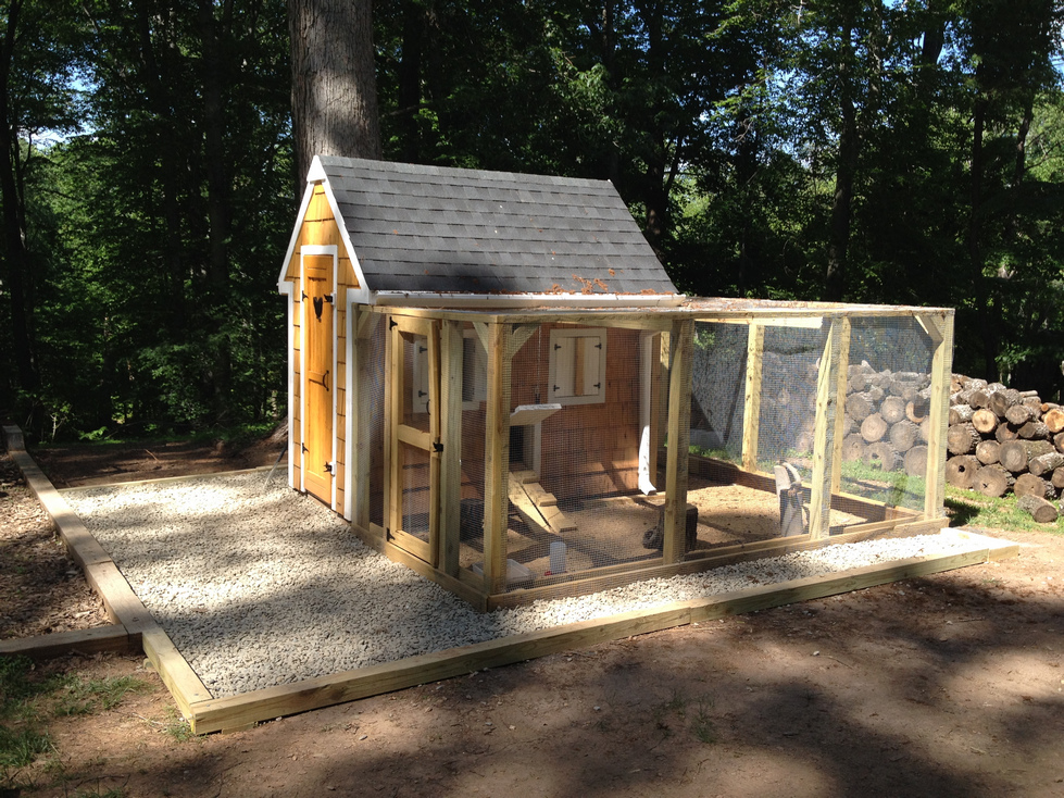

For anyone interested, the final all-in cost of the Chicken Palace ran me right around $1,700. I had a LOT of framing material and some sheeting left over from other projects, and if I add that in then it probably would be a good bit more, but still probably less than $2K all-in.
The largest single expenses were the shakes and the wire mesh. The shakes were TOTALLY worth the extra cost, though. I really like the way it turned out, and the neighbors seem to think is says "shed" much more than "chicken coop" so they seem happy.

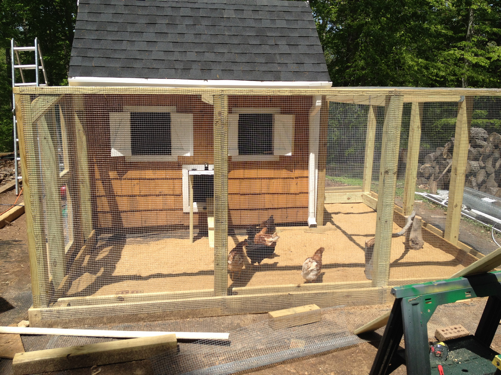

The proof is in the pudding as they say... this fox tried to get into the coop for weeks after we built it, but now he's just given up. When I see him on his morning walk-abouts, he just walks right past the coop and the chickens don't even squawk anymore. It's like the Chicken Palace has a moat. We did lose one girl to a hawk while they were free-ranging one day, but so far the coop has been fully predator proof. <img src="http://www.tractorbynet.com/forums/files/projects/416911-chicken-palace-fox-jpg"/>

Yep. Still glad that I made it so that it can be moved. The fenced-in run is easy to pull away from the coop if we need to since it is built as a stand-alone unit, so I can still get the pallet forks under the coop to move it if necessary. It wouldn't be easy, but it's at least possible. Plus, since it's not on a permanent foundation it still meets the requirements to be a "shed" in our area. Technically, if I had dug a real foundation, I would have needed to draw up plans and get them approved... part of the cost of doing business in our somewhat left-wing, over-regulated northern Virginia area. This way, it's still a perfectly legal "shed" and not a "permanent structure."
Actually, I've already moved it a bit. After we put in a big raised-bed garden (multiple beds, full drip irrigation system -- I should post that project sometime) next to the coop later that spring, we realized that the lines were off just a bit when we looked at the backyard from our upstairs window. It just looked the SLIGHTEST bit crooked and off-kilter. So, I took out the 8 screws connecting it to the run, nudged it into alignment with the tractor, reattached the run, re-raked the gravel and we were good to go.

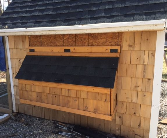

Very nice. Can you post a picture of the side with the laying boxes? (or did I just miss it). Thanks.

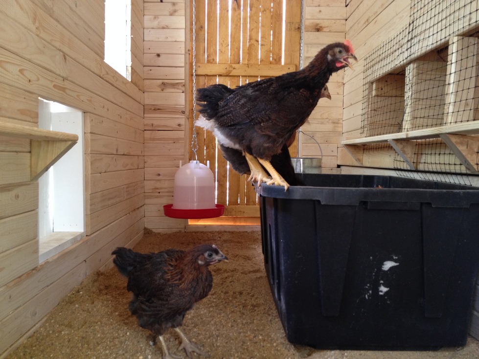

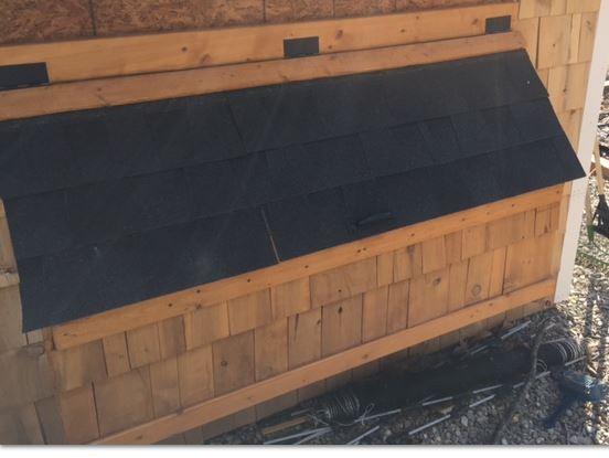

Thanks. I forgot about the nest boxes... here are a couple of pics. This was built as a single unit and attached with a few screws, so it can be easily removed if we convert from "coop" to "shed" in the future. I still have a row of shakes to put on above the boxes, so please ignore my laziness. Ran out of shakes and never got around to finishing it last summer...
The top is hinged and is lifts up to give access to 4 full size nesting boxes -- MORE than enough. All of our girls use the same box for some reason.

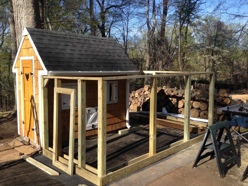

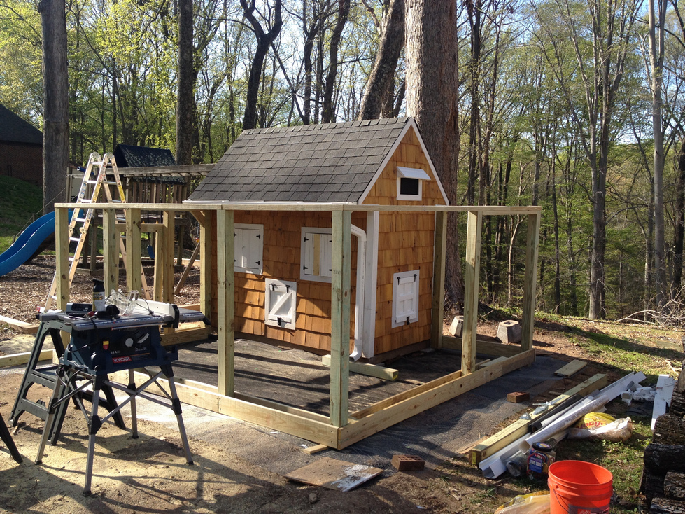

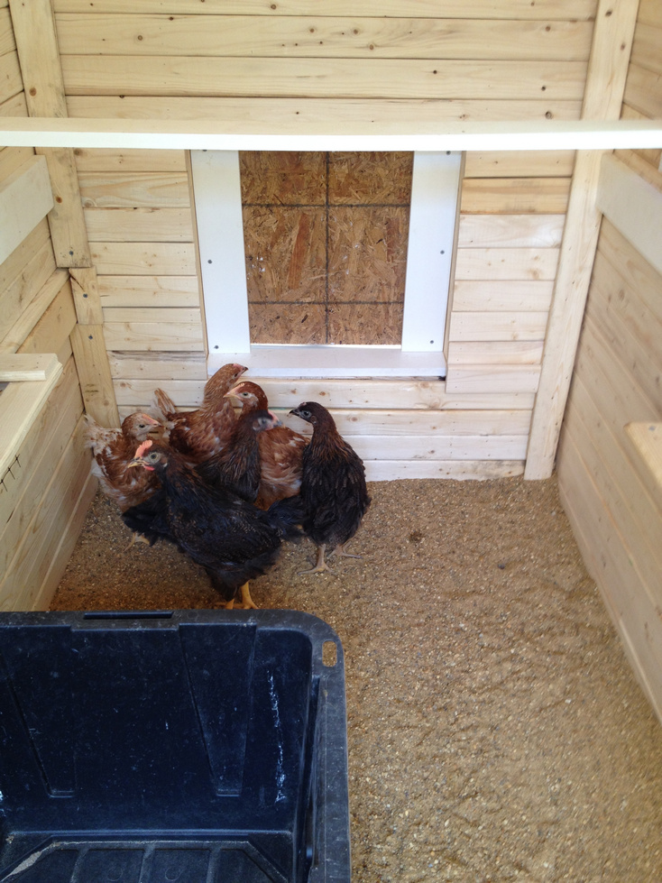

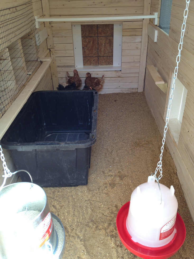

Since spring doesn't seem like it wants to show up here in Northern Virginia, I thought I'd post about last spring's first big project -- building the Chicken Palace. It all started with a family trip to Tractor Supply during Chick Days... before I knew what happened, we had added to our brood and it became clear that our little chicken coop wasn't going to be enough for our expanded flock.

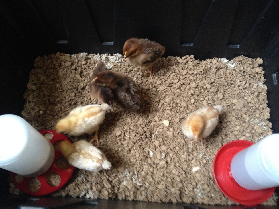

First, we emptied out one of my old storage bins, hooked up an infrared light to keep it warm, and life was good:
It was the perfect size -- my littlest boy could still see them and play with them, and honestly, it was kind of nice hearing the "cheep cheep cheep" in the corner of our family room.

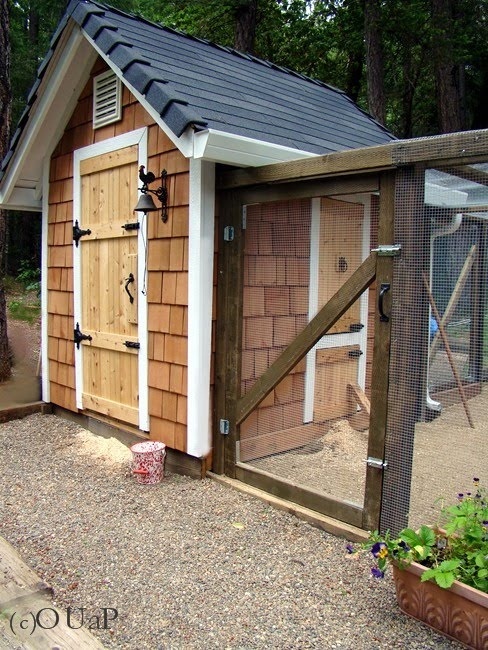

But we knew this little box wasn't going to work for very long, so we started planning for a slightly larger coop. Honestly, we weren't sure how long we would keep chickens, so I didn't want to build a fit-for-purpose chicken coop, but rather something that we could use for something else if this whole "chicken farming" thing didn't work out... so I went into Sketchup and started playing around with ideas. After a few tries, I was confident that I had figured out a dual purpose "first it's a chicken coop, and then it can be a garden shed if we don't like it" design. My original inspiration was a picture I found on the web:
After all was said and done, our "slightly larger coop" turned into our "massively over-engineered multi-purpose Chicken Palace." I really do need to learn when "good enough" really is good enough...
