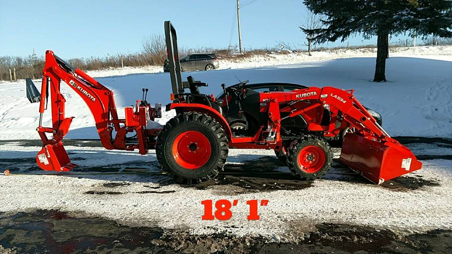

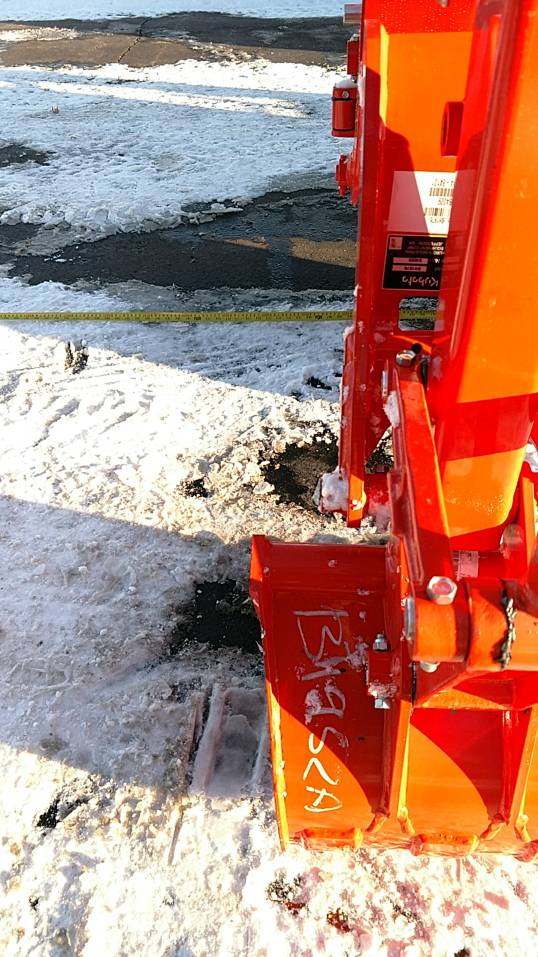

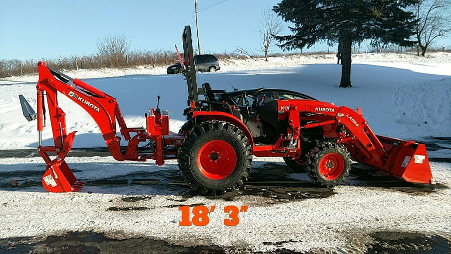

I did check total length of the B2650, bucket flat and bucket rolled in tight.View attachment 537914View attachment 537915
Perfect. I was going to ask for this measurement, but you beat me to it!

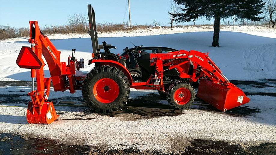

I'll have to actually measure my garage door opening for you but I know I only clear by about 3 to 4 in..
I can also tell you that if you kick the backhoe completely sideways 90 degrees to the Tractor you can compress to an overall length of 14 ft 7 in. 3663.jpeg3667.jpeg
I can also tell you that if you kick the backhoe completely sideways 90 degrees to the Tractor you can compress to an overall length of 14 ft 7 in.View attachment 537919View attachment 537920
RC, with yor backhoe turned sideways, how wide are you? I am lookin at a B26 and need to haul it on 16ft trailer. I hope I can balance it length wise, maybe put bucket in pickup bed. And twist the backhoe. Inside of trailer between sides is about 80". Thanks, Jon
/ The B2650 count down has begun!
#150
Jon,
Correct me if I am wrong, but I think that you would want the distance from centerline to the swung backhoe bucket? I can't imagine that you would haul the machine with the entire machine moved to the extreme left on the trailer and the backhoe swung to the extreme right? I can get you both total width and centerline to outside of backhoe, that way you can ponder it.... But I think that you want the machine at least reasonably close to centered left/right over the axles so that the load is more stable?
/ The B2650 count down has begun! #151
Jon,
I think centered load would be best, forward/back and side to side, along with proper tongue weight. However, if swinging the backhoe over to one side would allow me to get the B26 home safely from the dealer on my trailer that would be great. Dealer says I should be able to load it on a 16ft trailer, but he has not seen the trailer. If I can not load safely, he would have to deliver it. Thanks, Jon

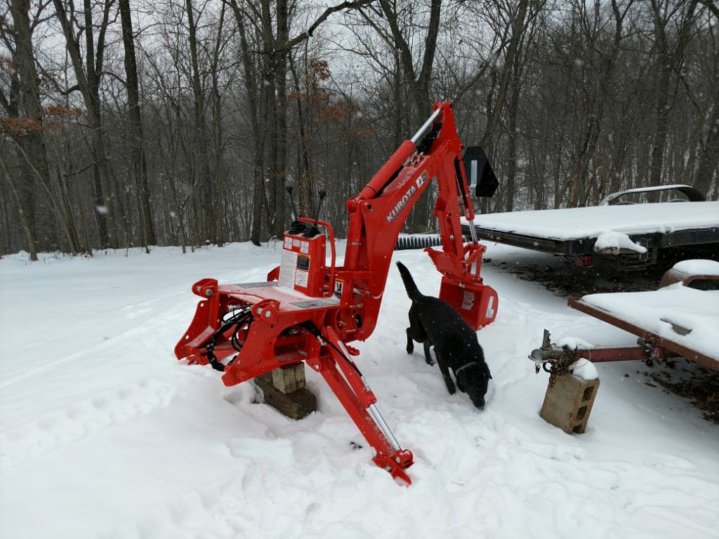

I finally decided to get risky and take it into the woods in the snow so that I could test the backhoe. Coming from a BX in which the backhoe on that machine was very disappointing. So this is what I will say I noticed right off the bat with the B2650 backhoe that is part number BH77. The BH77 curl force is insane compared to the BX. The BH77 outermost boom pulling that bucket towards you is also insanely powerful compared to the BX. No the first boom off of your pivot point does not have quite as much raw power as I expected it to have. I can use it to pull the front bucket and wheels off of the ground but it is a slow steady pull lifting the front end. On my BX with the hydraulic system turned up, I was able to snap the front end into the air almost Dangerously. With this b2650 and the stock Hydraulics I would say that it's likely much saferand, and also probably overall much more powerful, but with a much heavier machine. The bottom line is that I am able to dig much more much faster with the BH77, and there is no doubt that I can curl through and rip roots with the BH77 that the Kubota BX series just stood no chance of doing.IMG_20180202_100914504_HDR.jpgIMG_20180202_100930562_HDR.jpgIMG_20180202_101620214_HDR.jpgIMG_20180202_101649040.jpg

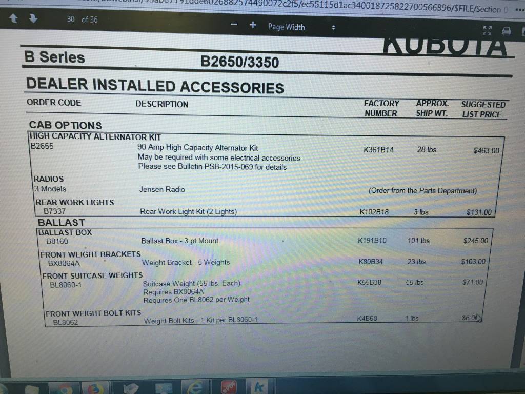

Dan,
Sean just quoted me at $525 installed for the kit that is now a 90 amp alternator. I would discuss this with your dealer while your waiting a week... If your like me and you plan to light up the night... 14.5 amps is a mean joke.
