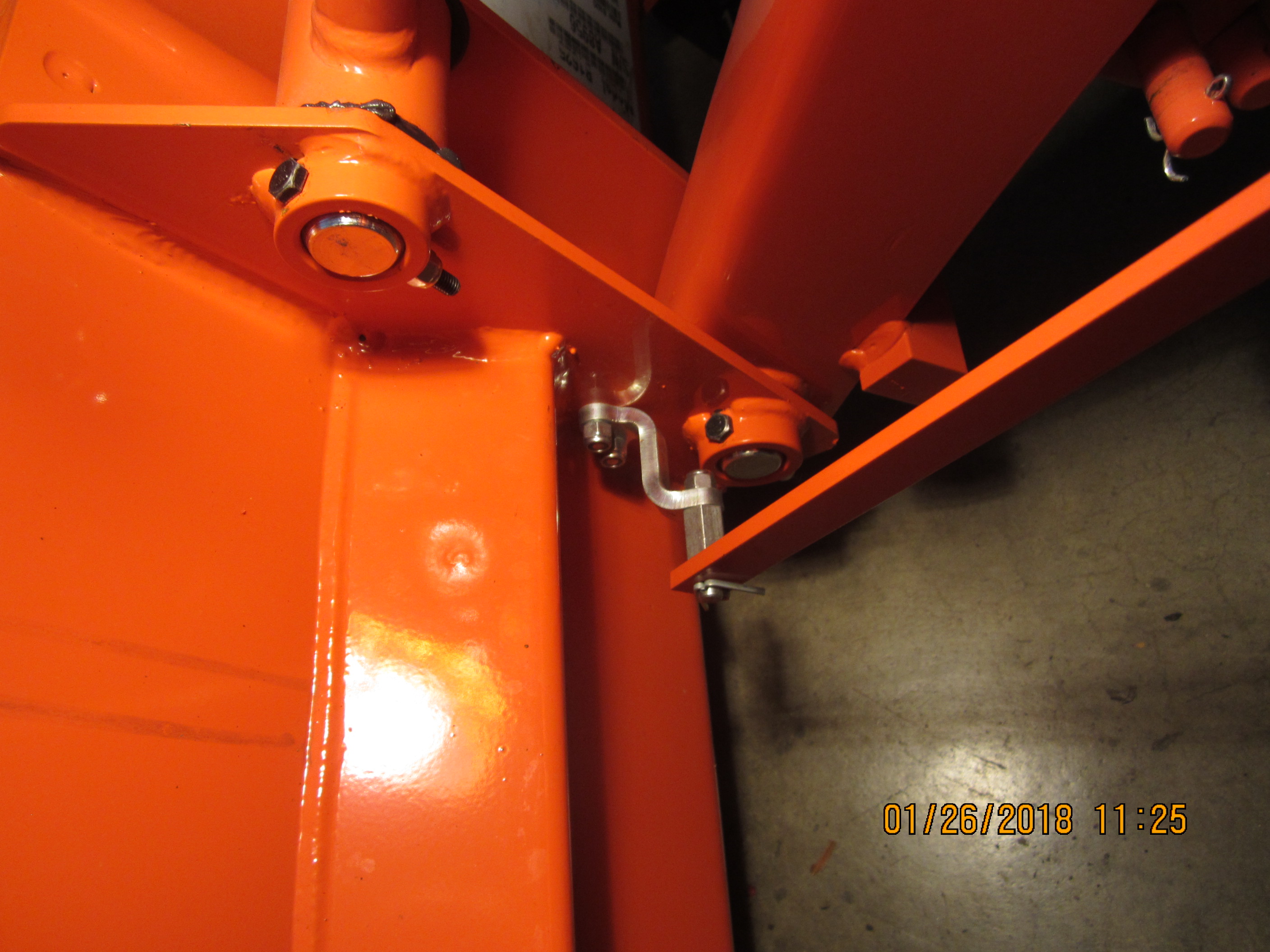

Thanks Gents,
I just got home from watching the Eagles stomp the crap out of the Vikings. Congratulations Eagle fans.
Your picture and videos gave me the answer. My indicator does nothing because I have the standard bucket...i.e. there is no place to install that lower lever to the bucket. Why would the dealer deliver such a feature which is inoperable on this model? The mechanic simply zip tied the lower lever to get it out of the way

It's all metal, can't you weld a nut or whatever you would need to the bucket to attach?

Thanks, RC. That's the answer, but will see what the dealer has to say since I'm not a welder.

If you need me to get you measurements so you know where to place the connection point compared to the pivot point on the loader arms, I can do that. Everything would need to placed correctly at that starting point to get the rod end linear motion ratio to match up with the bucket rotational motion. That is what I can see being the challenge, my bucket back wall is likely forward of your back wall because the SSQA plate is taking up space. But even that is not insurmountable with a calc-you-ma-later and an engineering degree.

Thanks again, RC. The dealer is picking it up today to fix it, along with another minor issue. May his cal-you-ma-later be as accurate as yours.:)

Sweet! You got what you wanted.

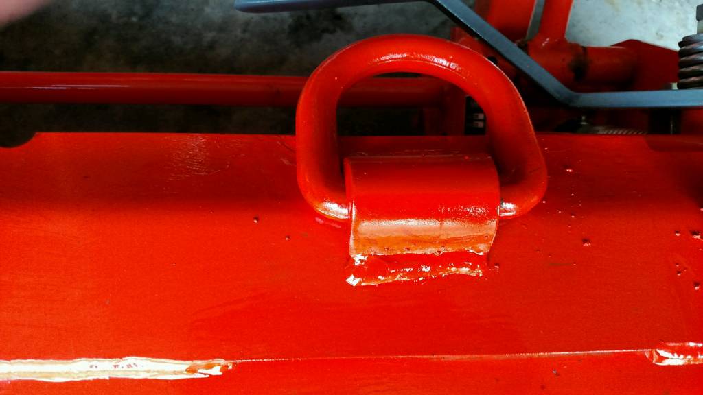

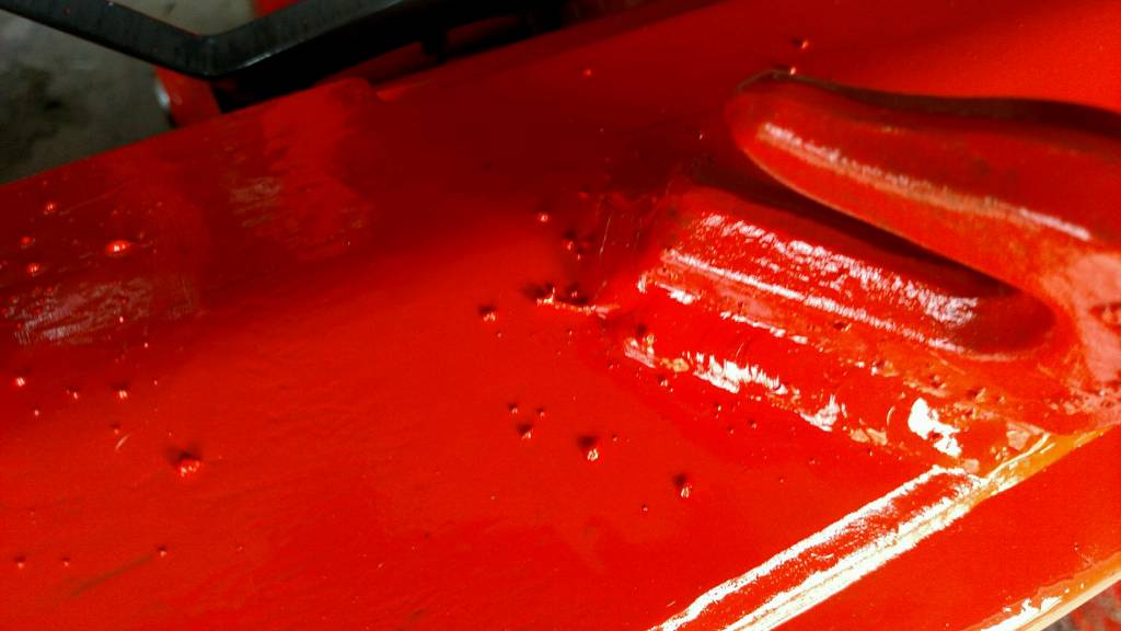

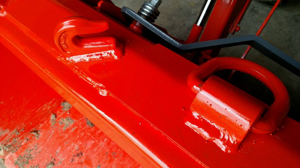

This past weekend I added large D-Rings and 3/8" weld on chain hooks.
The chain hooks will be strictly for attaching to the trailer, the D-Rings will be for lifting/moving objects.
I'm going to add 2 hold to the rear on the horizontal plate that is part of the backhoe frame, then 2 more on the vertical plates that are the backhoe subframe. That way I can chain it down with or without the backhoe.IMG_20180128_110820024.jpgIMG_20180128_124156298.jpg4158.jpeg4162.jpeg4164.jpeg

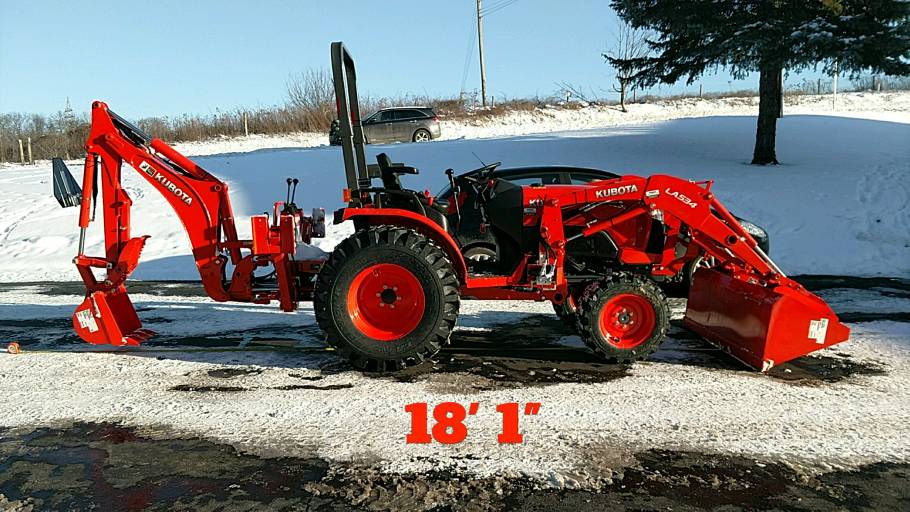

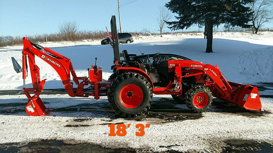

Are you getting spacers behind the 15" wide as well, or just doing the rims and tires? I did the spacers, my sidewall to sidewall width is 60.5".
I did check total length of the B2650, bucket flat and bucket rolled in tight.3657.jpeg3658.jpeg

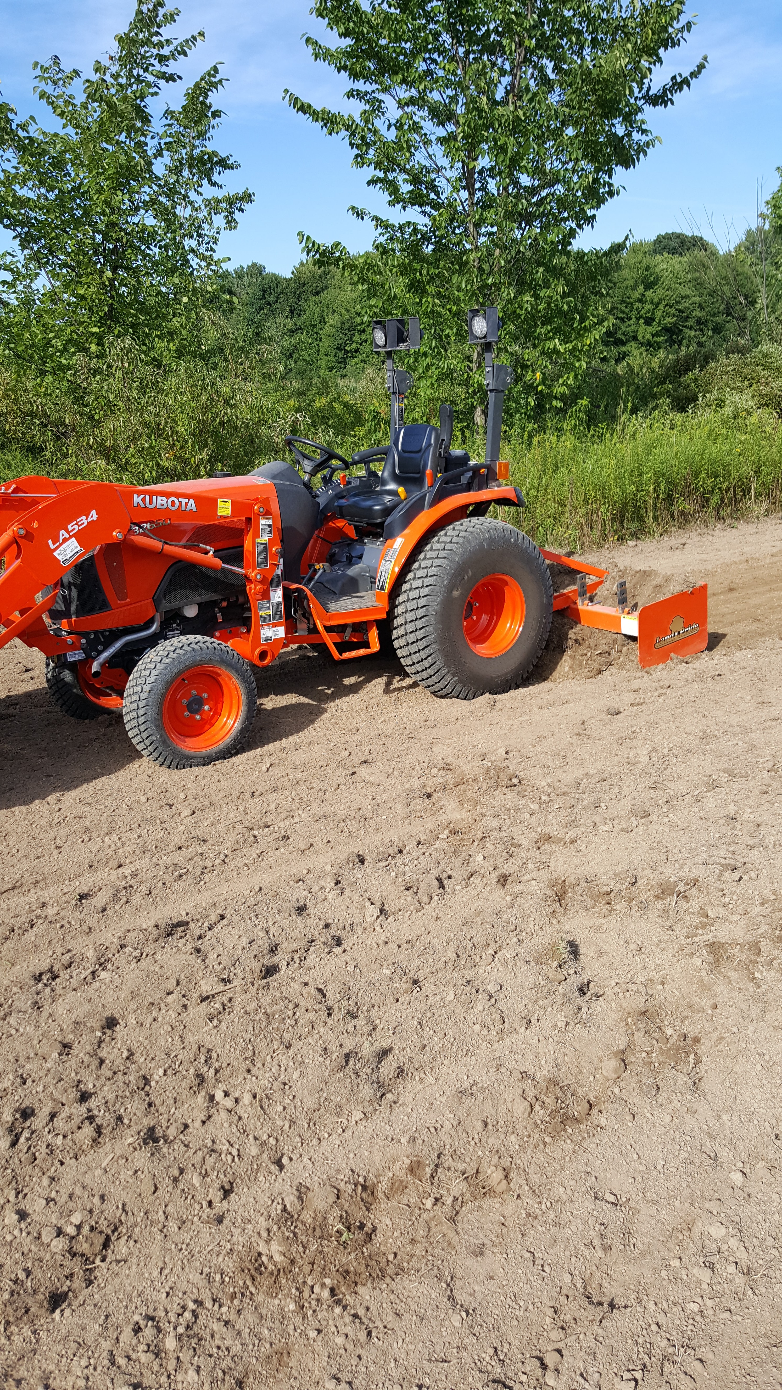

I back blade plowed snow when we got a heavy/wet 8" a couple weeks ago and just used mid range. There was zero stress on the transmission in mid range. I was using a 72" blade.IMG_20180118_144232765.jpg
