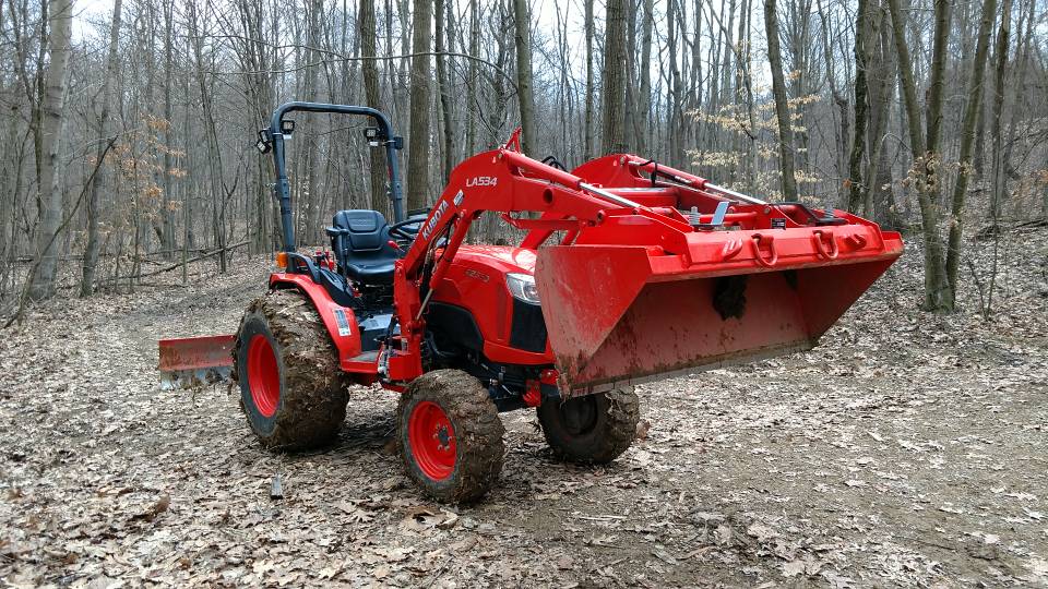

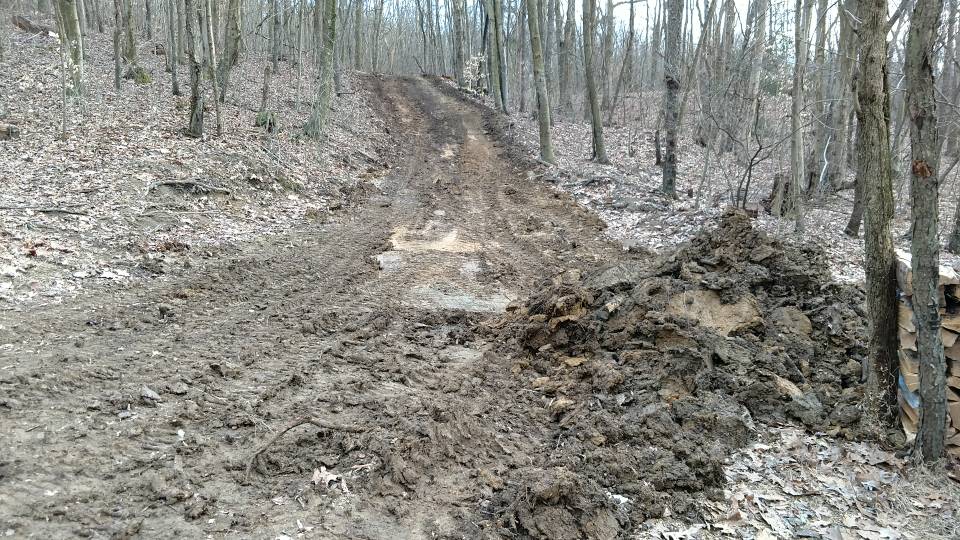

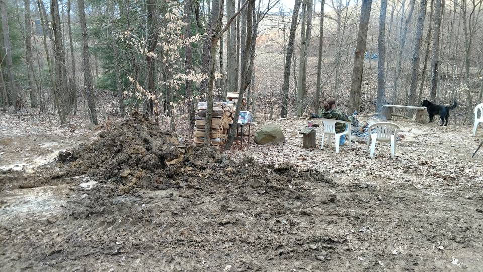

Finally, we got a few dry days and I got the B2650 down into my property to start fixing trails with the rear blade. The R4 tires (at least this big of them) isn't nearly as bad in mud as I've read. I was able to pull the blade into the ground and tear the high edges into the center rain ruts and drag some material down for later use.
My wife sat by a fire and drank beer as I (played) worked on a section of logging road. IMG_20180228_154755741.jpgIMG_20180228_173036852.jpgIMG_20180228_173059838.jpg
My wife sat by a fire and drank beer as I (played) worked on a section of logging road.View attachment 541980View attachment 541981View attachment 541982

She just shakes her head in confusion as I play with the tractor... To her, it's a waste of money and a toy. To me it's an essential part of our world being that we have 15 acres on a pretty serious slope, and that we use 8 months if the year for social gatherings.
