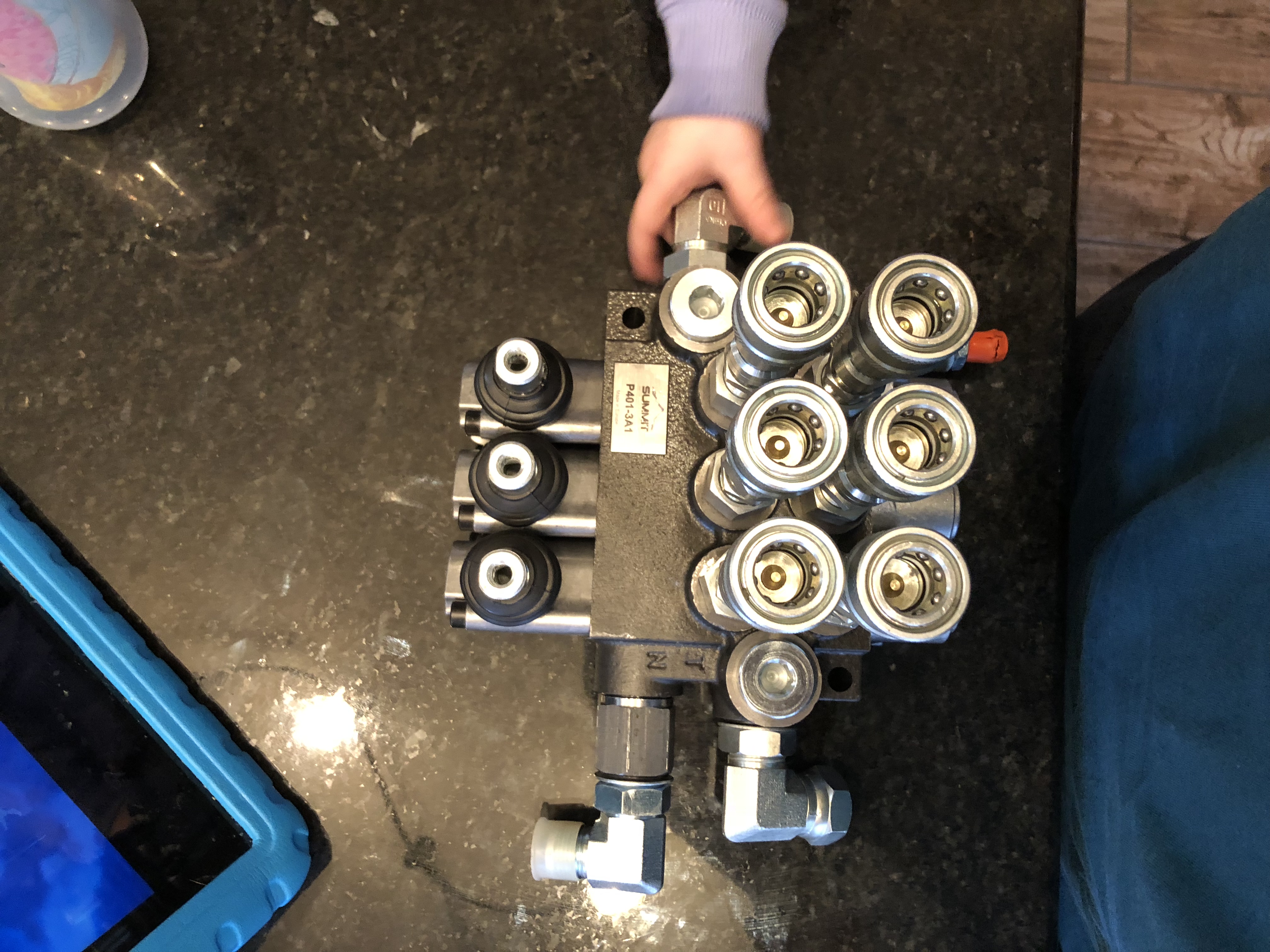

Rkidd,
It痴 very similar to the prince valve you used, except 3 spools and no float. I couldn稚 really think where I would need the float. If I find myself needing float I can add it whenever. I am not sure exactly on mounting locations yet. If I can get it in down next to the transmission I will probably have to remove the steel tube that comes factory with the 3rd function kit. I planned on having the valve in my hands a week ago to start getting a game plan together. Seller said if it doesn稚 show up tomorrow they will send a replacement out. USPS clearly lost it.

Alot of snow removal equipment. Do you guys get that much snow where you are at? Love my 66" Land Pride tiller and my 48" pallet forks, and was at my Kubota dealers today, looking for the next thing which is a grapple now that I have front hydraulics. When you get your spool valves and if you have any questions, let me know as I have spent alot of hours getting everything fit in. It really fills the space up in a hurry!!

Valve finally showed up after being lost in the mail. Got all the fittings after work today. Just need to fab up the mounting bracket and make the hoses.
Then comes making the handles. Probably won稚 get to it till early next week though.
