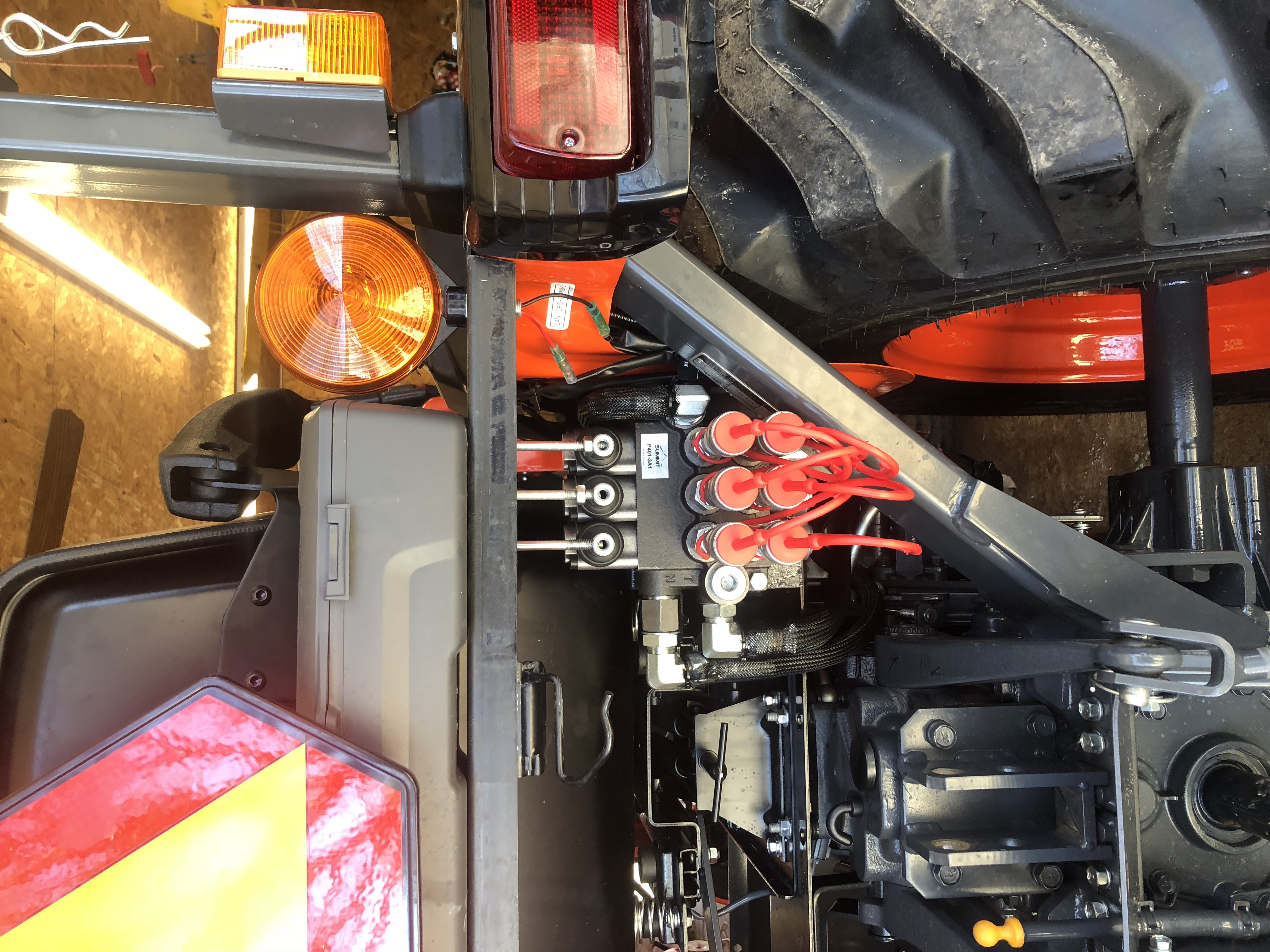

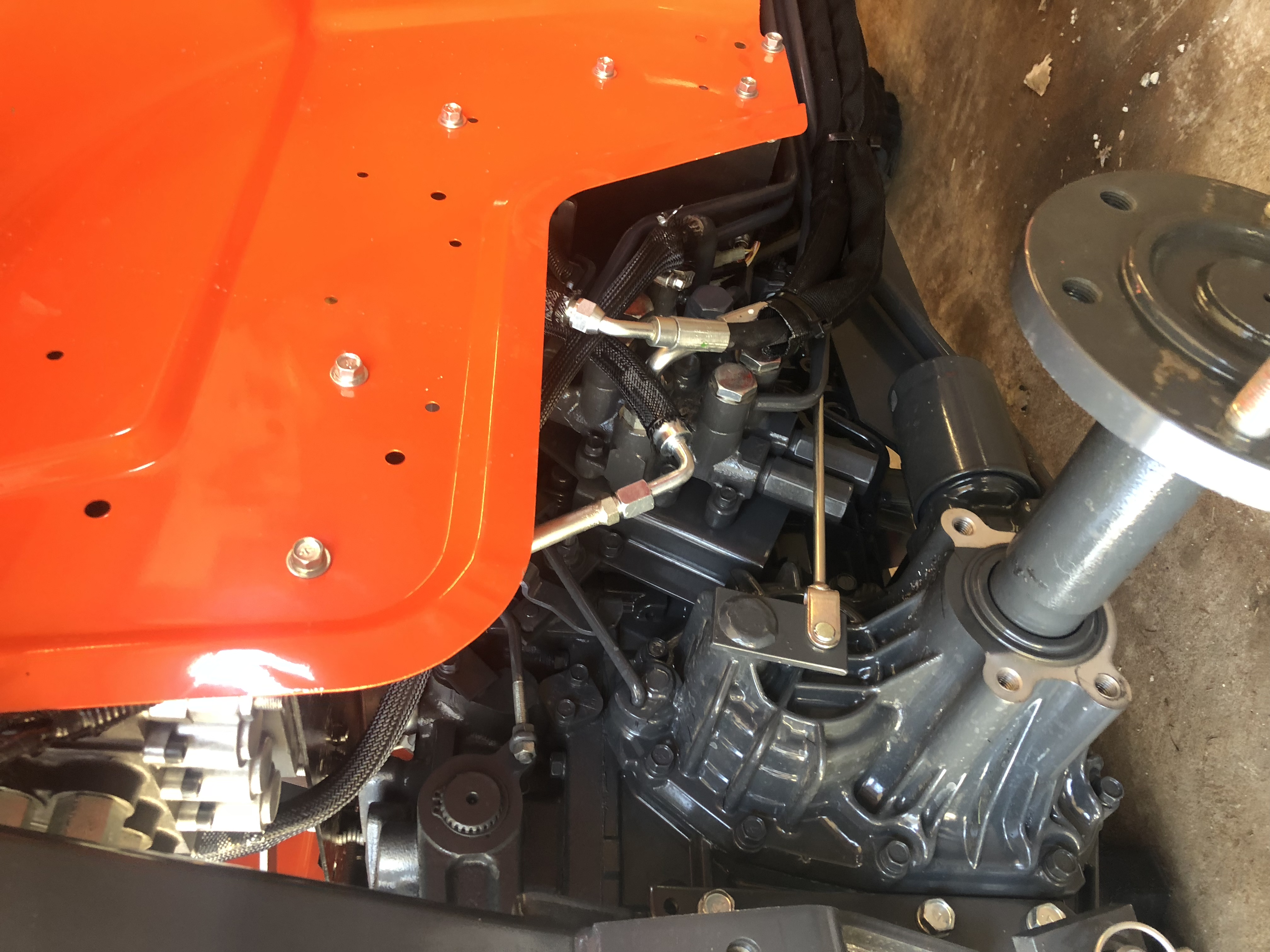

Valve is installed. No leaks. Lines don稚 look out of place and tie inline from the 3rd function valve.
Thanks Ron for the tip on the PEX 1/2 tee for the return line.
Just need to make up the levers. But it痴 beer thirty and that can wait for another day.

Man that looks super legit, I would say that that looks every bit as Factory as anything I've ever seen. You did a really fantastic job!

Way better than the 1200$ kubota option. I told my
Dealer when I seen one installed on a b3350 that I would be embarrassed to sell that.
I have 340$ wrapped up in this. And that includes 6 male ends up the couplers with dust plugs for when I find some implements.

Your are welcome Dan. Your install looks really good. Nicely done.
If you saved all of the part numbers and sources, you should do a bill of materials to help others who find this over the years. Do it with brand, part number, quantity and source for each part of your kit. That's the kind of thing that makes the internet awesome!
