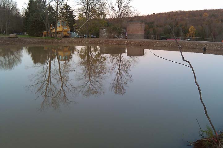

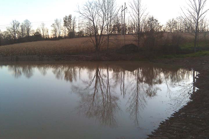

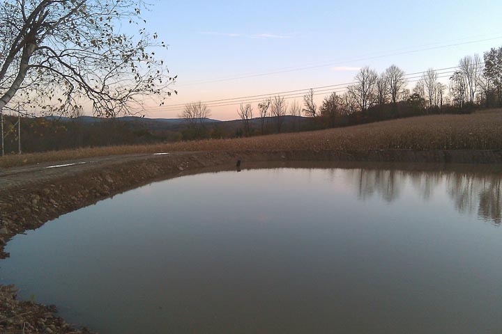

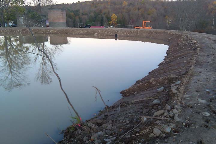

To think I would even try and dig out the mud with an L3240. :confused2:
Stay out of deep mud.
I'll be doing the landscaping now, which is well within the capacity of me and my L3240. I hope I can start the grass before the snow comes. :thumbsup:

It's funny how getting stuck a couple of times improves our foresight. There's nothing like having to step up to get off the tractor to make you realize it ain't the right tool for the job.:ashamed:
That's a very nice pond Mark. Do you have an emergency spillway or will you just rely on overflow pipes? I can't tell from your pictures. It sure looks like it is going to be a beautiful body of water, but the freeboard of your dam above the water worries me a bit since it is newly compressed soil.
/ Testing the water... er Mud #71
There's an emergency spillway near the inlet, which is opposite the dam and will flow excess water out into the field, which eventually will run into the wetland in the lower field. Three inches over the drain pipe and it'll run out the spillway.
This is an old rebuilt barn pond so while it appears to be new construction it's actually a 100+ old dam with the tub of the pond deepened and widened into the hillside. The original high sides weren't rebuilt. Except the channel cut to replace the drop pipe and drain the pond at the start of the project.
The barn fell in years ago so I buried it into itself and covered it with topsoil. Now there's a permanent shooting bench atop where the barn use to be. Nice 100 yard target with 15' backstop at target end.
Time will tell, but in the event of a catastrophe nothing is below the dam but field and wetland. I would loose a garden, that's all. Slope is to the drainage ditch across the entire field below.
Next summer I plan to put in a dock, gazebo and fire pit. :thumbsup:
If you listen really hard you can hear the crackle of the fire and the snap of those frosty cans opening. :drink:
Throw on another log and pass me a cold one. God Bless America!!!
