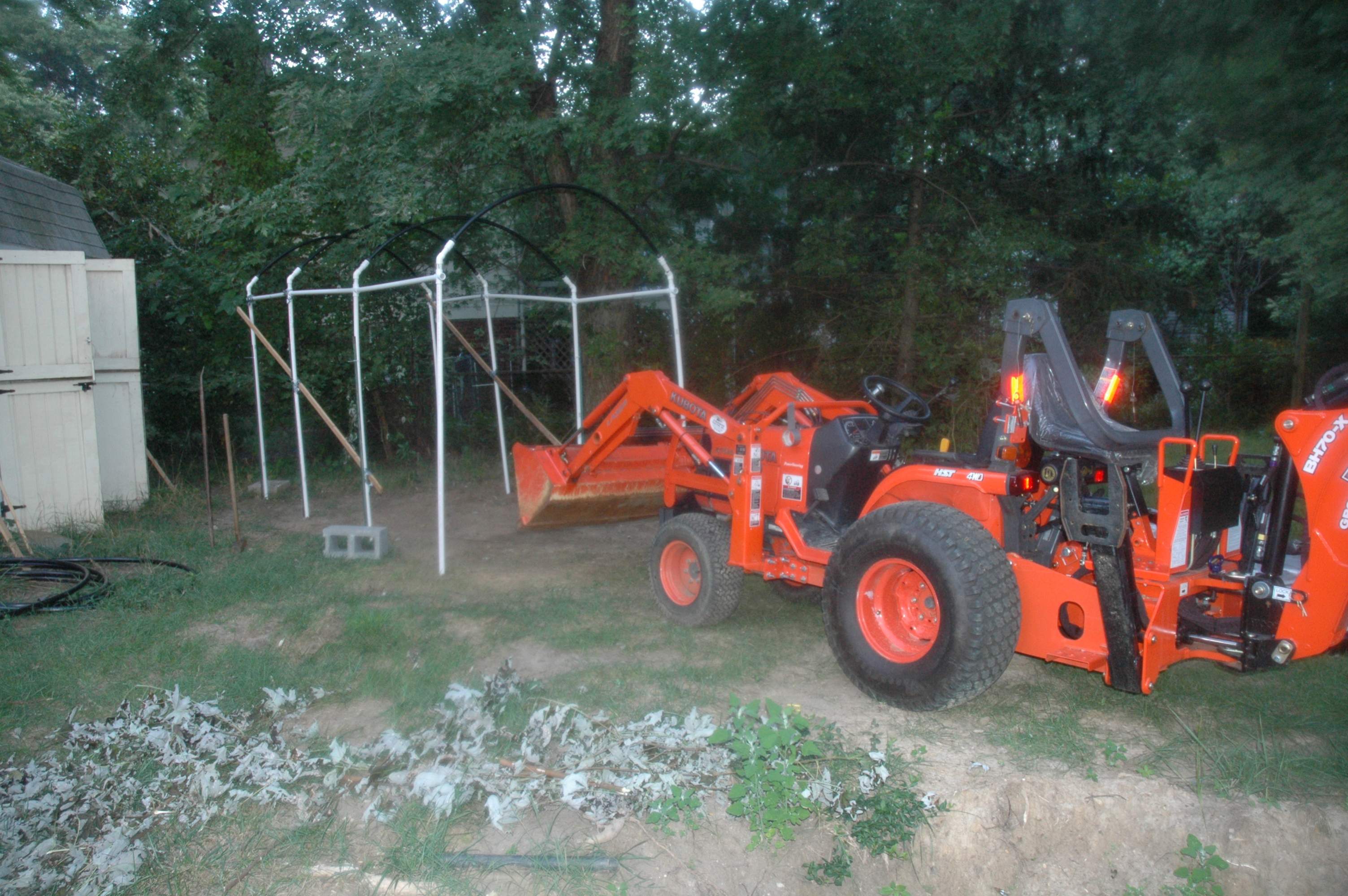

After looking over all the offerings from shelter logic and rhino I decided to wing it and build my own.
I've got trade offs between size (I don't really need one as wide as what is offered for the length I need) portability and zoning.
So I'm planning on building a "skeleton" of 1" plastic pipe held together with X or cross pieces and T's. I've spent about $50 on the connectors, will need about $30 of 1" pipe, about $20 of flexible 1" pipe, and a 30x20 HD tarp (which I already have). That with judicious application of duct tape and nylon rope and a bunch of grommets shouuld do for the upper structure.
I plan on basing it on a bunch of PT 2x6 deck boards which I'm "recycling" from a deck I built 24 yrs ago.
This will also let me easily modify it for size in the future, and move to "job sites".
If I get 'er done pictures will follow.

pics

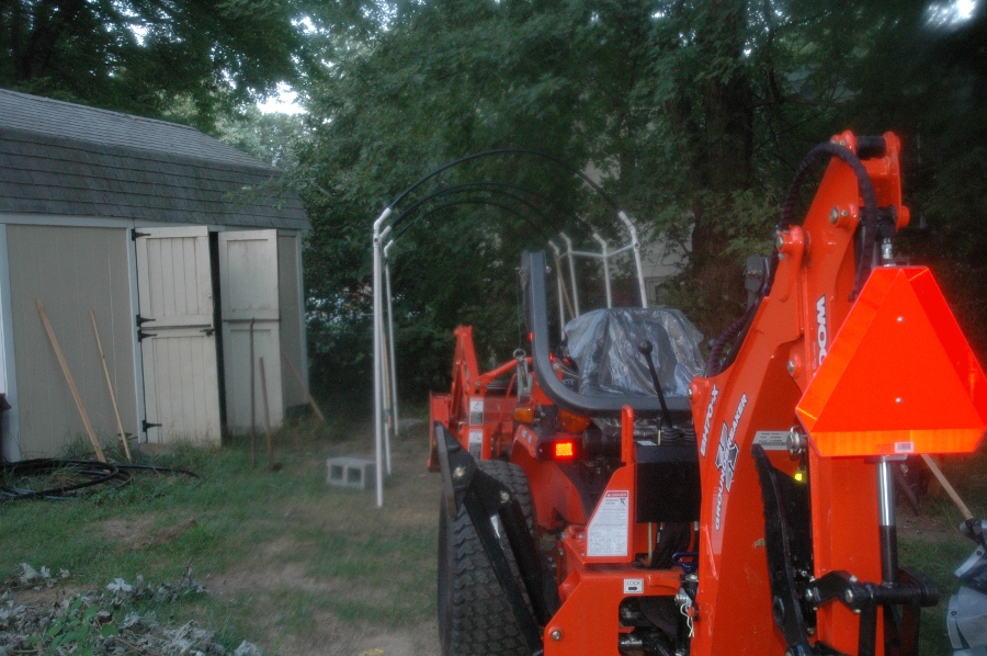

Started with base frame for size
Determined I needed more strengthening for uprights, Put in small T posts and fastened uprights to them.
More details later.

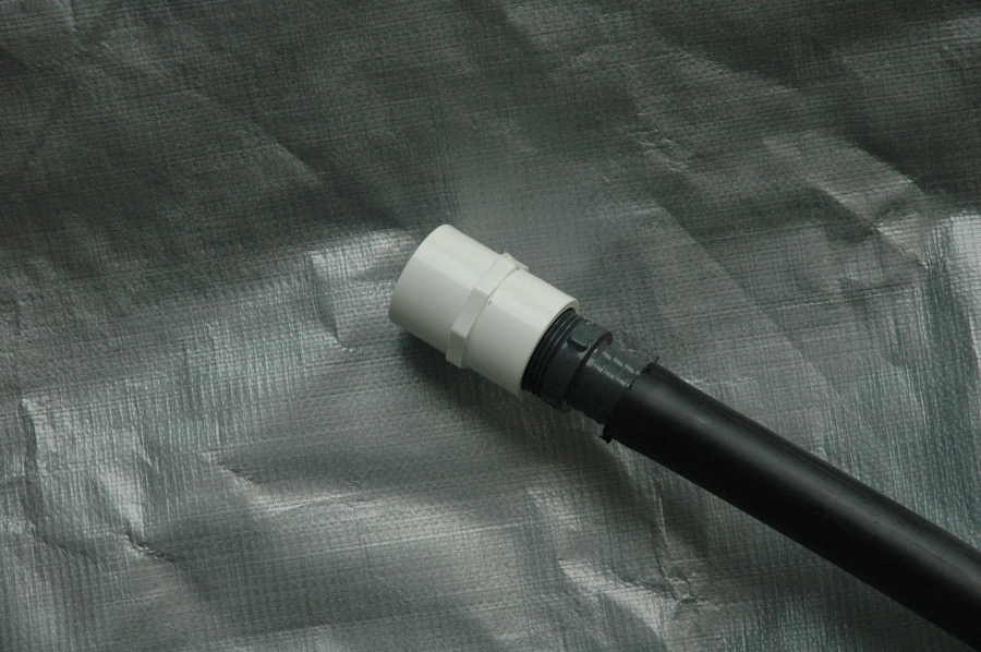

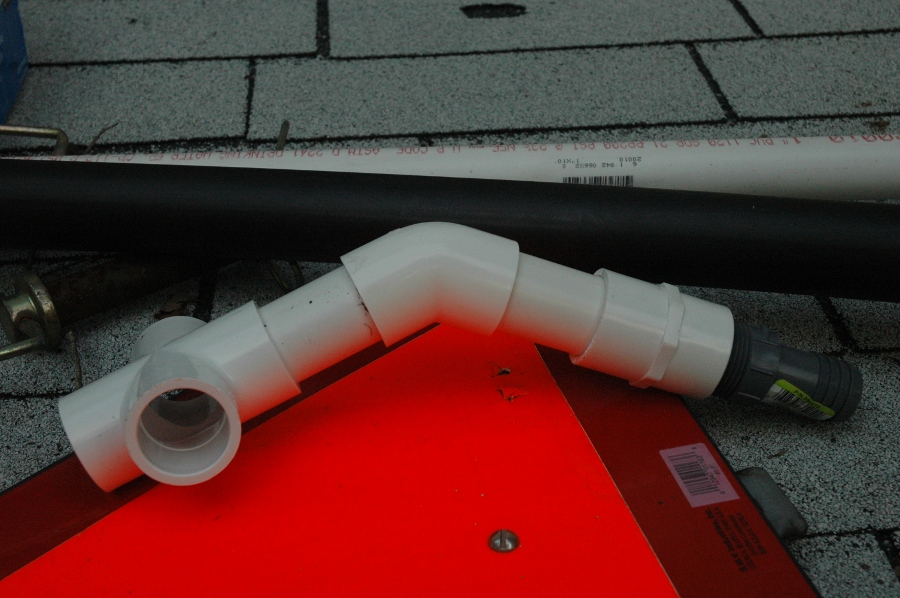

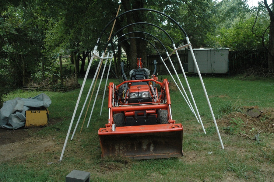

More details:
The first picture shows basically the pipes hooked together by X's on the top and pipe to pipe across (4') as seen in the second picture.
I pounded in a Tpost for each vertical member (vm).
On top of each (6') vm I put - in order a 3" section, a 45 degree bend a 3" section, a female smooth to female threaded adapter and a male threaded to male "barb" this was then hooked to a 6' section of the 1" black flexible drainage (bfd) pipe with a branch shoved up it for stiffening.
I took a maple branch about 3/4" in diameter and 3' to 4' long and shoved it up the bfd leaving about a foot to come down thru the adapters into the vm. This made the connection from the vm thru the arch much more rigid.
I did not want to us all rigid plastic pipe for the roof because I was trying to keep down the number of joints, yet hopefully withstand an inch or two of snow.
I plan on adding some more cross members to keep the pipes from pulling apart, some netting over the top to prevent sag, and some upgrades I don't know yet.

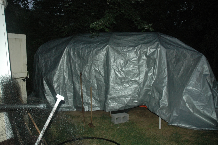

Cost so far is
10' pipes - 11@$2.20@= $25
connectors - about $30
Tarp - about $80 on sale at TSC (on hand)
10 old rusty Tposts ?? $3@ $30 (on hand)
So - the cost is about $200, comparable to the mfg units, but I'm only out about $50 from what I had on hand.
AND
It fit's all zoning regs!
Hopefully more pics to follow. but my batteries dying.
Added another 4' extension.
