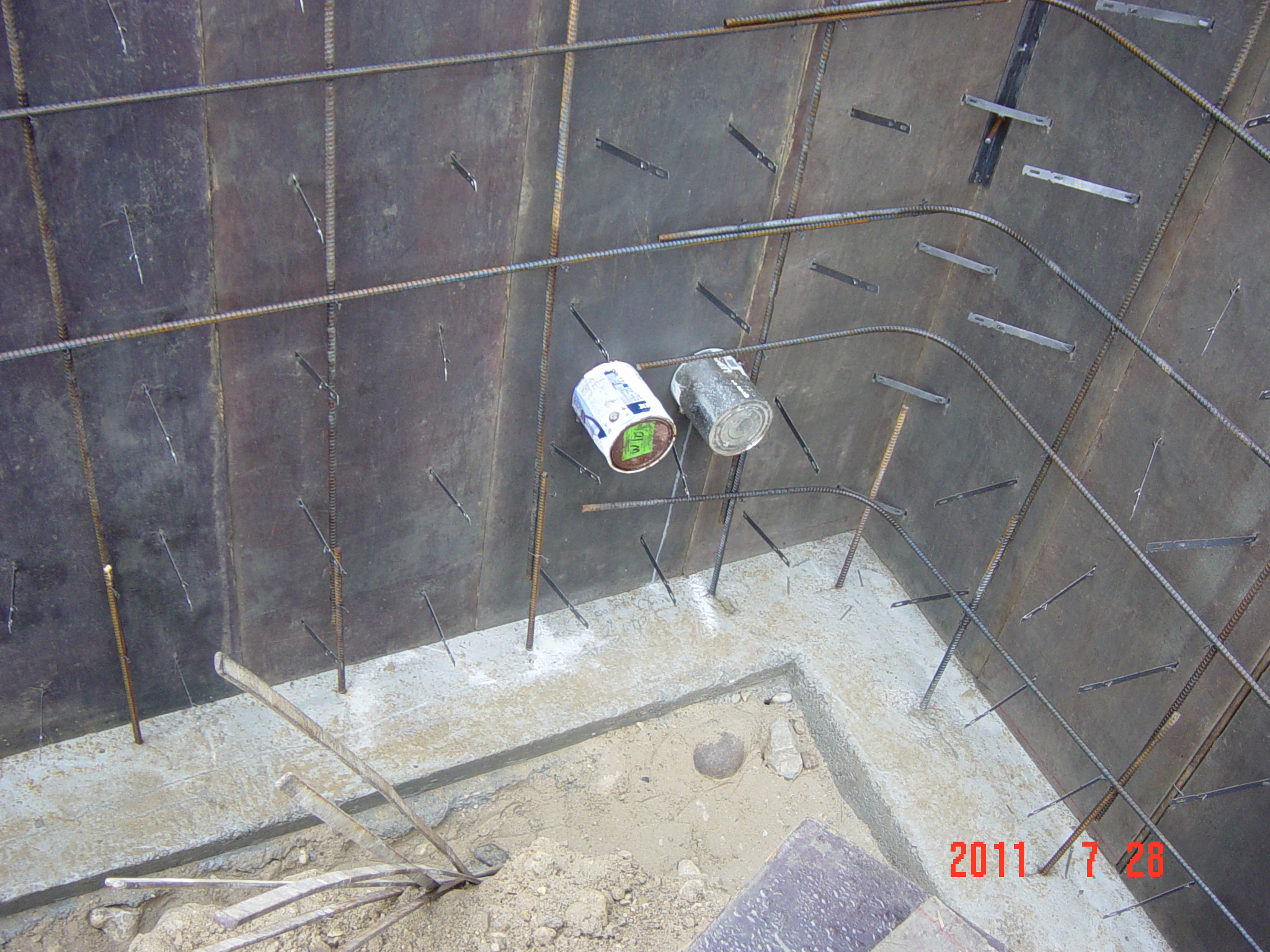

Interesting read on the reinforcing. Not quite sure I agree. The building inspector for my driveshed was a real stickler for rebar. A lot of it, and in the right places. Particularly as the buidling was set into a hillside. I find it hard to believe that all this rebar does nothing, if the concrete has not cracked.
Corner of building into hillside. Paint cans are for various utility lines.
   / Tell me what you see here? #74
This is a wall not slab on grade. Two totally different structures

When it comes to concrete, tension is tension and compression is compression, regardless of orientation.
