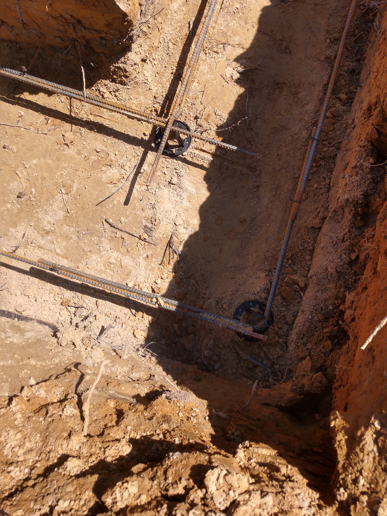

With no bisqueen/rolled plastic sheeting being placed between the fill dirt and concrete being poured that moisture is going to be pulled out of that concrete pretty quickly so I don't think it was to soupy .

I agree with most of the comments. I use chairs, but if they did, they would have been blown over and flattened by the weight & velocity of the concrete. I do agree that without plastic, the water from the mix would be partially absorbed by the sand, but it still weakens the mix. I would have edged to the slab with treated “ground hog forms”, drilled holes at 2’ centers (or whatever centers are on the prints) and place rebar tips in them. When I do a slab like that, I use chairs and then put a blob of concrete at each chair to proved more support before I let the driver turn it loose. Keeps the rebar up in the proper level. Low level Concrete contractors like to water down floors because they think it makes their work easier.
In a southern non frost climate, that concrete job will probably hold up to light use, but I’d be afraid of shrinkage cracks due to excess water. In my area, or should I say under my supervision, concrete would never be done that way.

I would expect that floor to crack and move quite a bit. No compaction of the subgrade, wet mix (too great of a slump), improper placement of the rebar (spacing is way beyond code), improper curing, and did I see a cold joint in there?
I've seen truck washouts with more slump than that...

Am I the only one that saw the rebar piling up ahead of the chute?
If you missed that part, go back to the pour when the chute guy is swinging the chute across the back wall of the shop and watch the bar under his feet.
There are contractors that don't use chairs. I Droned a pour a month ago without chairs. They told the owner they would pull the bar up into the concrete as they poured. They did not.
I've never saw a contractor not tie the bar. That's a first for me.....
Also didn't see any method of leveling the pour. No screed pins. Didn't see anyone with a transit. But a lot was missing in the video. Less talking and more working might have helped with these issues.
Surely they didn't just screed over the bar piled in the corner....
