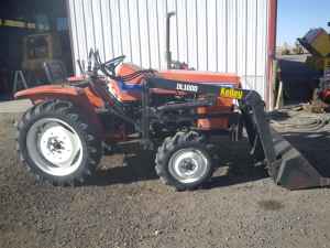

Can anyone tell me what model of hinimoto this is and the pros and cons of it. Came up for sale cheap. Thinking of looking at it. What is the common problems with this model. Thanks opps the picture did not attach. i'll try again
   / Tell me about Hinomoto tractors #29
Can anyone tell me what model of hinimoto this is and the pros and cons of it. Came up for sale cheap. Thinking of looking at it. What is the common problems with this model. Thanks hinimoto.jpg
   / Tell me about Hinomoto tractors #31
Can anyone tell me what model of hinimoto this is and the pros and cons of it. Came up for sale cheap. Thinking of looking at it. What is the common problems with this model. ThanksView attachment 180640
Looks like a 184 or the like. Not a fan of this model and the loader makes it worse.
