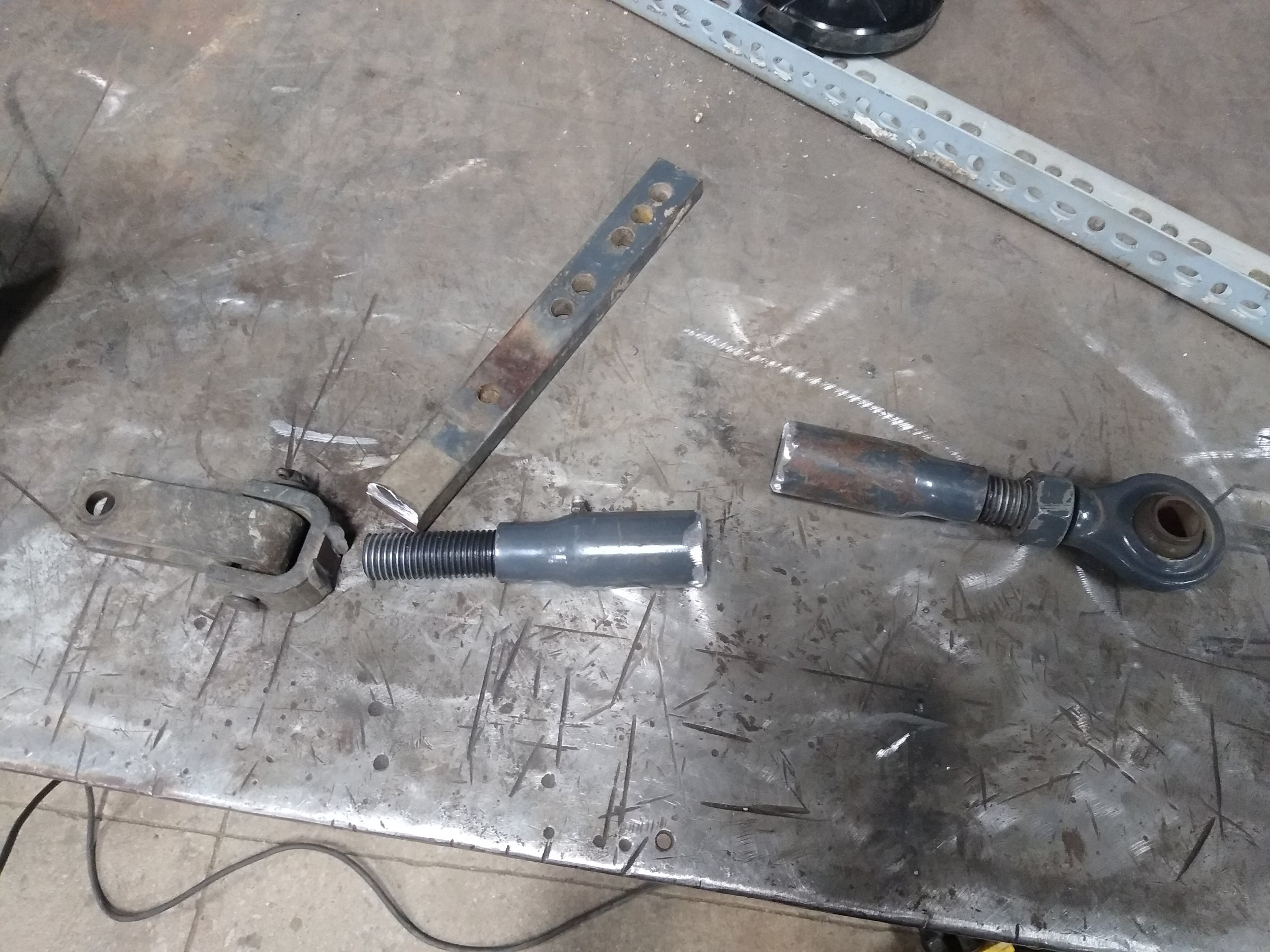

Boy this could go in about a dozen forums. General repair, Kubota, welding, projects, snow removal, etc but here I guess will do.
My bota MX has the telescoping stabilizers. The old L3400 had the turnbuckles.
I know everyone raves about the telescoping ones. But I haven't liked them since day one. Seems there is never a hole that's just quite right and I still end up with an inch or two of slop at the implement.
For most people, probably not a problem using a 500 pound mower or a 350 pound blade. But I use my equipment and have heavy implements. A 1250# blade and a 1600# cutter...an inch or two of movement is alot of inertia. And things continue to get sloppier and more worn.

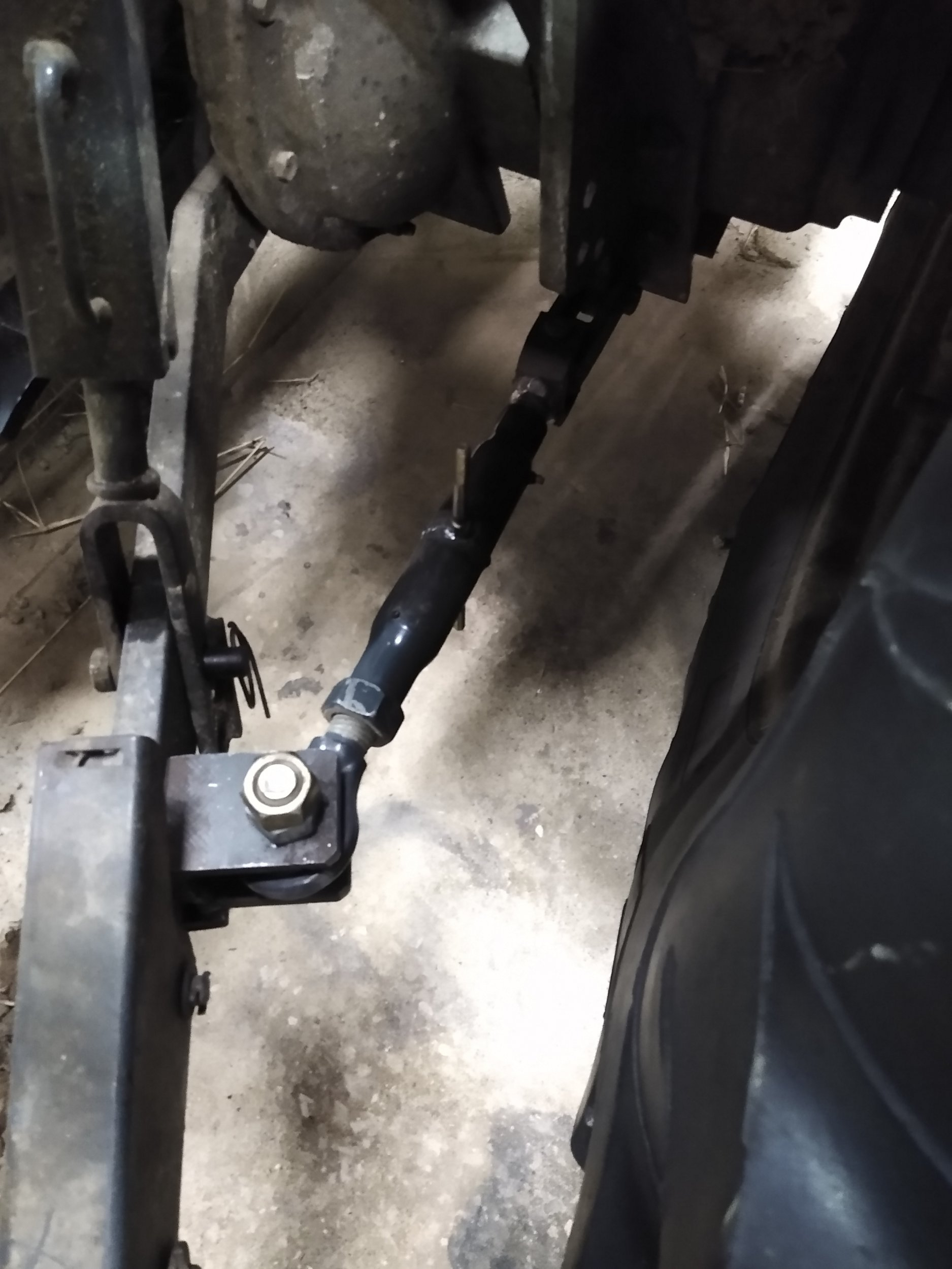

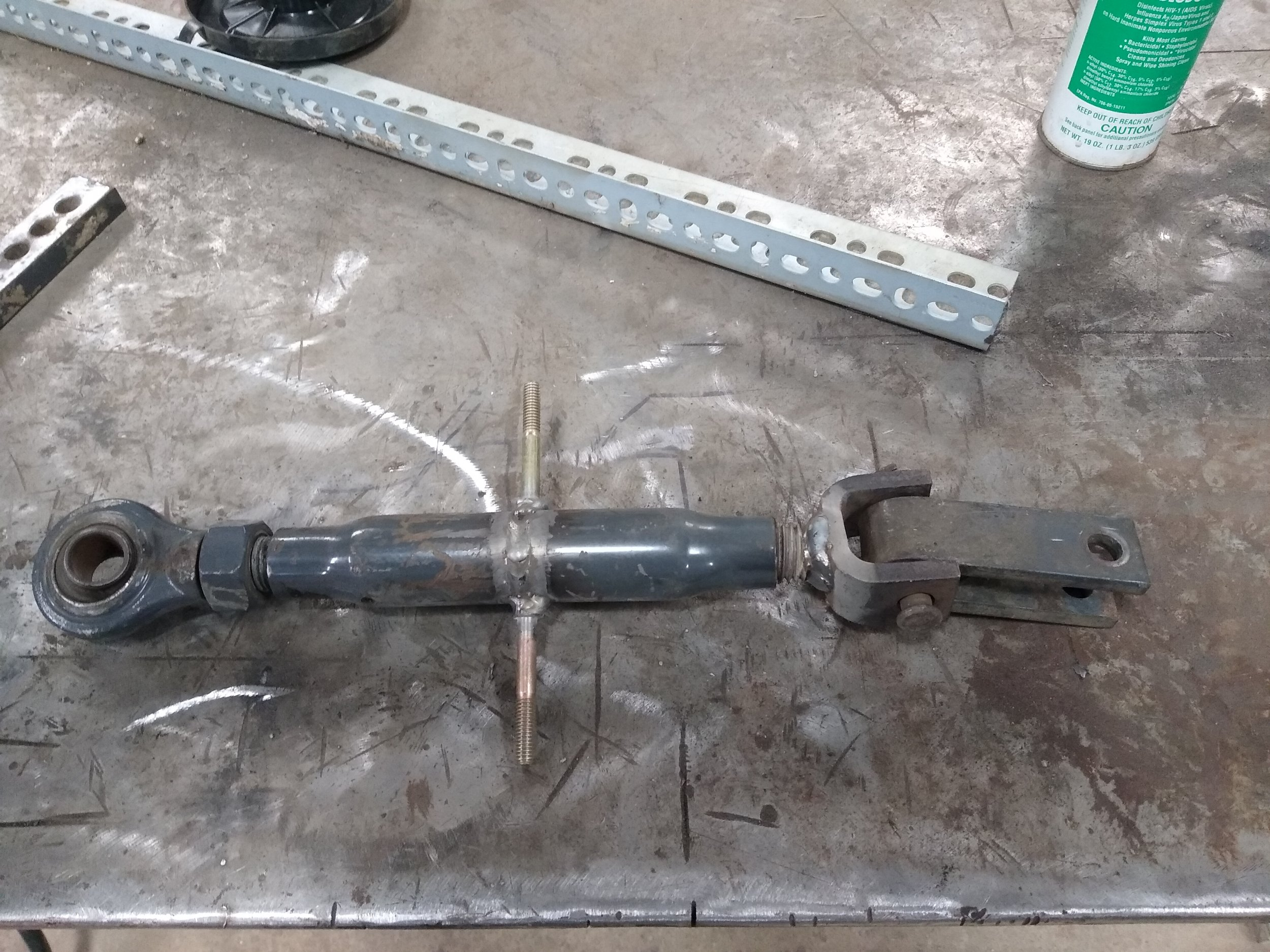

Well I was out plowing....and with an angled blade does put alot of stress on the stabilizers. Well when I got home....I had half of one hanging on the right side. No idea where the other half is. So....time for a fix.....and to address the slop with infinite adjustment.
I had my old toplink hanging on the wall since I made my hydraulic one. Time to sacrifice it.
After taking some careful measurements....started cutting and welding.
Was a fun 2hr shop project.
Nice work on repurposing the lift link! Looks very solid and useful especially in conjunction with the quick hitch.
