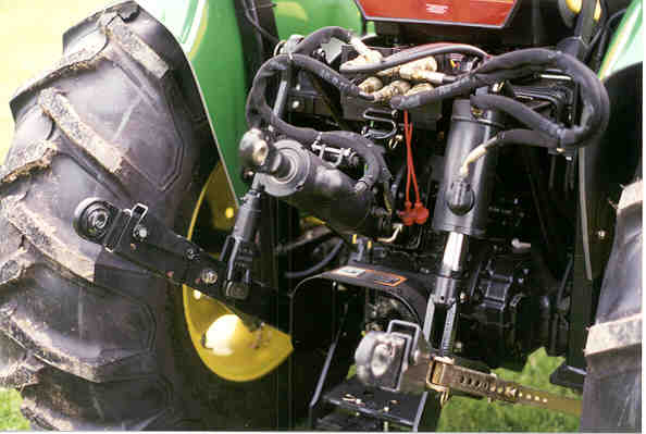

See attached pic of the telescoping draft links on my JD 4710. I'd suggest you find another dealer who could give you accurate information.

Actually, I don't think the dealer is entirely wrong. The links are available through the parts system, not actually as a new option. While a dealer who really knows the product, can handle this like its an option, some ay not realize that it is in the parts catalog.
The latest 4000TEN brochure that I have seen shows them in the back "Accessories" section.
/ Telescoping draft links #30
He's full of it. Here give him the part #'s. For horizontal bar the part # is LVB 25308 $210
For vertical stabilizer bar the part # is LVB 2072 $210.
