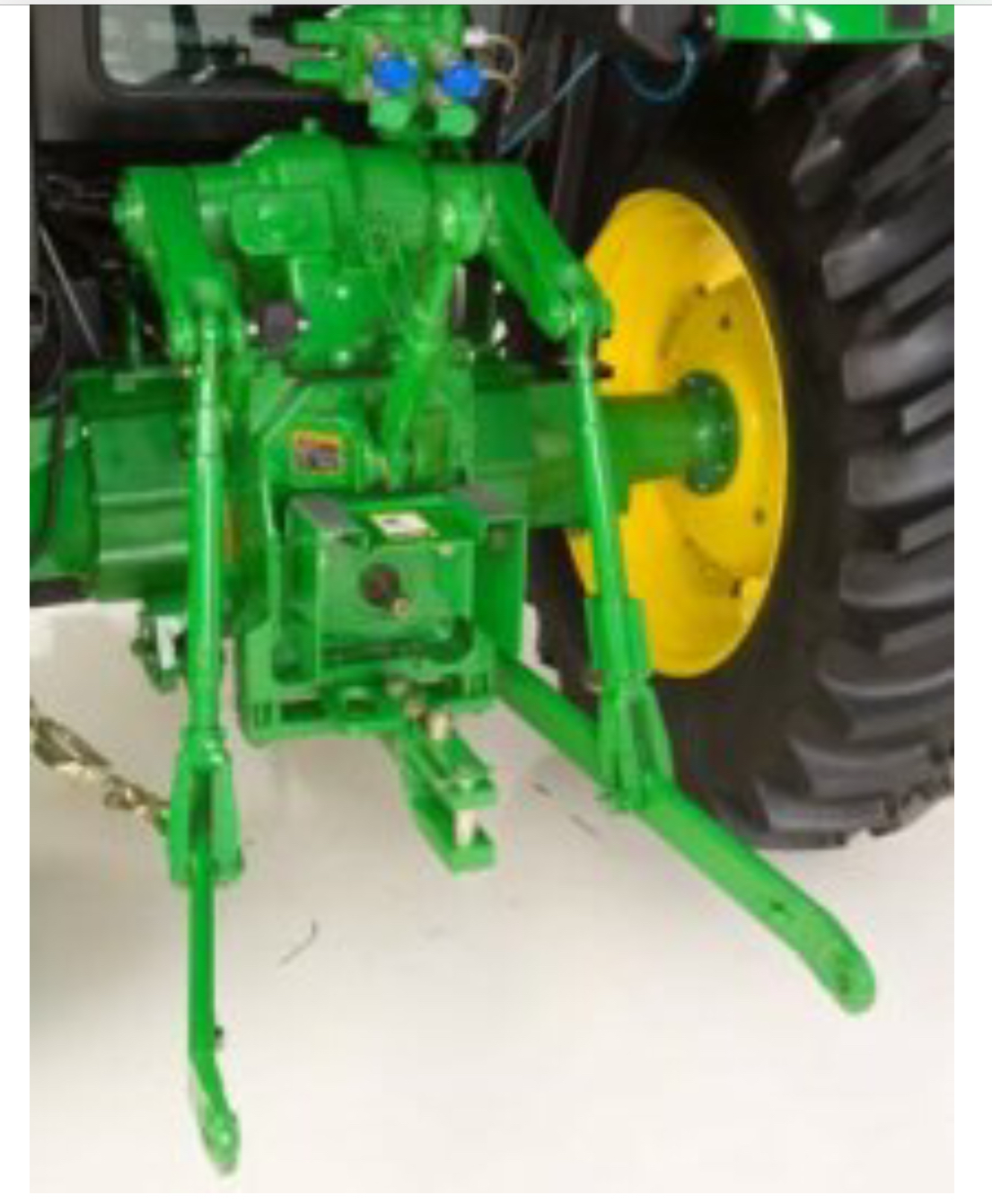

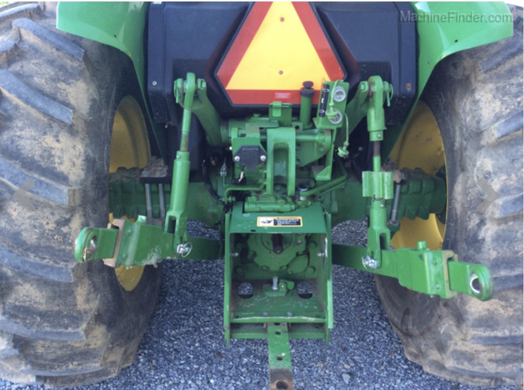

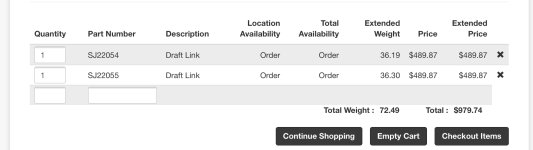

The first pic is the fixed draft link like I have. The second pic is the telescoping draft links I would like to swap to. The third image is what I found price wise on the JD Parts site. I have a set of the Pat’s Easy Change Cat 2 hooks. They worked ok, but more than once I had my rotary mower come loose when on off-camber terrain. I wound up just taking them off. I am trying to catch a trade in at local dealer and see if might work a deal to swap mine with a trade unit. Measurements I took look like any of the lower 5000 series will swap without issue. Curious if anyone else has dealt with this and if so is there a place to look that I am overlooking? The price found through JD Parts isn’t worth it to me.

Try tractor salvage yards. I'll bet they are not cheap there either, and probably sell fast.
Another thought is look for local tractors for sale (craigslist) and see if seller will swap for yours plus cash.

Around here - trying to find used telescopic lower links would be like trying to find and capture a forrest fairy. My Kubota M6040 came with telescopic lower links. No question - they are a real boon to making connections. Good luck in your search. JMHO - in the end, if you really want them - probably have to purchase a new pair. Be prepared - $$$$.

Made a trip by the dealership last weekend to see what they had on the yard. I saw several used machines with the telescoping links and noticed the button on top that you push over to release the end link was missing on several. I realize as long as one side will move you can usually get one arm on the pin or VERY close before ever getting off the tractor. That allows for extending the other arm to reach the pin. I realize the telescoping links are not necessary, but they are definitely convenient. At the same time if they are problematic it may be best to just stay with what I have. We have two older tractors. One has the fixed links and the other telescoping ends. One of the telescoping ends will occasionally slip and pull out due to wear and the other side did the same and was tack welded to keep in place.
