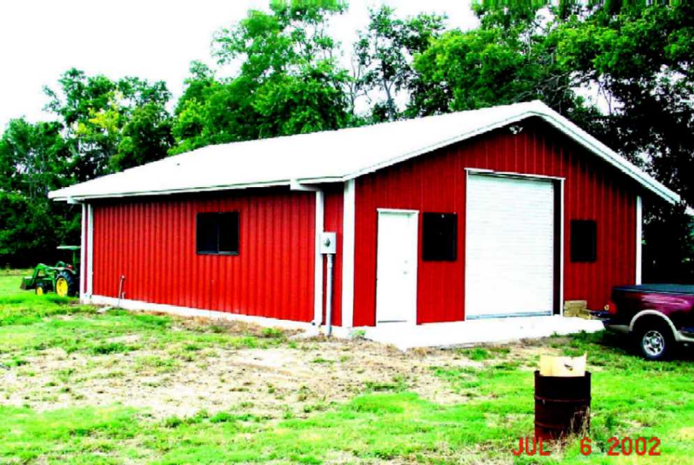

I put up a 30'x40' Mueller building 3 years ago. The standard building had 12' walls with low pitched roof. I wanted a 4/12 roof so I ordered a kit with the walls at 10'. I bought the pre-fab bolt up kit (you can also get a weldup kit). I am very happy with the building and Mueller. Had some help putting up the main frame members and the roof panels. Otherwise I did it by myself after work and on weekends. See attached.
The standard kit was about $5500 as I remember. But I wanted insulation, an extra 10'x10' roll up door, 3 windows, insulation, extended overhanging eaves all around, and gutters. Total came to about $9500 + slab. Due to foundation problems around here, I had the contractor put in an extra good slab (40 yards of concrete with extra steel) for a little over $6000.
Mueller web site is good to review sizing and pricing options.
