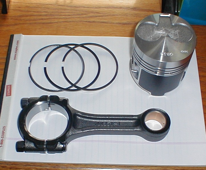

The proper head gasket arrived this morning it is ~3 times thicker than
the first one ordered. Ooopppssie, glad I didn't mess that one up... ;)
Forgot to take picture prior to installing the head. To the picture ******
my apologies. Again no gasket sealant(s) used. But I did use anti-seize
on the head bolts, I use anti-seize on just about every fastener there is.
I spent too much of my time in the Navy dealing with salt water corrosion.
The only thing so far I did not anti-seize were the conn rod bolts, but
they were lubricated with engine oil prior to assy. As was the whole of
the piston prior to installation.
Also spun the crank and everything moved smoothly with no bangs, knock
or whines. Always a good thing I could not spin the crank by hand before
removing the bad rod. Also the engine pulley nut is 36mm.
I have included the service manuals two pages that cover head gasket
selection for the TC35, TC40 and TC45 models, and the head install
procedure.

One last thought I would like to share on this topic. Attached is the picture
of the fuel shut off solenoid, the red arrow points to the electrical connection
for the solenoid. I will get to that later.
I believe that my bent rod was caused by not only some of the oil being filled
draining into the intake manifold and the intake valve being open. In
addition, I believe that the piston was near the top of the intake stroke
allowing nearly a full charge of air less the oil that filled into the cylinder. So
that when the valve closed and compressed the air into the pre-combustion
chamber along with some oil, that when the injector fired there was sufficient
compression to fire and with the additional oil and higher than normal
compression this resulted in unexpectedly high pressure. And since the
injectors fire at 20ー BTDC the piston tried to complete cycle and then bent
the rod.
