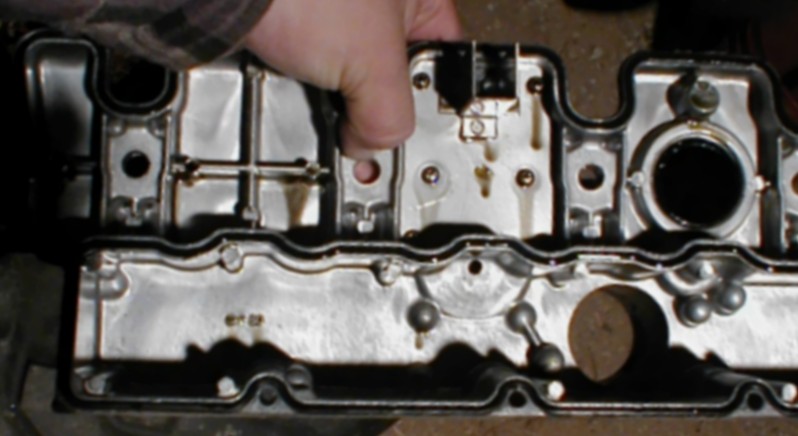

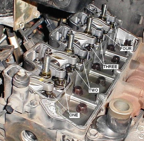

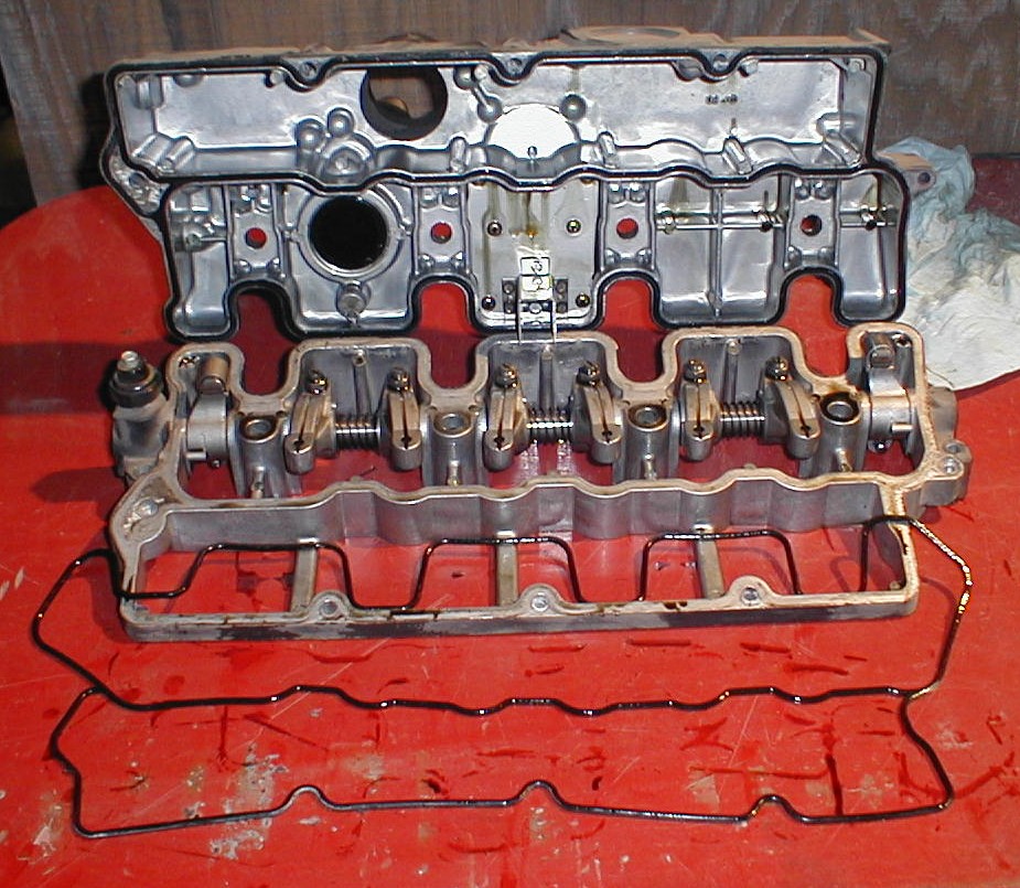

the tractor is still all stock parts. Ref 04 is the upper valve cover, to the
right of my thumb is the breather assembly screwed in the valve cover/intake
manifold casting. Ref 05 is the lower valve cover assembly and houses the
rocker arms and the rocker arm shaft as well as the oil pressure sensor. The
number labels are over the actual intakes into the head and the line go to
the intake and exhaust valves. Ref 06 is the upper and lower valve cover off
the tractor.

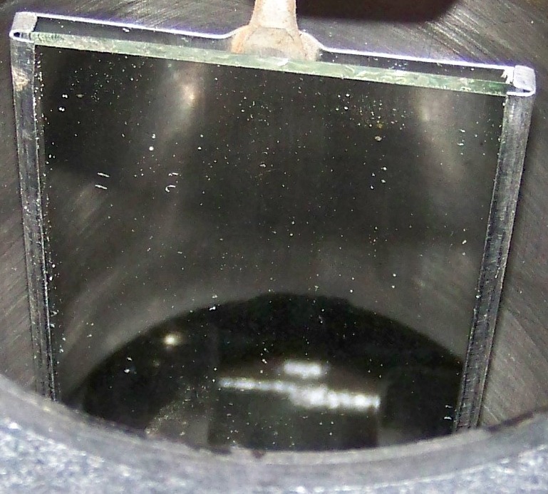

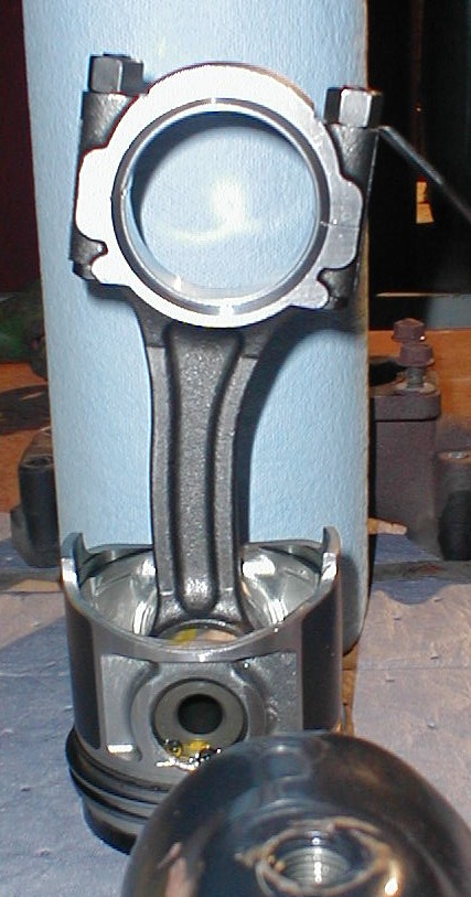

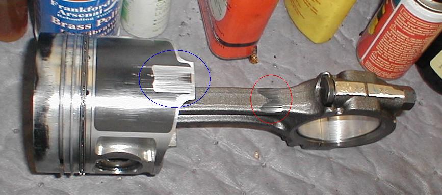

Well Sunday I finally take enough apart to see what the issue with my engine
truly is; Ref 07 and 08. You can see in the ref 08 picture the red circle
marks where the rod contacted the lower edge of the cylinder wall and
scraped the rod, this would be the knock I was hearing I am guessing also
you can see where the piston skirt was deburring the edge of the cylinder
wall. Surprisingly the only damage to the cylinder wall is the edge see Ref 09.
I will polish up the rough edges with some abrasives I have and do not plan
on replacing the block.
At this point my friend comments, "All that damage just from pouring your oil
in too fast? I respond, "YUP!!!
The last of the parts were ordered today, should be in tomorrow AM.
