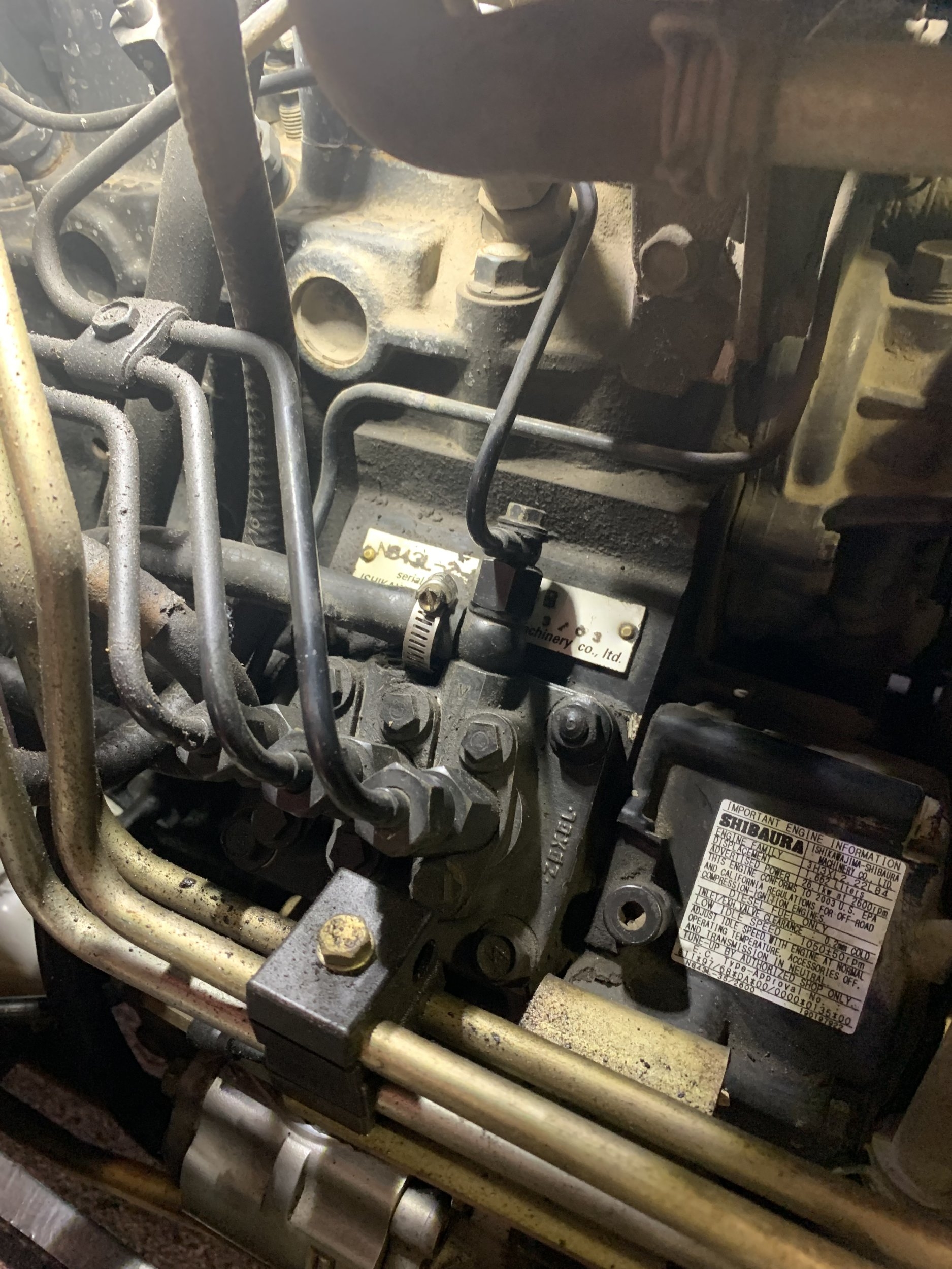

You might try bleeding air at the injection pump. There’s a small banjo bolt at the very top of your injection pump you loosen a little while cranking.
/ TC35 no start issues
Sounds good. Not familiar with “banjo” bolt. Could you provide a description? And would it be located towards front, center or back?
Thanks.
/ TC35 no start issues #6
Here you are , this is from a CIH dx35 but identical to yours I think. Bolt is to right and above fuel supply hose
