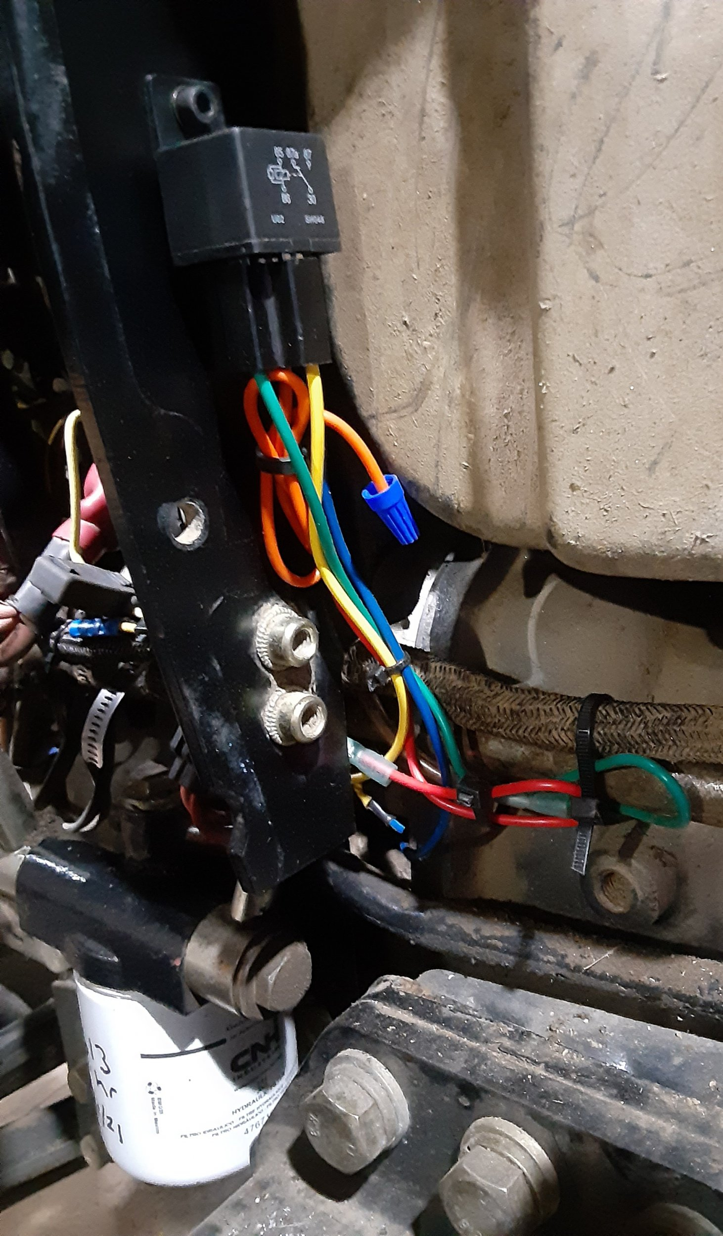

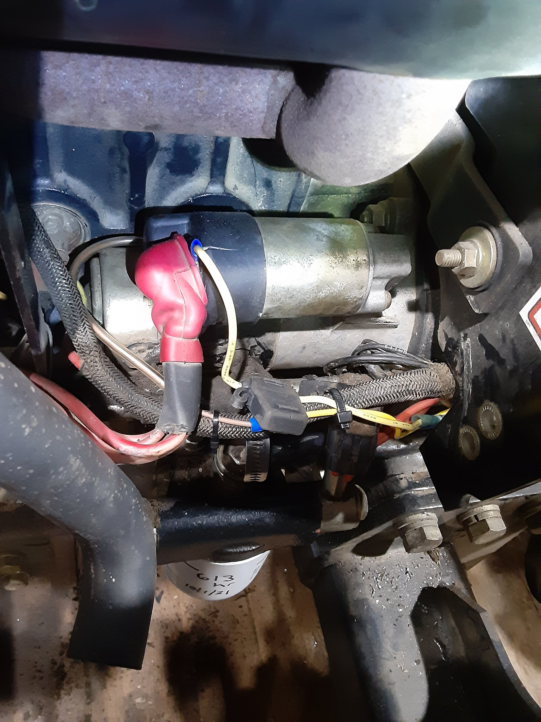

Hello, I am the latest owner to suffer this intermittent starting problem, which has gotten worse over time. I have a TC-29DA. There is a LOT of information on this site about the issue, and a good bit of it very useful. I believe, as of yesterday, that my problem is resolved (5 strong starts so far, hot or cold, without issue yet). I applied the starter relay circuit fix and cleaned up a few connections along the way. In total, I:
1. Added the starter relay circuit described (post #51 on this thread) <-- I suspect this is what really solved the problem
2. Replaced the positive battery cable end (resolved the OP's problem, and I thought mine looked pretty worn anyway)
3. Cleaned terminals on all fuses and relays (and replaced one fuse)
4. Cleaned ground connections to frame under battery and under starter
5. Cleaned ignition switch terminals
For anyone searching this problem in the future, here are other threads on the topic:
TC33da - starting problems (helpful pics in post #10)
(I said there is a lot!)
I purchased all materials needed at NAPA. Here are the part numbers as of today:
Relay: ECH AR143 (match for the three Bosh relays on the RHS of tractor for the glow plugs, neutral safety, and PTO safety), $20.69
Connector: ECH EC23, $ 14.33
Fuse holder: 782-2023, $3.88
I did not have the proper sized ring terminals, so I bought two packages (20/15 count) to get the two specific sizes:
5/16" blue ring: 784336, $5.99
3/8: yellow ring: 784348, $5.88 (they did not have blue for 14 AWG wire, so I crimped it good)
The connector has approx. 8in wires for each terminal, so no extra wire was needed for the job. The connector came with the butt-end terminals to join the wires. Everything listed was all the materials used (plus a 10A fuse and a mounting bolt). The day I went to do work on this, the tractor did not start at all, so I did it with the FEL attached. That was not pleasant, and my fingers hurt later, but it can be done! My wire from the neutral start relay to the s-terminal on the starter solenoid was tan, as indicated on the TC29DA/TC33DA operator's manual. I grounded my added relay to ground bolt below the starter. Getting at that area around the hydro manifold was the most tricky part... patience and luck.

Tried to start with just battery power with a jumper cable at the starter, no luck. Starter did not engage.
Checked power at starter while trying to start only 8 volts.

View attachment 717678View attachment 717679View attachment 717680
Thanks for such a through post with pictures, part numbers and pricing.
Glad to also learn your problem has been resolved!

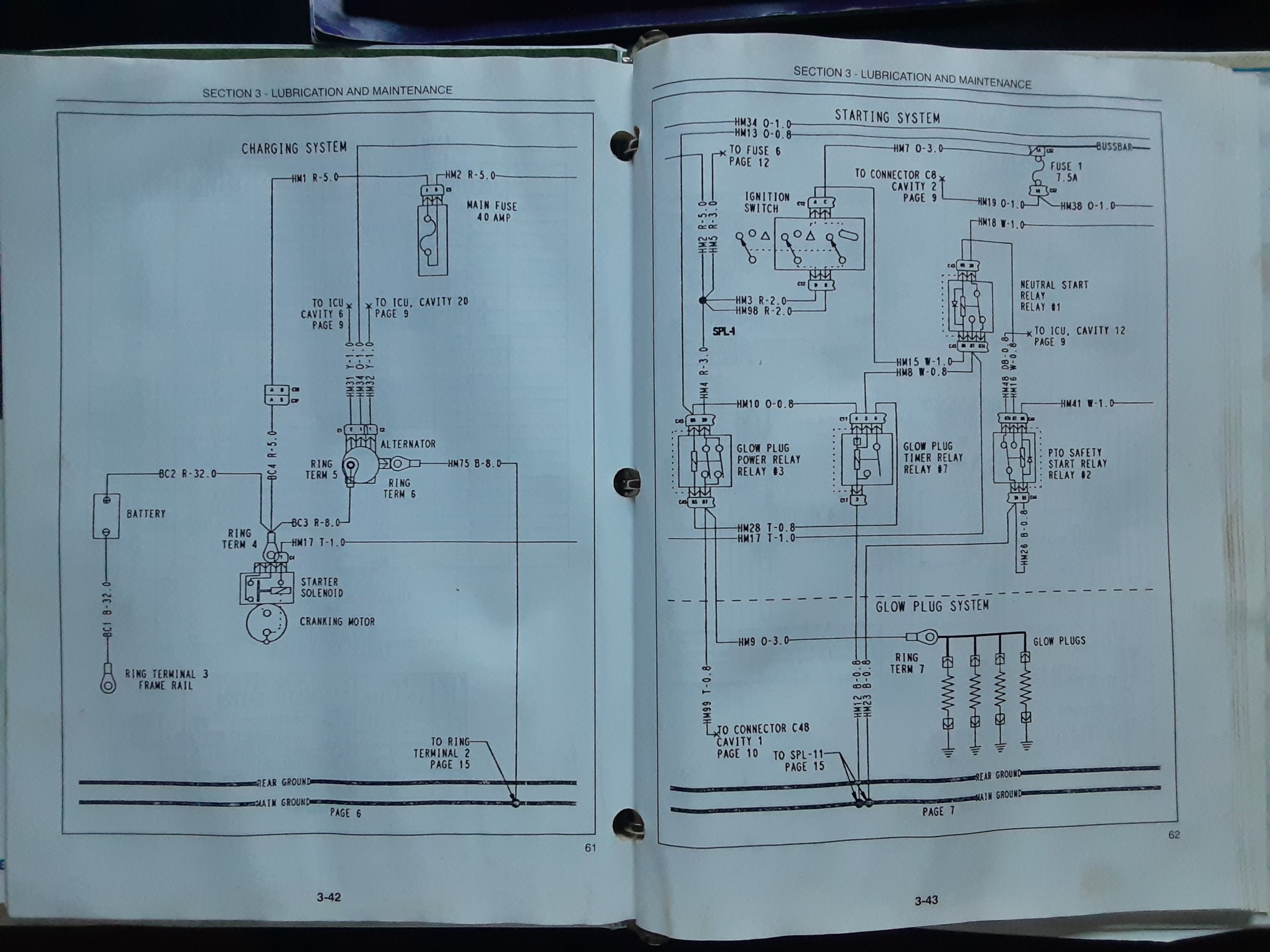

/ TC33D wont start #140
See attached, one from the Service Manaul and the other from the Operator's Manual
  • Fuse Block - From Service Manual.pdf
  • Fuse Block - From Operators Manual TC29D 33D.pdf
