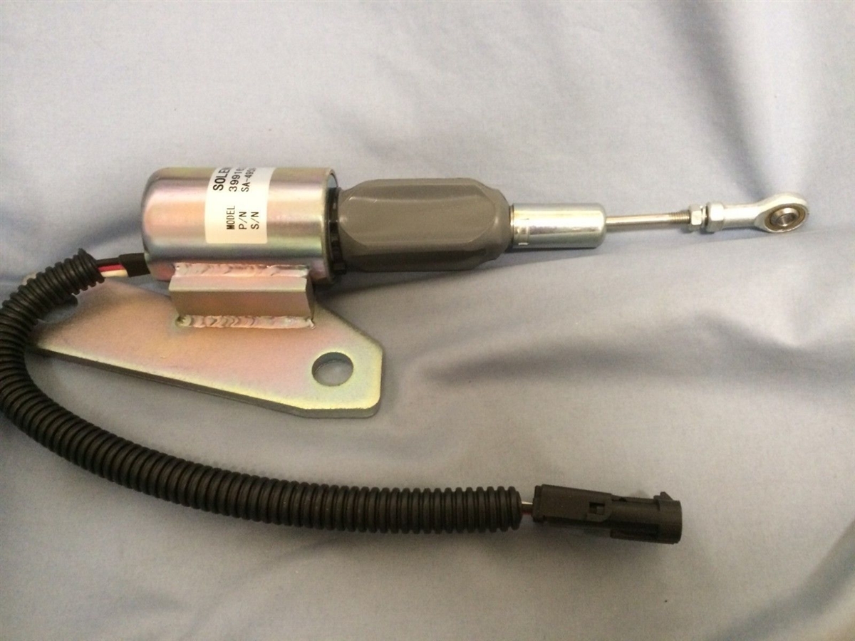

Is it this type? They must be adjusted so that the stopper fully retracts or they will burn out .
Look at the supplied PDF posted by thclimer. The "type" might be the same, but the configuration is different.
Bonus! The mounting position means NOTHING. The solenoid does it's thing by retracting into it's self.

Who said anything about "mounting position" ?
I am talking about the ADJUSTABLE link rod ! IF the stop lever on the pump comes against its stopper BUT the plunger INSIDE the solenoid IS NOT on ITS stopper, the wingdings WILL GET HOT !
