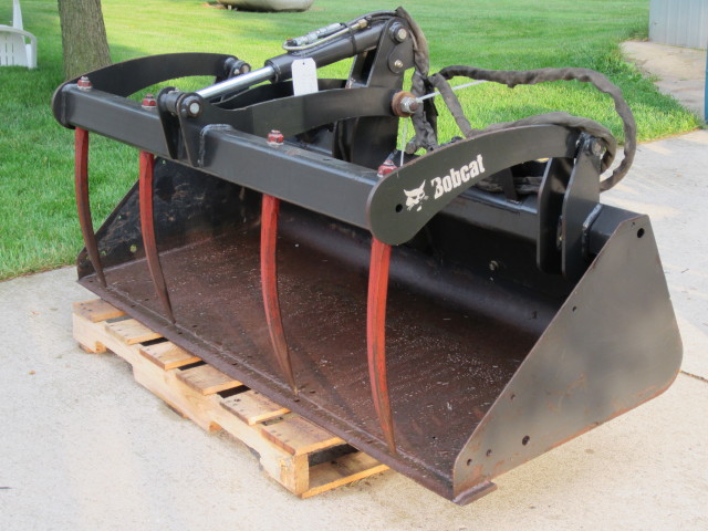

This is a general purpose bucket that has a bolt on grapple. All of it is Bobcat brand and is heavy duty. I should cut back the sides of the bucket so it will haul more long stuff. The claw tines are tough and will stick into a pine log. I needed to grab the end of a log and pull it but this grapple isn't made for that.

perfect, thanks for the example!
/ TC 5600 Grapple buckets #9
For doing logs and brush, I'm sure many grapples are more suited for the job being lighter, log grabbing, and open to see through. This one opens up good so I can grab lots of branches and releases them good.

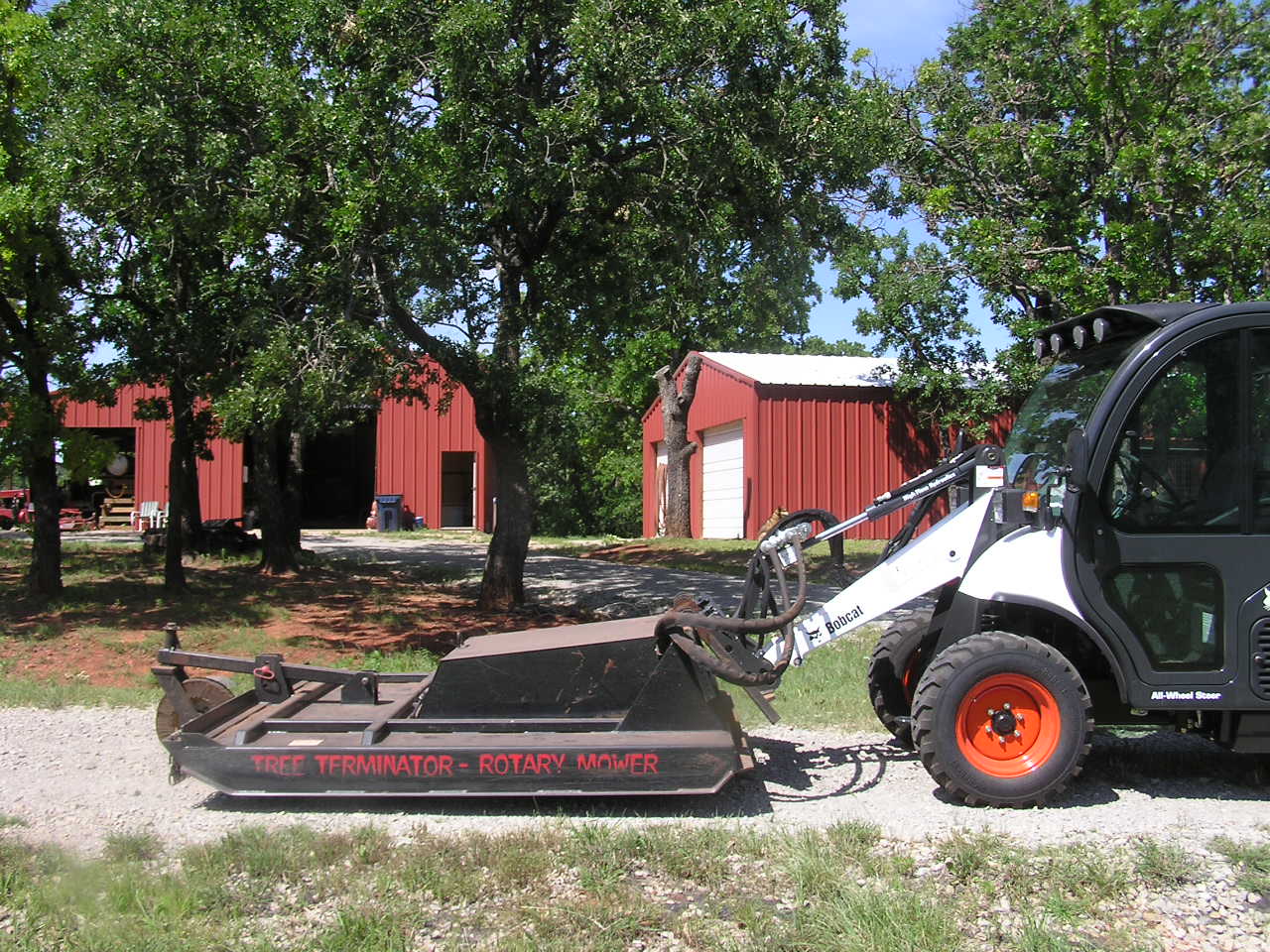

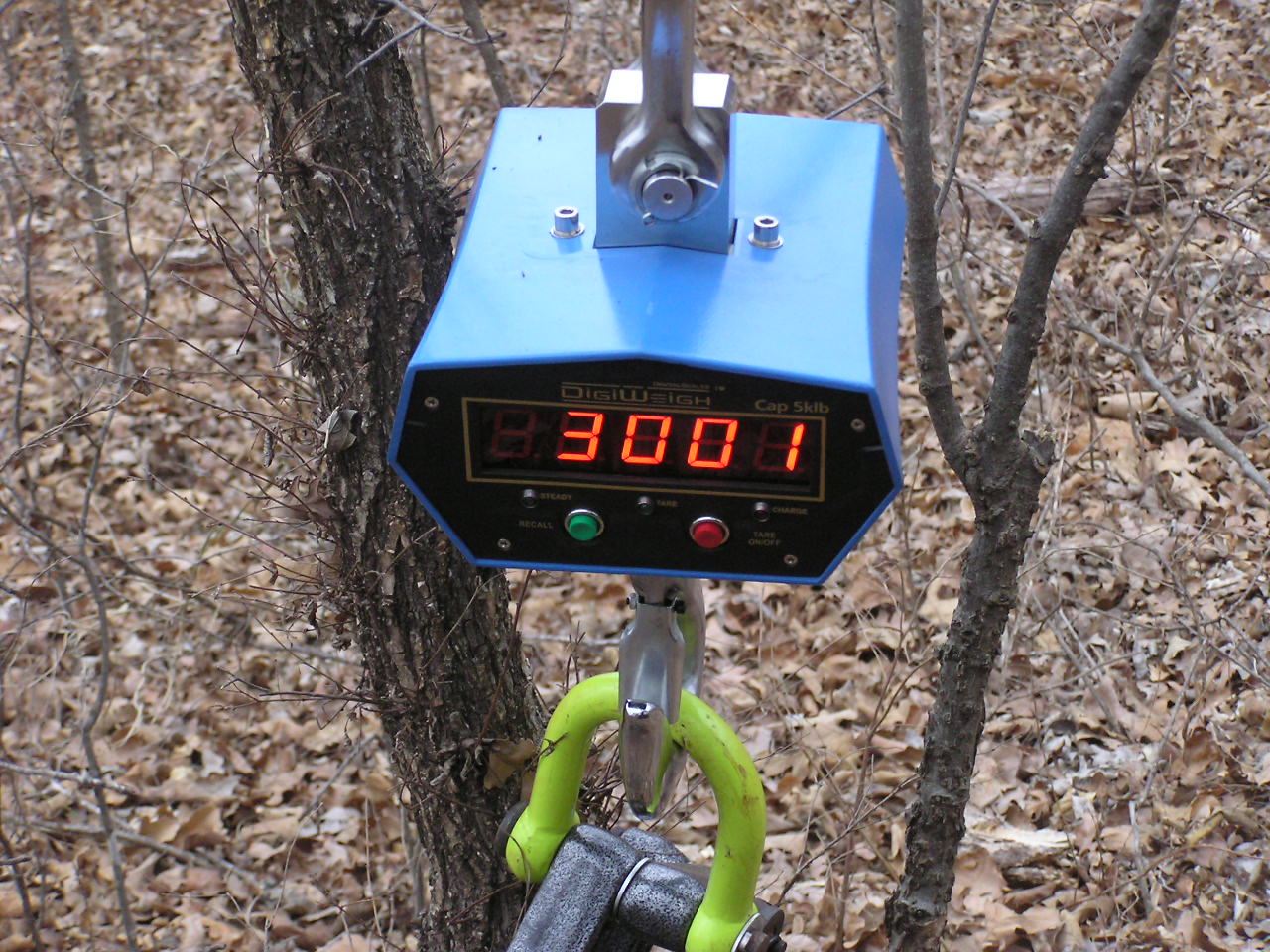

I would be very surprised if that is true. Here is the 2013 F Series showing max lift with nothing on the SSQA, the loader relief valve opened at just over 3K and the loader just stopped going up:
And easily lifting the 1800 pound brush hog.
And the 2017 G Series lifts it no problem also, just don't have any pictures with it airborne. :D
