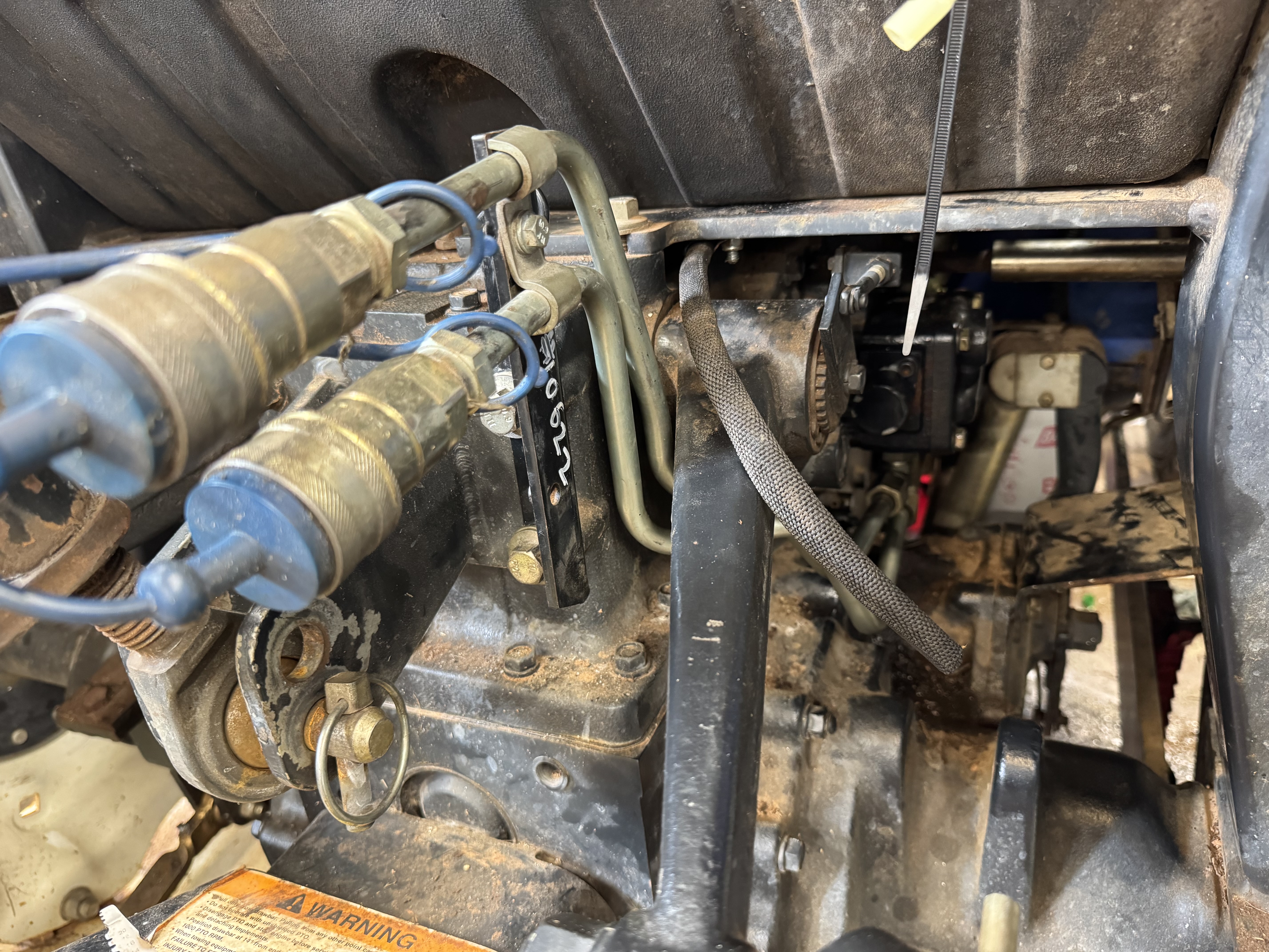

Has anyone tried to install the NH rear remote valve without removing the right rear tire?
   / Tc 40da adding Rear remotes #26
Well didn’t get any answers, but yes you can install the first valve without removing the right rear tire. That dangling wire tie points right at the valve.
