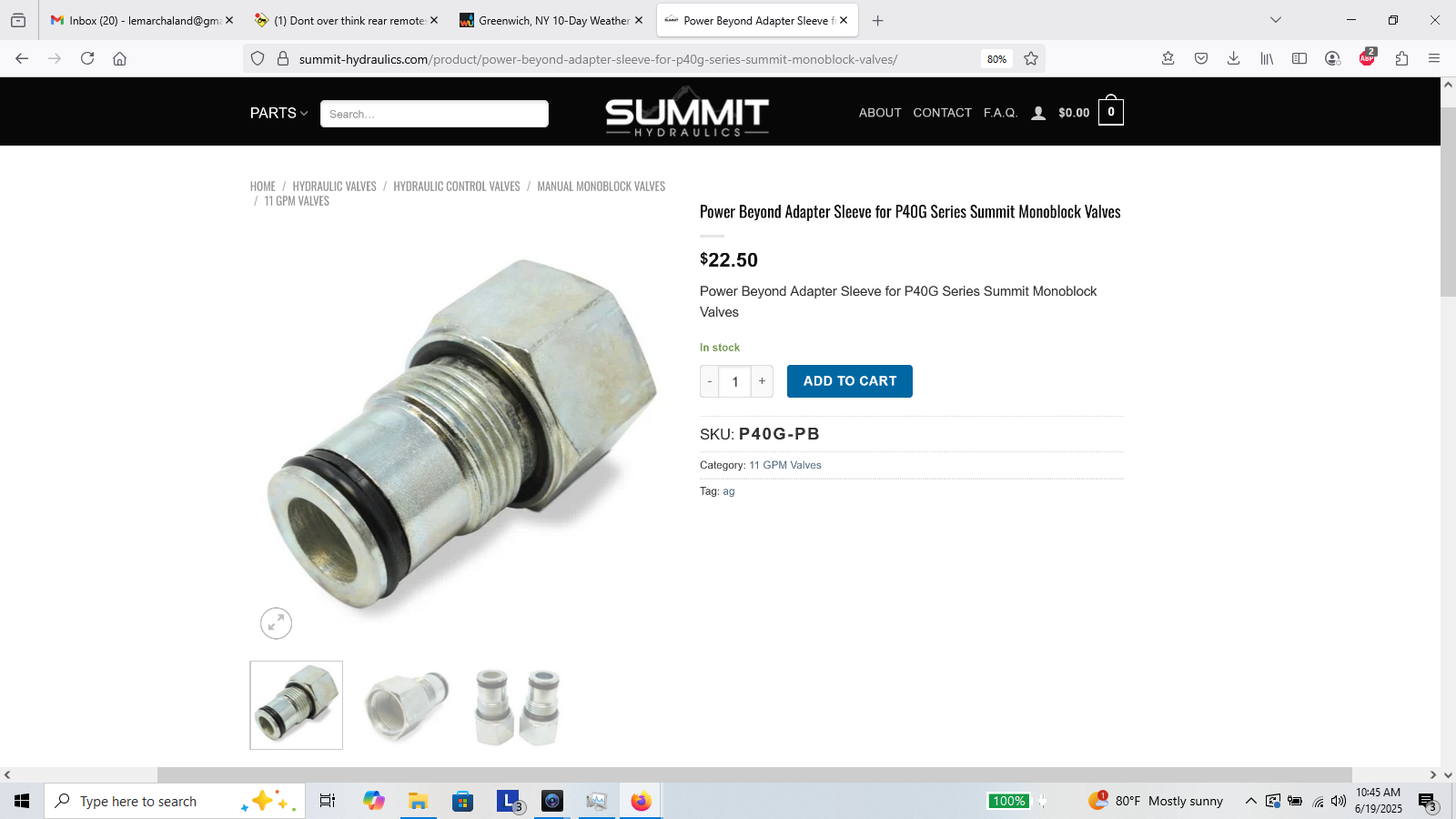

Going by this diagram I need the power beyond sleve and to connect the T port to the cover on the 3rd function cap.
Does the valve in the pic even have a N port?
That looks to be a P40 valve which could have come from Summit Hydraulics.
Yes it should have N port.
Viewing your picture on the upper right side is a plug right next to the T port.
That is were the power beyond spool would thread in and then your existing line on the T port would go to it and a new line from the T port to the tractors reservoir.
Power Beyond sleeve
Power Beyond sleeve
Thank you. I kind of figured that was the N port but it isnt listed as such.

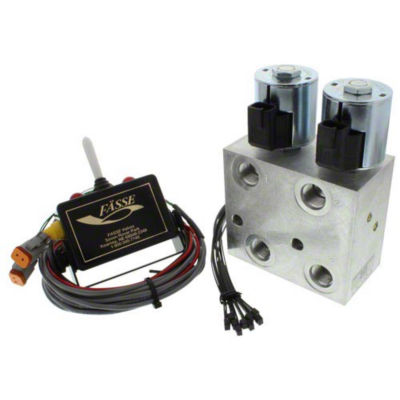

This will do about the same thing
You still need to buy all the hoses and fittings.
I thought I should update this with a pic including the power beyond plug. I had to order some fittings from surplus center to make everything work. Tha is to all those who told me about this. Adding another hose wasn't that big of a deal but would have been way easier when I was initially ordering stuff.
