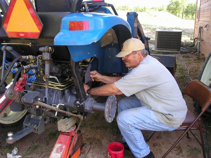

Everytime you buy a remote kit: #1, #2, or #3, the kit comes with longer bolts in each kit to replace the shorter ones from the previous installation. The kits are so complete and well-thought-out that they go together very easily. The only thing they do not come with is teflon paste or teflon tape for the fittings. In order to get the fittings good and tight so you don't seep fluid, the teflon tape/paste is necessary. It works as a lube for the fitting's threads as well as a gap sealer. Remove your right rear tire to make the job a simple task.
I know I've posted this a gazillion times, but here is a photo of me when I was installing my three rear remotes.
