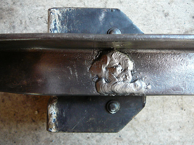

One great thing about trying new stuff is you gain respect for others and their trades. I put a new 50A plug on my welder and decided to try my first weld on my brush hog. Others had recommended that I practise on scrap, but I am the only one who sees my implements so what the heck.
Anyway, I realized quickly why welders get paid for what they do. Pictures will tell the sad story. I started trying to tack the sheet metal to the 1/4" frame, but kept just melting the sheet metal on top. Finally, I moved to teh heavy angle iron on top and managed to get an ugly weld. I guess this is how you learn if you do not want to take the time to read a book or take a class.
John
A couple befores and a couple of afters should be a good lesson to all.

Anyone want to bother commenting on my first welds or is it just a matter of lack of teaching and practice that there is not much to say about. LOL
/ Taking the Welder Plunge #60
I know you hate grinding but a little grinding of of the paint and rust would go a long way in helping those welds, at the very least it will help in starting the arc. I am not an expert (oh don't you hate it when someone says that) but I have burned a few rods. I would say you neeed to have a shorter arc and slow down a little. What rods are you using? I would suggest 6011 to burn through the paint and rust. You need to focus the heat more on the side of cutter to keep from melting the thinner top sheetmetal You really need to at least run a couple of beads on some scrap so you can get the feel.
