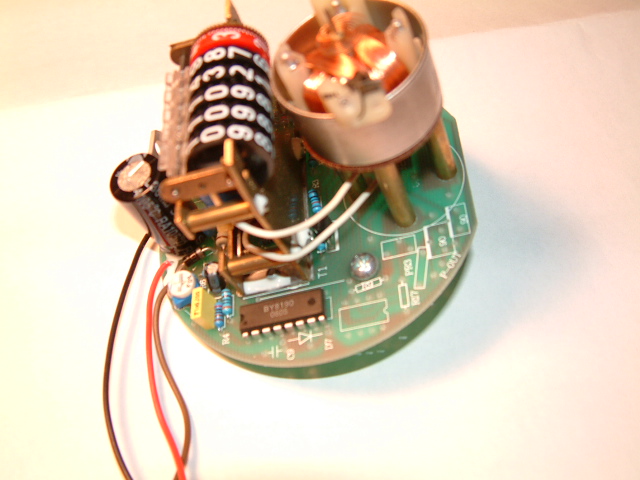

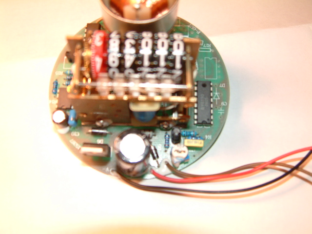

Here is an update on the tach problem. I found I was able to disassemble the instrument cluster and seperate the other gagues from the cluster leaving just the hour meter and tach in one piece. There is a board that is most likely the problem. If anyone has any defective cluster panels maybe I can get what I need to get a working set from them. Any help would be appreciated.

#11
Tommy
All the other gagues in the cluster work that includes the fuel and ampmeter but the center portion is a combination tach and hour meter. I've been able to take the cluster apart so the picture I am posting is just the tach.
jjk
