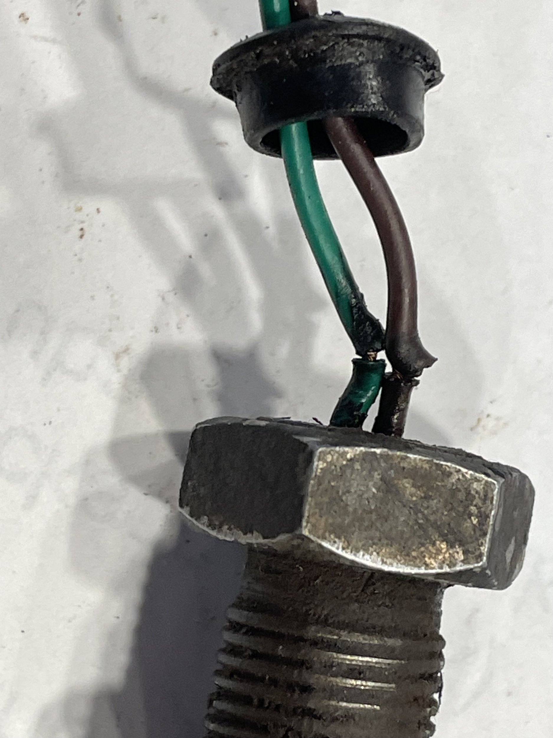

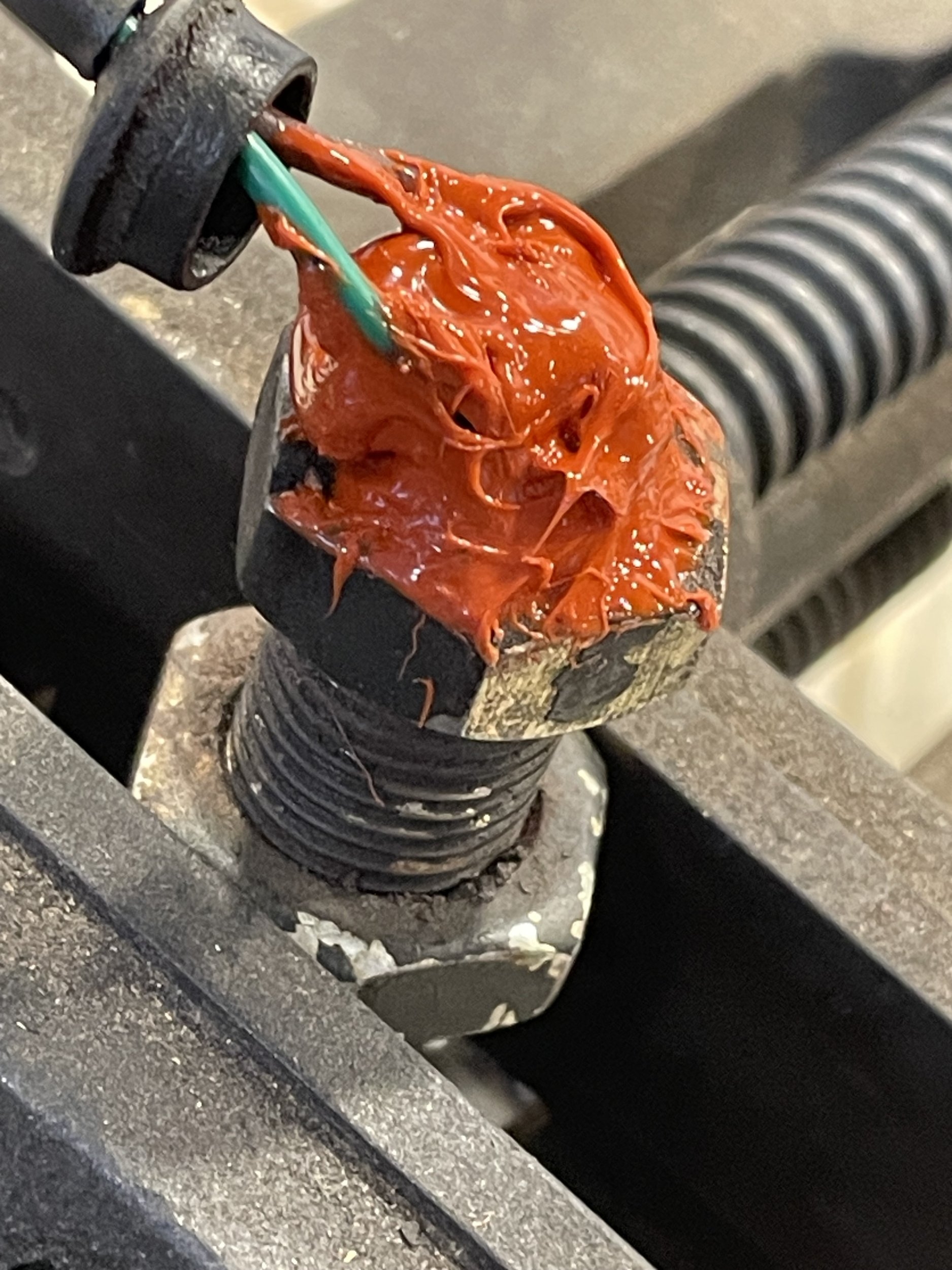

I have a 2010 JM284. The tachometer recently stopped working. This tractor has the cluster instrument panel. The hour meter is integral to the tachometer. All the instruments powered up including the hour meter. So I concluded that either the tachometer sensor unit had failed or the associated wiring/connector had an open circuit. I contacted the dealer who stated the sensor was a common fail item and that there really wasn’t a way to bench check it to confirm a failure. With shipping, a new sensor would be about $45.00. Not a big deal but I figured there had to be a way to determine whether the sensor had failed before spending the money. Then I came across Piper184’s little trick with the drill chuck. Brilliant! On the work bench I connected a DVM to the sensor wires, spun up the drill, and moved the sensor to close proximity of the chuck. I got a voltage reading but it was variable and intermittent. So the sensor was faulty and would need to be replaced. I noted that the wires enter the sensor through a soft rubber cap or plug that fits the end of the sensor unit. Out of curiosity I pried back the plug and discovered the insulation on both wires at the same location had cracked exposing the internal conductors (see photo). I separated the exposed wires so they couldn’t short and repeated the drill trick. This time a steady consistent voltage reading. I wasn’t sure how I was going to repair the wiring because of where the break in insulation was located. I ended up using RTV silicone gasket maker (it’s what I had on hand) to fill the hollow end of the sensor and built up enough silicone to encapsulate the exposed wires and immobilize them (see photo). I allowed 24hrs cure time and reinstalled the sensor. The tach works perfectly.
