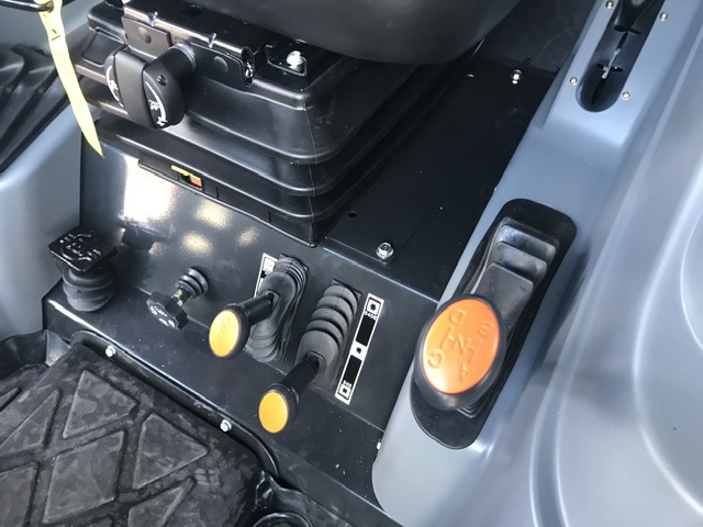

A few more questions. Does the 3rd function on a 4820 run steel lines to the front or rubber? Does it require removal of the stock joystick and replacement with new, or does it slip over the existing?
/ T494HC vs 4820 CH #27
I'm pretty sure the dealer meant they need to change just the handle on the joystick for one that has the buttons incorporated. Not necessarily the entire joystick assembly.
/ T494HC vs 4820 CH
#28
Correct, it appears you have to cut off the factory joystick "handle".
At WR long they show the factory cut off and theirs held on with 2 screws
The video LS sent me shows them cutting off the factory joystick completely and putting the WR long on:
Looks like summit does the same:
And yesterday when I was on the phone with 2 service techs at big tex they emphatically said they completely remove the factory joystick on the 4820 and replace it to do the 3rd function.
So I guess that is the deal for the 4820. With the 494 you get to keep the factory joystick
