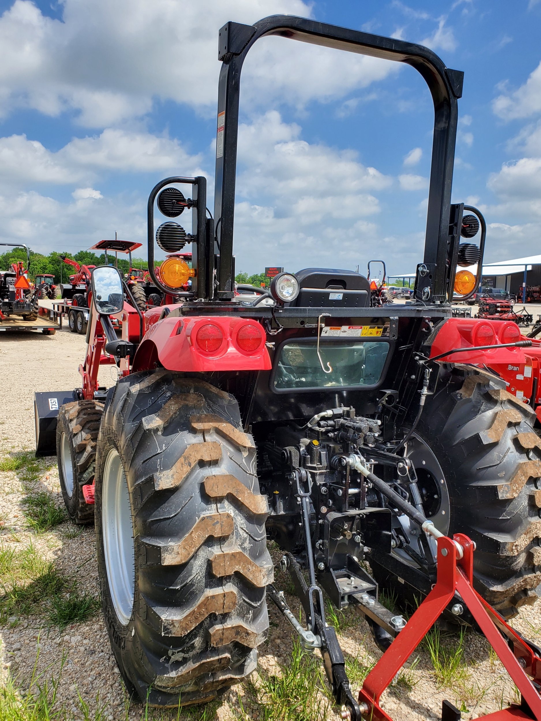

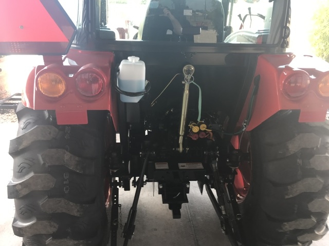

The back of my 574 right before I took delivery.

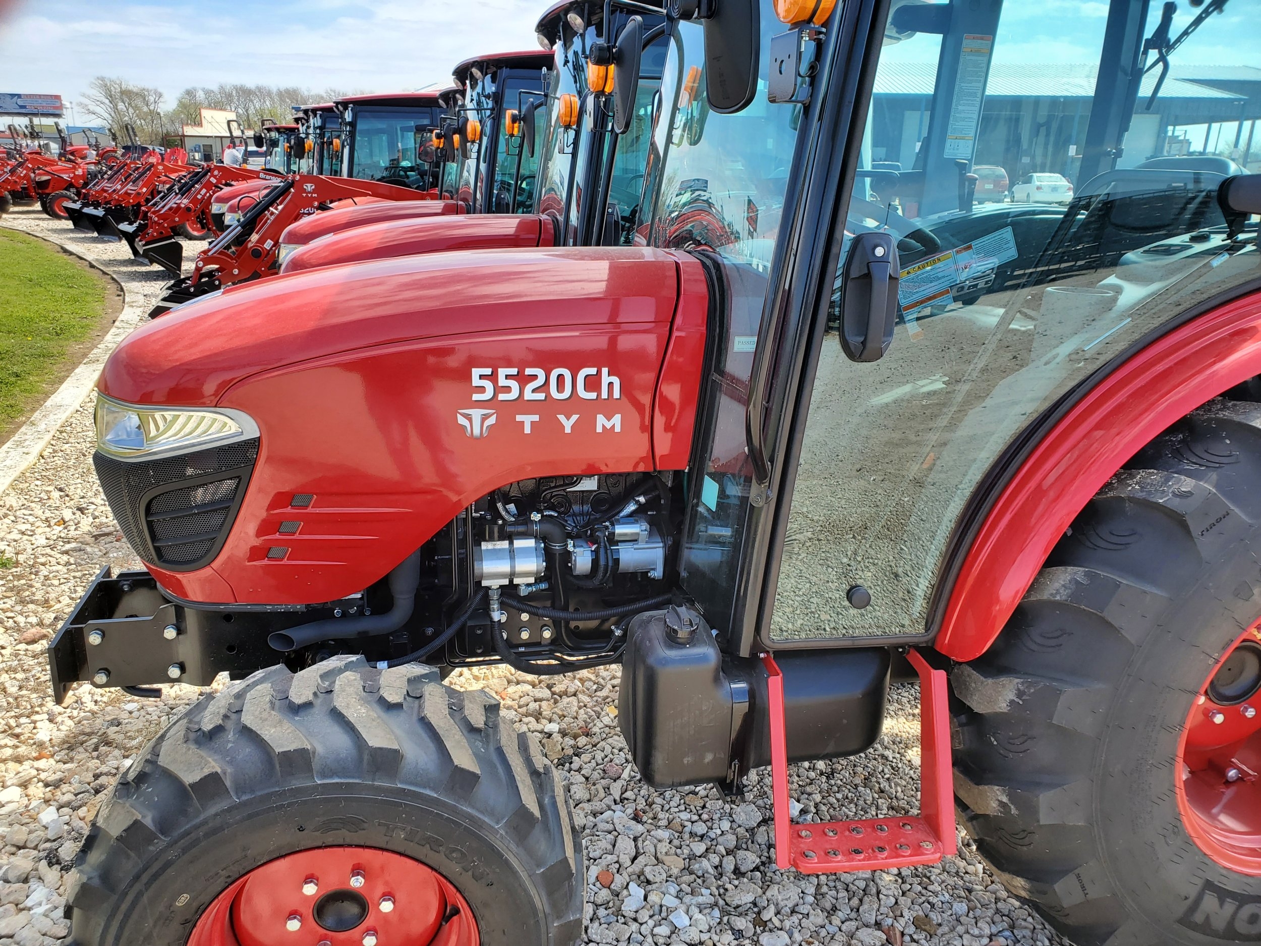

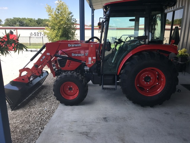

I don't have a shot of the back of the 5520...clearly they have a lot of them, though!

Even though I have a ROPS tractor, the rear 3 pt control still very nice and handy to have. I fabricated one for mine. It's fairly easy to do and it doesn't need to be over done as mine. Something simpler will work fine. If you can fabricate a little bit, it's another option to consider.

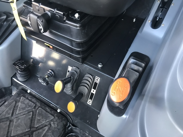

Sorry to hear that but thanks for thinking of me lol. I just called and talked to your big text guys in the service department. They say the Branson is definitely built heavier but to do the third function you give up the integrated Factory control they have to replace the entire joystick which I guess is okay. The bigger thing is they're absolutely is no remote for the three-point on the back side. But in all honesty we're using this tractor for the loader so probably the added hydraulic flow is pretty important as is just the overall build quality and the four-speed. transmission

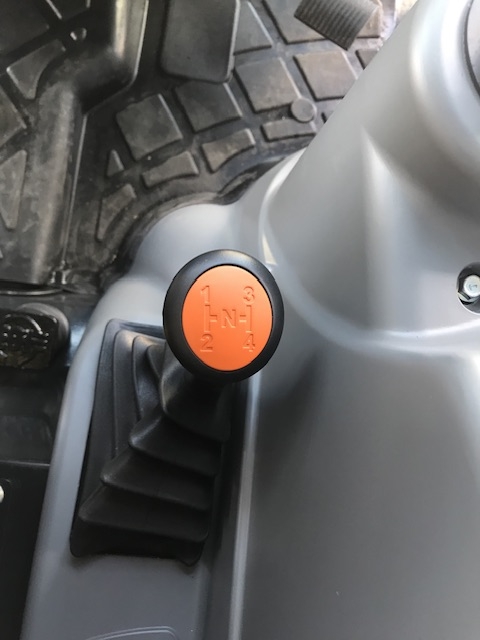

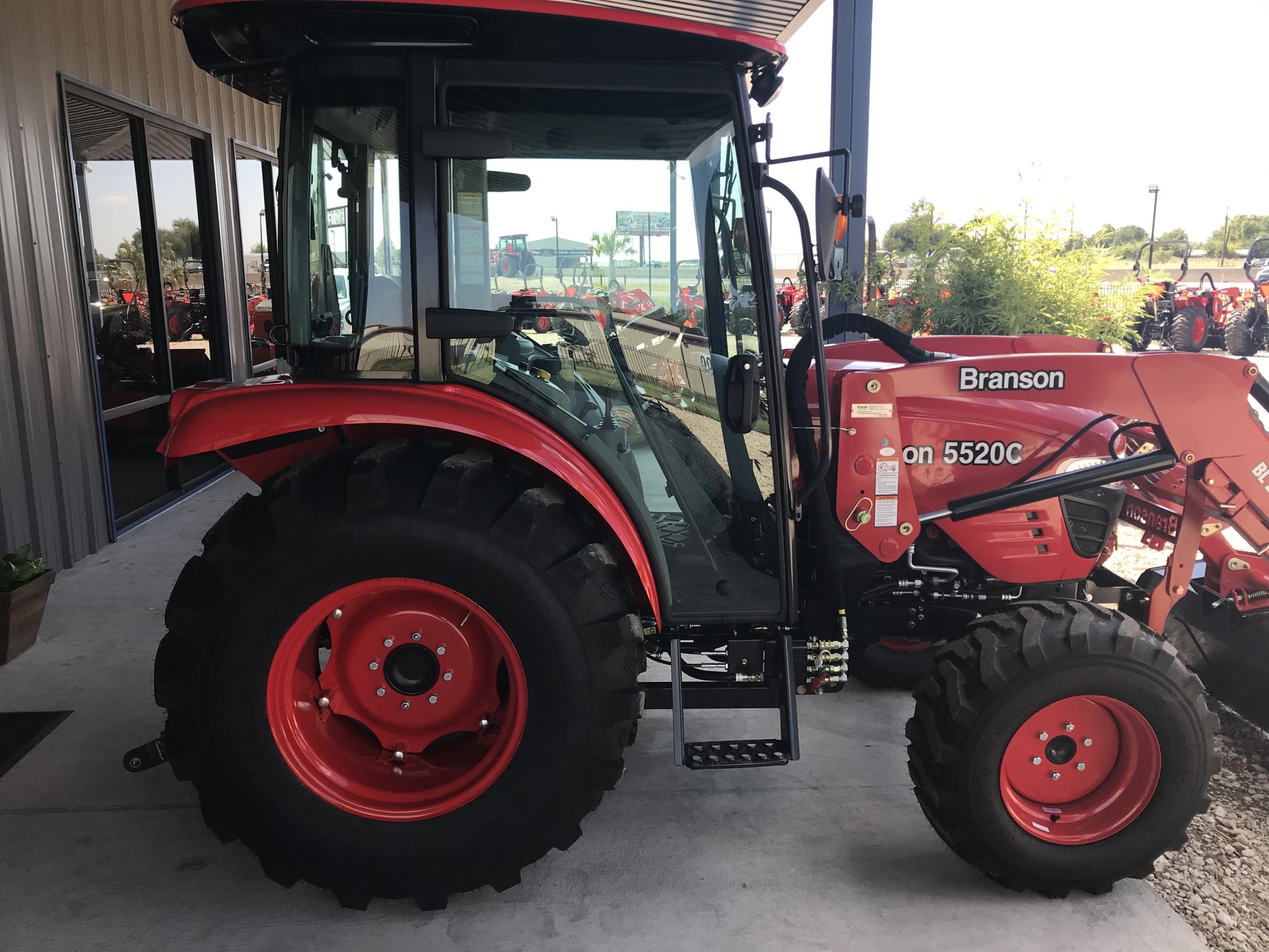

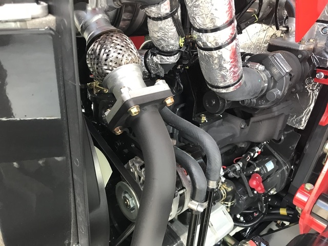

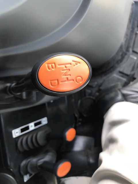

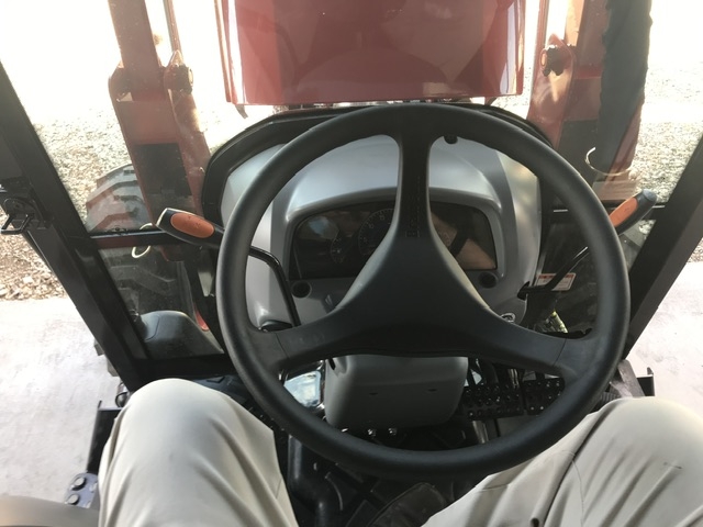

I checked out the new 20 series when they came out with the 4 range H pattern. It is a very nicely laid out cab. I fit in it well. A good bit more roomy than my 4815 Cab. The one I tested was the 5520. The 4820 has the same engine as my tractor. Very smooth running machine. The synchronized range shifter is extremely nice. I have some photos I took that day. The dash may be different now but this one had the temp gauge. Hopefully they are back using this one. Hope this helps.

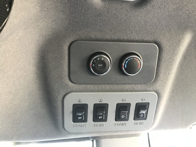

K5lwq does it have heat?​
/ T494HC vs 4820 CH #18
Thanks guys...btw, does the 4820 have the diff lock? I dont see a pedal for it.
It does have diff lock. See the 8th picture I posted. It is the pedal on the far left.
Yes it has heat as well.

The H pattern range selector is soooo smooth too. Like butter. I heard the old straight throw levers were sort of a bear at times. I’ve really enjoyed the cruise control on mine as well.
