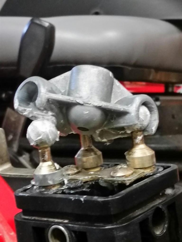

OK, here is the update, I broke the control cable going to the loader valve. I went to my dealer today and picked up a new cable ($50) and received basic info on how to replace it, the service side was closed today. I have reinstalled the cable now all I have to do is reconnect the joystick to the cable end which is a steel ball on a shaft. There are three, the center one in the picture which really is on a corner is stationary and the joystick pivots on it. The left and right ends in the picture controls the FEL and the bucket. I can get any two in their slots but not all three. I stopped today before I tried to force it and break the gray piece which is cast something. The joystick actually screws into the top of the gray piece and I don't know if it is available separately if I break it. I do know that the whole joystick control is $800 so I don't want to go there!
My question now is has anyone had to deal with this in the past? Any hints on how to get all three "balls" into the piece in the picture? I have tried many combinations of raising or lowering the cable ends, different angles etc.
