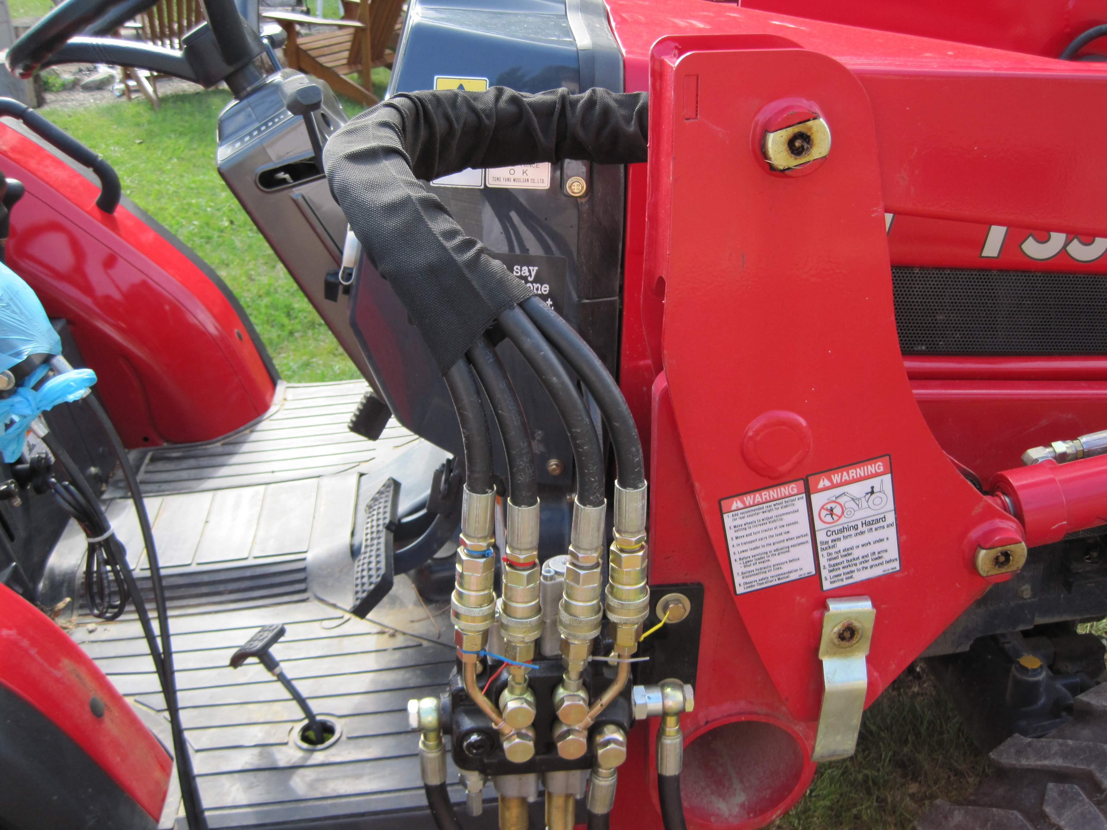

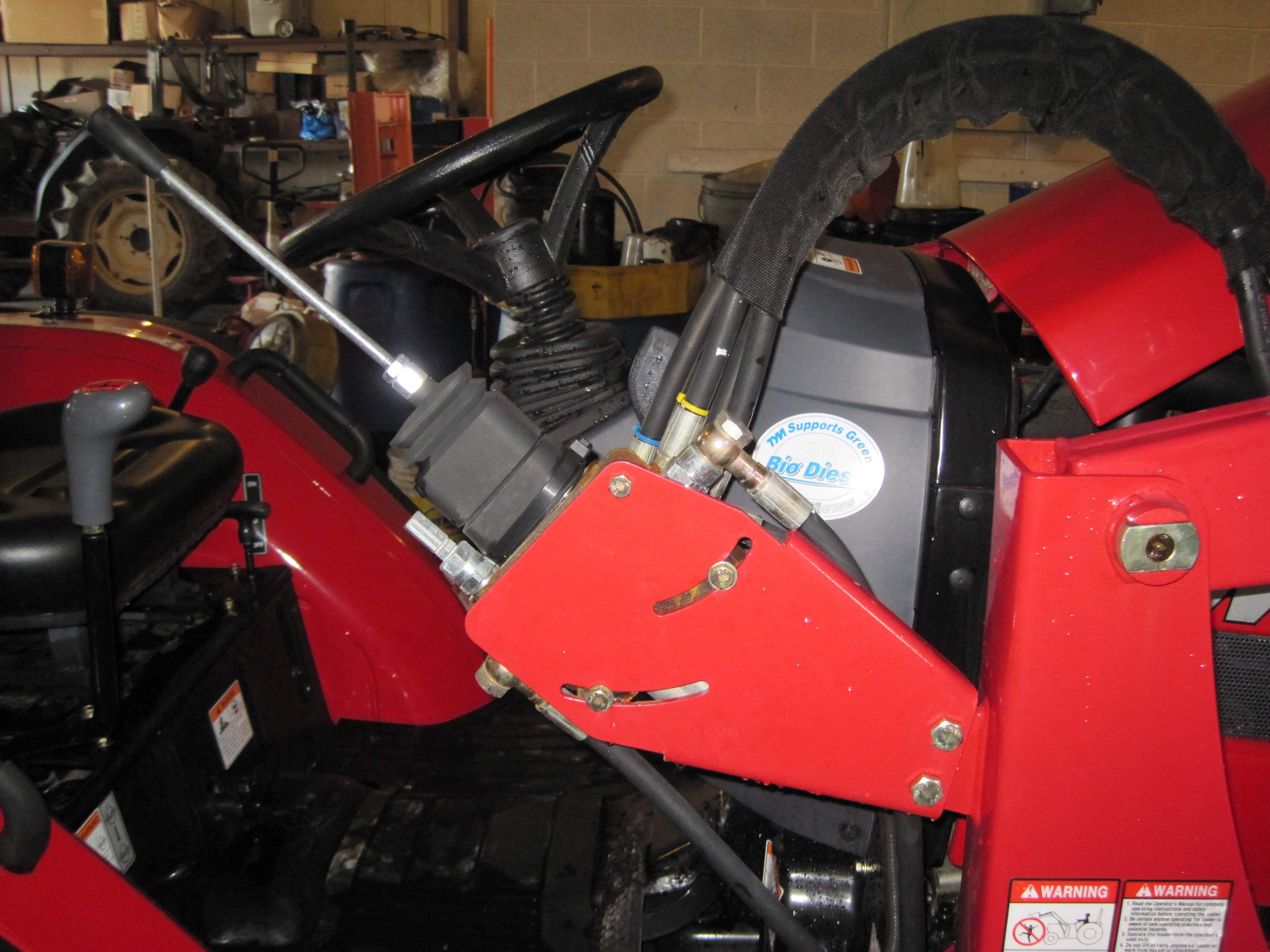

#15
First pic is what I have and second what I want or I should say what should have been there. I also posted in the Hydraulic section looking for ideas if they are not willing to upgrade to the proper set up and stick me with mine. I could fix it but it would require a little work, fabbing, and yes some money which I shouldn't have to put in mine already with 91 hours of mostly back hoe and box blading since 11/08 and stored inside also.

Saw your system and yes you do have a different set-up from the K2, but I just can't seem to see where the problem "upside-down valve" is located? I saw where you have the joystick area all covered in blue protective wrap (and cables going to the loader valve) but it sounded earlier, as if the weep-hole was located at the actual control valve? Or was it at the bottom of the joystick? Or am I confusing your problem with what Steve described as his? I couldn't find any source of a weep-hole on my set-up? That doesn't mean it isn't there though! I could have soundly missed it -- although I searched heartedly!!
I am curious as to the different set-up's you show? How is the 2d picture much different than the original except that the joystick is much closer to the loader itself? Does it eliminate the cable entirely? How woul it operate the valves w/out a cable? If'n it works -- Great!!

Greg the hole is oposite the of where the cables attach to the valve. In my first pic the holes are facing up, which is bad. In the second pic they are oposite the joystick. The joystick has a mechanism which operates the spools directly been used for many years. Most new machines are using the cables because of ergonomics, which can be good but my case the valve isn't in right position.
Look at your vavle and see if your holes(oposite cable adapters on valve) are facing downward, which they may, I haven't heard of any vavle problems with the T2 series.
