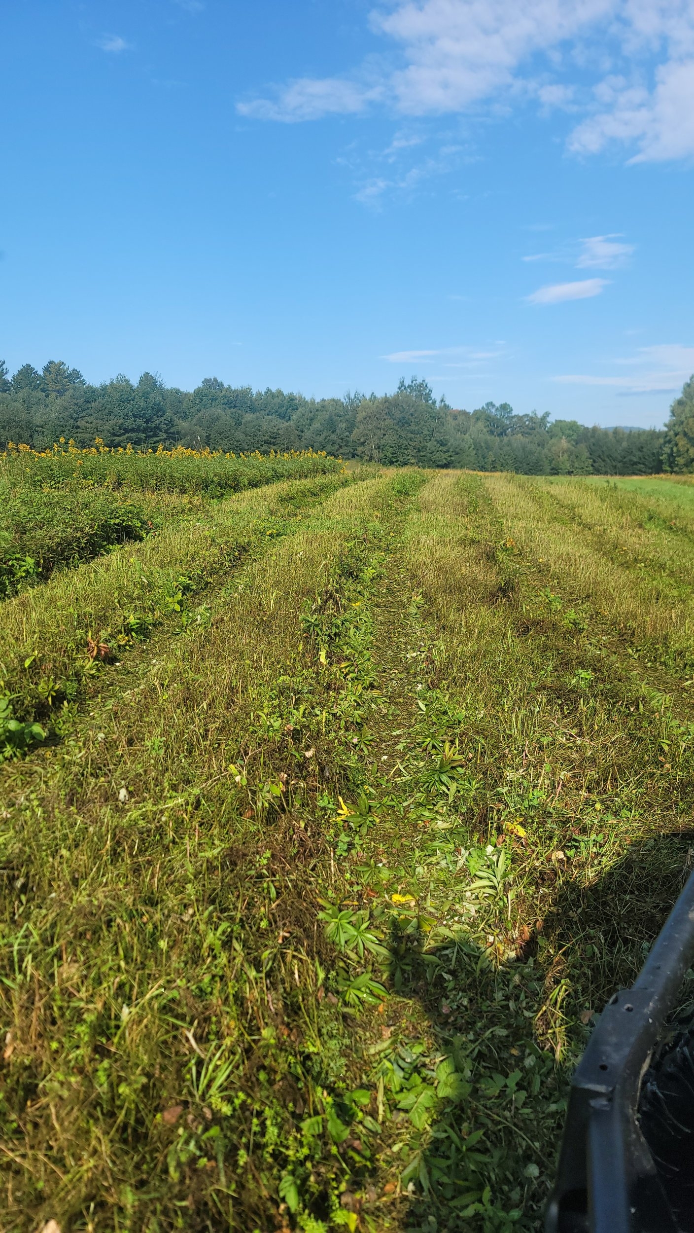

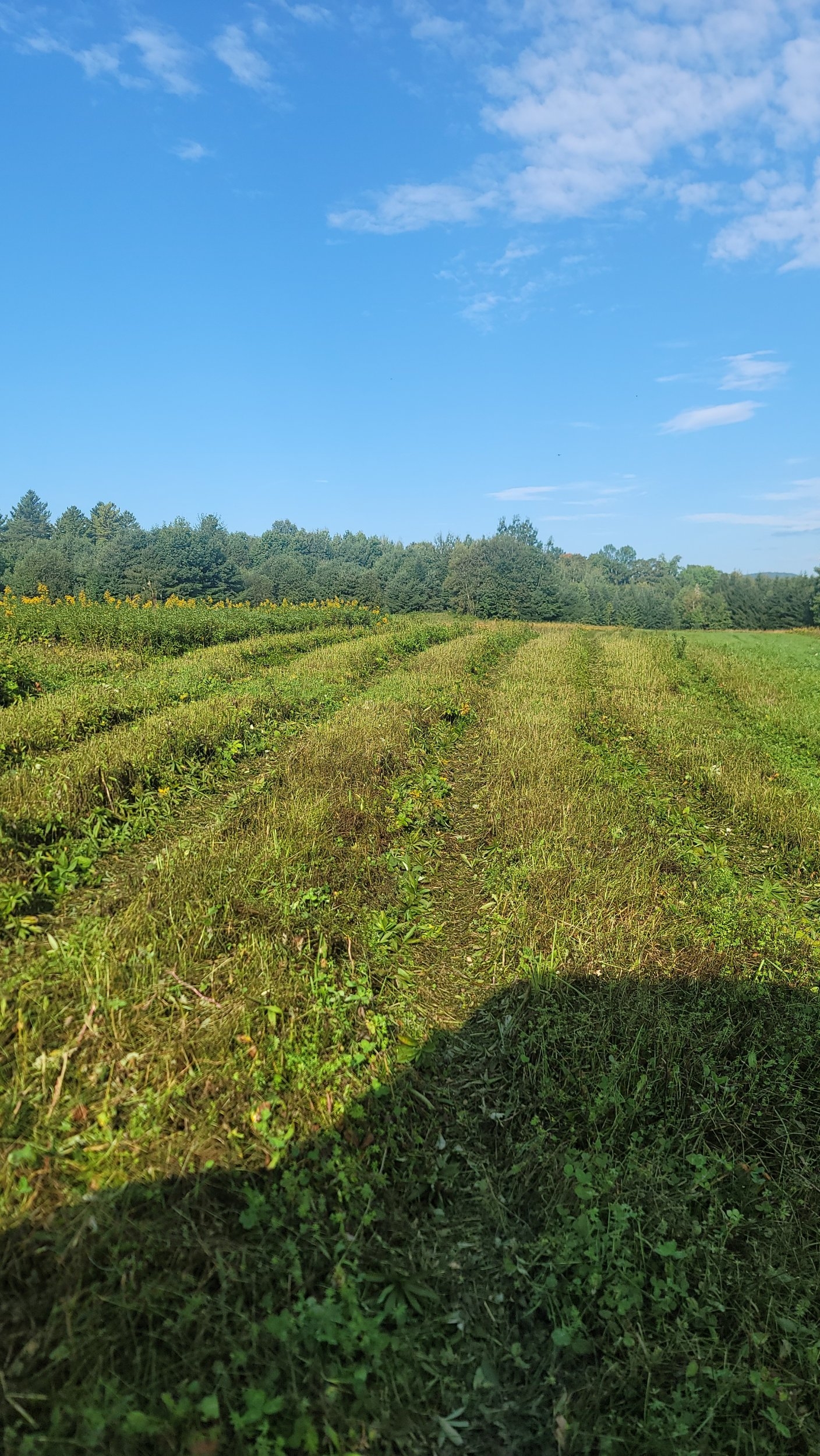

All,
We have a Swisher rough cut 52 inch with a 17 hp B&S motor.
It will cut great on the right side and leave the left side partially cut.
I have contacted Swisher and they have been very responsive but have yet to figure out why
To date we have done the following:
- New drive belt
- confirmed the belt is tight
- installed brand new blades, then installed new high lift blades
- blades swing free
- blades are installed correctly
- new spark plug
- we have tried mowing a 1 mph, 2 mph, 3 mph, 4 mph, and 5 mph - all the same
- we have tried offsetting the mower to the tow ATV - both right and left - all the same
- we have tried all the way up for elevation, front middle setting - back up all the way, front low setting back middle...
The customer service person has worked with engineering and there is no resolution
Any advice would be greatly appreciated or if there is another forum where I can seek assistance please let me know.

Honestly I'm not sure what the pictures are showing; looks like there's like 1' getting cut to the ground and very little else, though without anything else for scale it's hard to see what's what.
If there's really a left/right issue I don't think it's front/rear elevation but instead left/right height is not level - be that deck or spindle. Something really bent?
Can you clarify what we're looking for in your pics?
