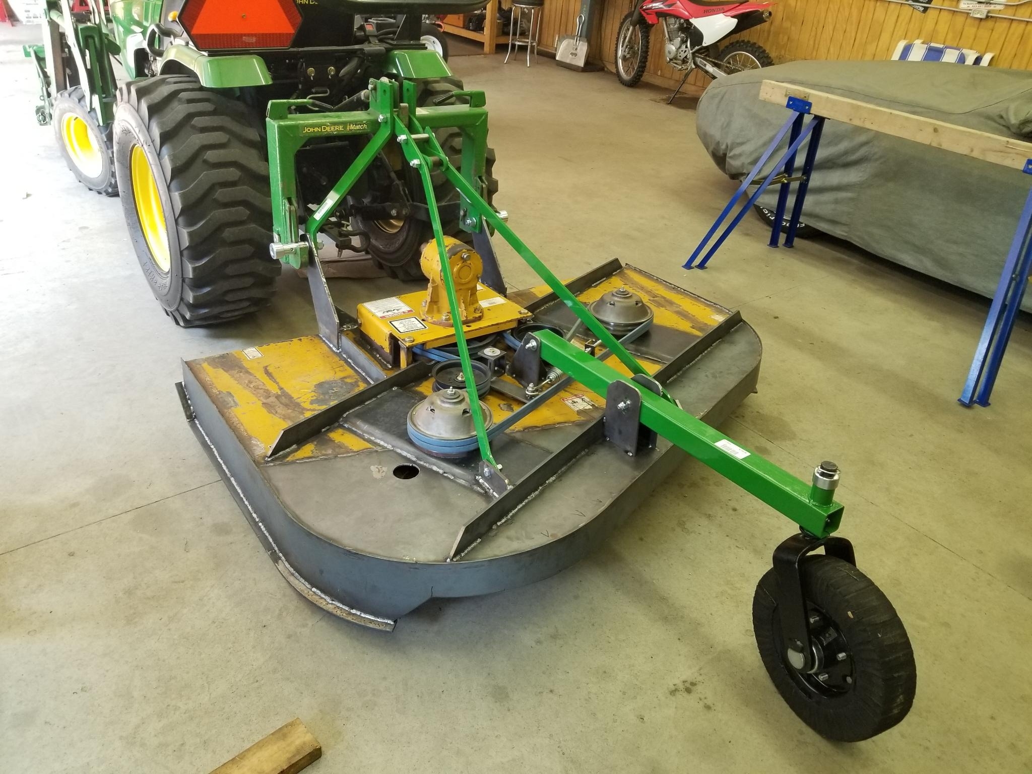

I'm a retired mower engineer. I'm sorry but your post makes me smile. I haven't visited here in some time but I think I can help you. Mowers are tough to design; they each have a "personality". The guys at Swisher know what is going on... but won't tell you that one of their 'children' is out terrorizing everyone that meets her! ;<)
From your pics, I believe what you're seeing is called "tire track". My Frontier RC2060 rotary cutter does the same thing; any mower that 'impact cuts' can do it. Let's see if any of this runs true:
  • Your mower is powered by its own engine; the blades run CW?
  • You pull it with a wide tired machine? Lawn tractor? ATV? UTV?
  • The uncut section is directly behind the tires of the pull vehicle?
Going forward, the pull unit bends the tall grass forward then mashes it down... twice (front and back wheels). The housing of the mower also bends the grass forward as it enters the cutter. Running CW, the right side of the mower is able to 'back sweep' the grass. This is a huge advantage! It's like shaving your beard against the grain. You may cut yourself with every stroke but you won't have to shave it twice! The left side of the cut is in the 'forward sweep' portion of the cut; notoriously the weakest portion of the cut. Align the 'forward sweep' of the cutter with the 'tire track' region of the power unit and you have the stuff that keeps mower engineers up at night! Belly mower designers try to shift the mower to gain advantage. Zero Turn engineers move the casters to get them out of the forward sweep (really). They also turn up the tip speeds and add high lift blades with marginal success (adding noise and power requirement). Ever wonder why lawn tractors are 20+hp now-a-days?
Is there something wrong with your mower? Probably not. Impact cutting starts at 12,000 fpm. Below that, a mower will just 'comb' the grass. I looked up your model number and didn't see tip speed in the specification. My frontier runs ~15,000 fpm and it still tire tracks. So as suggested; run your mower WOT. Always. Any rear mounted mower has this disadvantage.
"So how do I mow with this thing?" You overlap. My Frontier blades run CCW so the RH side is the weak side (forward sweep). I circle the fields going in CCW laps, starting on the outside... finishing on the inside, keeping the RH side of the mower in the previously cut path. Yup, drives me crazy too giving all that cut width away.
A dozen people may say "my mower doesn't do that!" Maybe not... in their condition. Another thing you learn in this business: grass changes bigtime in different microclimates. I cut my fields about 3x/year cutting ~20" down to 4" in southern Wisconsin. My cut would look like yours if I didn't overlap.
"Why does my neighbors mower cut good?" Mowing Rule #1: you have to compare mowers side-by-side, same grass, same height, same speed, same power unit. You said his mower is a DR... front mount??? I have designed many mowers for the European market. They mow quite different from us (much lower... 1.25" is not uncommon) and the dealers tend to tinker much more than ours. Every dealer has a 'tricked out' super mower that they'd bring out each time you were testing new equipment. When you lined mowers up side-by-side though, in the same grass, at the same speed, at the same height of cut.... not so trick.
This problem has plagued me for years. What does a retired guy do staying up at night thinking about solving the mower/tire track issue??? He builds a mower!
A guy buys a beat up King Kutter 3-point finish mower and converts it into a 6' rotary cutter with 2- CCW 3' swing blades offset so they back-sweep BOTH tire tracks!!!
"Wake up... you're dreaming again!"
